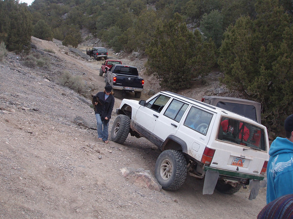

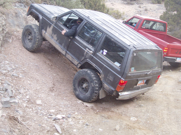

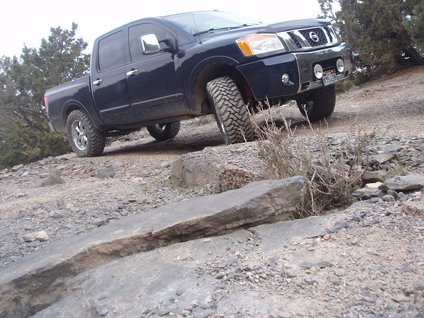

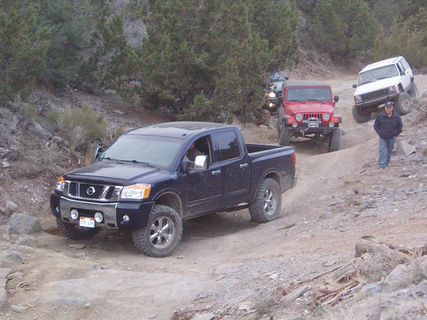

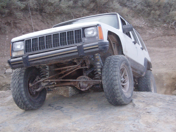

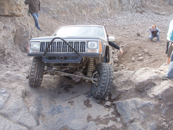

Here are a couple...

THanks for sharing the pictures, it looks like a badazz trail. Did you go thru the whole trail, how did the titan perform compare to the other vehicles?

We dropped the Titan off part way through when it got too harry. Messin up the expensive toys isn't as fun! My Titan was at home that day in the garage awaiting her saws and fender flares but we posted some pics of taking them out this last weekend on another thread... let me know if you can't find it

Like Firulice said the Titan didn't make it too far down that trail. Since starting this thread I picked up a built 2000 Cherokee Sport with a 7" long arm suspension and 35's on 15's. Got it for a great price, but haven't had it out on the trail yet though.
