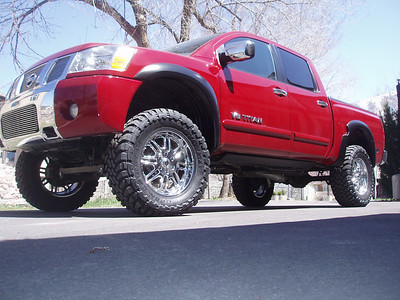

Finally got some pics that show off the SAW's (sort of). Here's the setup:
SAW c/o's (2.5" preload)
SAW piggybacks
PRG UCA's
PRG shackles (set at -1")
2.5" Deaver pack minus largest leaf
PRG offroad traction bars

so the saws don't get much higher than a leveling kit... hm, I was hoping for an inch or so on my 05 4wd w/2.5" leveler... I think I seriously need to just sack up and call Greg and pay for stuff and deal with it
also what size are the rims/tires? and what kind of offset is it? they don't stick out much it doesn't look like... if I had to guess I'd say 33x12.5x18 8.5" wide rims... or a positive offset and 18x9 or 10" max... looks nice either way
in fact, could even be 35x20... or 18" eh... I give up...

There defiantly 35'sx12.5 and i pretty sure those are 20's

Yama is right, those are 35x12.50's.
Wheels are 20x8.5, 18mm offset. They hardly stick out at all, and the stock fender flares cover what does stock out pretty well.
