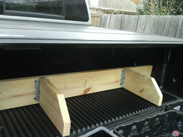

I got a 2x8x10 and cut it down to 61.25" (I have factory bedliner)
Then I used rafter joist metal ties to tie in two fwd facing 15.5" 2x8 boards:
2x10 Joist Hanger by Simpson Strong Tie - JUS210 - More Joist hangers and rafter ties at doitbest.com

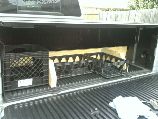

With crates:

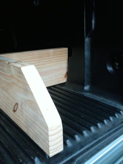

Close up with 45 cut on end/belt sanded smooth:

Didnt take pics, but since my inlaws were in town, my father in law wanted one for his 2005 F150........I made him one and bed lined that same day since he doesn't have a bed cover......Also went to the corner store and picked up some free milk crates...lol...
We used my bedliner cans i had, so ill be picking me up a few more cans and doing mine with bedliner pretty soon...

love this idea will be hooking myself up this weekend. what are you using to hold it in place
No need to, it snugs up just fine, has decent weight to it, and the fwd facing 15.5 inch boards line it up straight, etc....
I would like to note, that 15.5 inch still left about an 1inch away from the tailgate...i didnt want it hitting or getting that close, so i just measured approx and went from there..... of course do your own measuring and fab as you please.

good idea. also if you replace the joist supports with a set of hinges, you could collapse the whole thing down quickly into a smaller package when you needed the whole bed for something else. and you could also countersink/glue some stronger magnets into end of the 15.5", where it touches the 2x8, and directly across into the 2x8 to keep the 15.5" boards locked in place when the boards are fully extended. just a thought?

What's the purpose of the 45° cuts on the short boards?

not a bad idea at all.....good thinking....
I did that just so if im ever climbing up there, etc i wont corner myself......im getting old...:confused:
