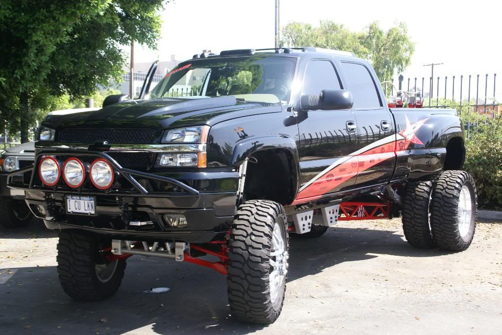

I just wanted to post some pics of a truck meet we went to today
