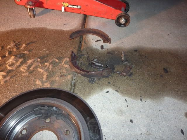

Noticed a 'clunk' every so often, but the dealership diagnosed it (on 11/30) as the drive shaft. Said I should schedule for a replacement, but life got in the way and I didn't get around to it.
Fast forward to Jan 12th when I noticed a grinding noise from the passenger rear end. After removing the wheel/caliper/and rotor, all of the parking brake 'stuff' fell into the pile you see here.
Set up an appt. with the dealer and they discovered the rear axle seals were leaking and the differential was making noise & 'burnt.' Bad news - I needed a new axle assembly. Good news - it's covered under my 6 year/100,000 mile extended warranty minus a $50 deductible. (truck has 73k miles)
The extended warranty didn't cover the new rotors I needed, so that was an additional $186.36. But for $250 bucks - I got a brand new rear axle & rotors installed. I was :clap: that day.
