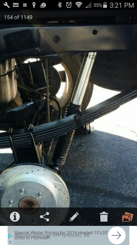

So I just came across these on Amazon and thought id share because it looks like a great deal, as well as ask a question.
Heavy Metal Lift Kits Nissan Titan 2.0" Rear Add-a-Leafs + Shims High-Grade HEAVY STEEL 2004 - 2015 Titan Lift Kit https://www.amazon.com/dp/B00L3OJC06/ref=cm_sw_r_cp_apa_ZFyDybMYJY2XT
So I guess the question is, should I replace shocks with ones that are for a lifted rear end?
If so, I can only seem to find shocks for 4" lifts. Whats out there for 2? Do you need anything else, like will this change the angle of the rear driveshaft too much?
What do you guys think?

The Bilstein 5125's are 0-2" or 2-4" if you have 4WD. The guys at TAP auto can take care of you.
Pretty good price if you're looking for a budget setup. I ended going with Deaver C30's.

mine settled close to an inch after a few months.. shouldnt need anything for driveshaft, unless you start getting vibration or slip after install.
171 Posts
If you are 2wd, the 4wd shocks are 2" longer. but might as well get the right Bills.
AAL when I had in my silverado made the rearend bouncy when unloaded. I find the titan is already pretty bouncy unmodified, when decelerating.

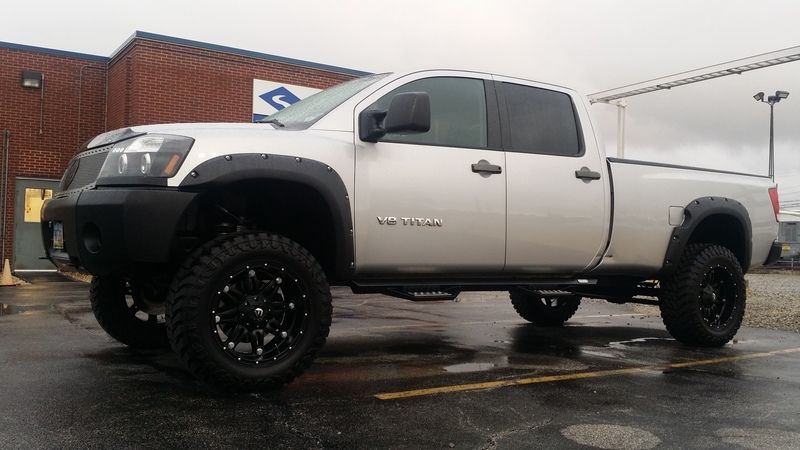

Combined with the Bilstein 5125's gave the Titan a well balanced suspension
4" block. Came with the 6.5" spindle lift. But I didn't want the Cali Rake look so that's why I got the Deaver's to level the truck.
