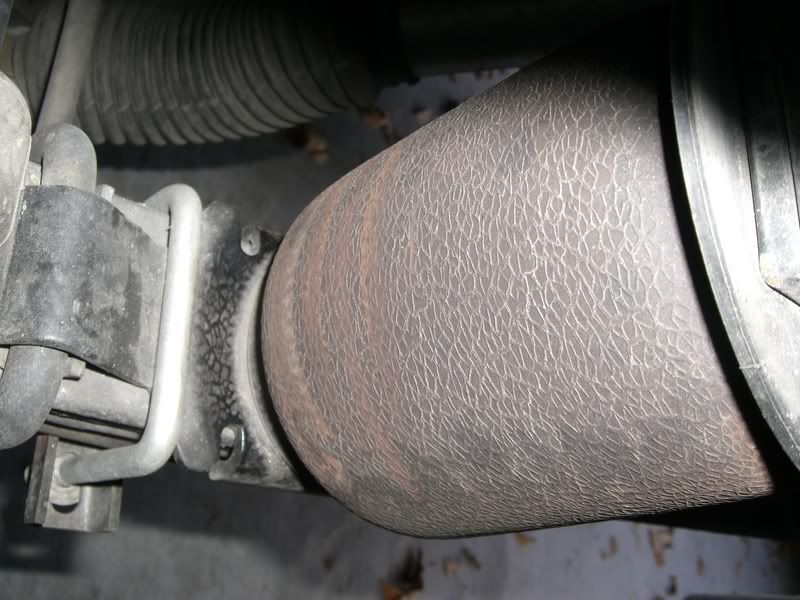

I get in my truck a few days ago and my compressor starts to pump when I turn the key on. Humm... first clue. So I continue on and the pump would come on every now and then... A LEAK .... CRAP!
I went to investigate the problem I found that 1 bag was leaking air because of a cut in the side of the bag. I looked at the passenger’s side as well and found cuts on both sides of that bag as well but not leaking yet. I then looked for the source of the problem (what created the cut) and noticed that the bracket has a sharp edge where the bag touches when deflated to 10PSI.
