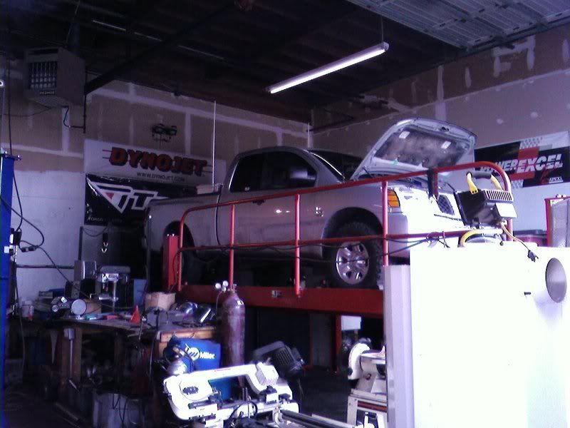

Paid a visit to Intec Racing up here in Kent, WA for a Nissan/Infiniti Dyno Day (http://www.titantalk.com/forums/pacific-northwest-forum/86438-dyno-osiris-day-bbq-intec-racing.html) and got a killer deal on Uprev's Osiris with some quality time on the dyno. Intec Racing is the only provider (as in, a place where you can go to buy rather than order direct from Uprev over phone/net) of Uprev products in Washington state and if you're a PNW Titan owner and are serious about getting Osiris, then I highly recommend you pay Intec a visit. I worked with Lawrence Ojas, the managing member and co-owner of Intec and he is a very experienced tuner, my Titan was his 9th and he's also tuned 2 Armadas. I sat with him in my Titan for about an hour and a half on the dyno and watched and listened as he worked on the fuel and timing maps, making it richer where it needs it, leaning it out where it doesn't and I tell you, it was like watching an artist work. Some of the things I learned was that bolt-on mods like a CAI and exhaust tend to lean out the fuel delivery. The mass-air flow sensor measures air velocity and when you increase the size to the intake pipes or exhaust pipes, the sensors read a slower airspeed despite the engine taking a bigger gulp of air. The ECU then leans out the fuel delivery, thinking that there is less air coming in. Anyways, definitely a learning experience!
The final dyno run that is pictured below unfortunately does not reflect the final tune that was flashed to the ECU since we were running overtime and the line behind me to make dyno pulls was starting to back up.
The run in blue is the performance run with the stock maps in red. Take note that the "stock" run also reflects my CAI/Exhaust. After smoothing out the fuel and timing maps and making what we thought was going to be the last run, he noted that it could be a little richer at the top as there was a slight power loss. What the plot also doesn't show are the power and torque gains below 4000 rpm as we were having trouble keeping it from downshifting below that. When it was all said and done, I got the 3 map treatment (the drawback of buying an 04:() of a stock map, 92 tune and an economy tune. After driving around and doing some WOT runs from a dead stop, the tune really opens up the Titan below 40, I didn't realize how much the factory map chokes the motor below 40. So far, I am quite happy with the results and I'll have to head back there when they have another dyno day to get final numbers. Anyhow, here's some more pics and a couple vids from my time there, sorry about the cellphone camera quality, still kicking myself for forgetting my camera!:bangit:

you're putting down a ton of torque!!! 340-357ft-lbs that's quite a bit. The part that's surprising is that you're only putting down 270-275 hp??
64 Posts
I have the 04 Titan w the Endurance engine. Specs claim it has (stock from factory) 307hp and 397 ft/lbs trq.
Your numbers seem to be on the low end of the company' claim. Should I rethink my assumptions about my truck's hp and trq? I did the airbox mod, borla muffler, 2 degree timing advance.

Not quite, the 2004 Endurance in the Titans is factory rated at 305 hp and 379 ft*lbs, and yes, that is at the crankshaft and not the wheels like firelife said. Manufacturers NEVER state horsepower at the wheels since they cannot guarantee those numbers for each vehicle (not all Titans are created equal, some have different tire sizes and or final drive gear ratios, both of which affect dyno numbers, also, drive train losses due to friction will vary from vehicle to vehicle, even if they are configured exactly the same.) What many people (me included) don't do is to do some dyno pulls BEFORE putting on any performance-enhancing mods. That gives you a baseline to which you can compare to as you add each mod. That way you'll know exactly how much you gain with each additional mod while also telling you how much YOUR particular truck is losing between the crank and the wheels due to friction (which can be anywhere between a 15-25% loss). At any rate, don't assume anything about your power numbers, take your Titan to a local tuning garage, do a few dyno pulls, and know exactly what your power and torque outputs are.
