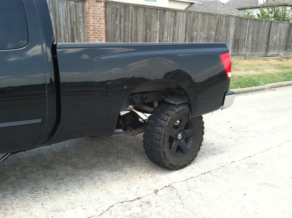

Hey guys i need some help as you can tell by the picture i have a problem. I need to know what kinda of bolt i need to buy! Its the bolt that fit though all the leaf springs. the old one broke. Also the drive shaft slipped out, can i just put it back in? or is it broken? THe only thing that looks broken is that bolt. The axle is still on the leaf it just slid back. Any thing Else i should take a look at before I Decide to re do this? I can take some pictures if needed. Just let me know of what and where. THanks for all the help before hand guys! This is my work truck and its needed every weekend.

In all seriousness, WHAT THE F*** did you do? Under no circumstance is this normal and in fact I've never heard of this happening..as for the driveshaft take a picture around the pumpkin and see if there's any structural damage to the driveshaft itself, u joints, etc.
As for that bolt, may have to dealer that one, or find a bolt with a similar diameter and ground the top hex own to a circle in order to fit in under the bumpstop...certainly an interesting one here my friend...

Take more pics, not sure if you are talking about U-bolts or bolt through forward spring eye. Also not sure of year of your truck. The slip yoke just pulls out, you can put it back if it is not messed up. If necessary, you could mark position of drive shaft flange at pumpkin so you can bolt it back in same orientation, unbolt, reinstall driveshaft after getting rear axle housing re-installed.

If you have broken U-bolt(s), you would need aftermarket U-bolts long enough for your 3" block, not stock U-bolts.

ill get some more picturtes in the light, but the ubolts are fine. its the one bolt that go in between all the leafs that under the bumpstop. THanks guys

There isnt a story here i was just driving and coming to a stop ( 20mph - 30 mph) and well the truck make a weird noise and shook, so i hit the breaks, thats about it. After thinking about it for a while i think my u-bolts are just loose, everything else looks okay ( besides the dent i now have near the back fender well). the shocks are still on and straight no damage and the nitto grapper looks untouched. i think i just have to push it back and tight it down. ( still buying a new leaf spring bolt. the top of it was just scraped off) I'll get pictures later, im at work and then I have class till 10 so its going to have to wait till early Wednesday morning.

The U bolts are what holds the Axle to the Springs. Your U Bolts are the failure. They were likely stripped or too loose when installed.
The Bolt through the Spring Pack did not cause this, it was a victim. It is mainly for Alignment of pieces, it is not strong enough to hold much together. It centers the Springs and Axle Fore and Aft. If it broke, you would likely not know, as long as the U Bolts are holding as they should.
I just installed 4 U Bolts on mine today. I had them made at a Spring Shop for about $35-40 for the wholes set. We have 2-1/2" Wide Springs, and what I got was 9/16" - 18 Fine Threads with new Nuts and Thick Structural Flat Washers. I had to use a grinder to cut the old U Bolts off, as my threads were stripped, and the Nuts would not back off.
