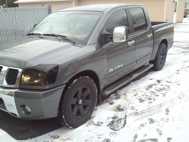

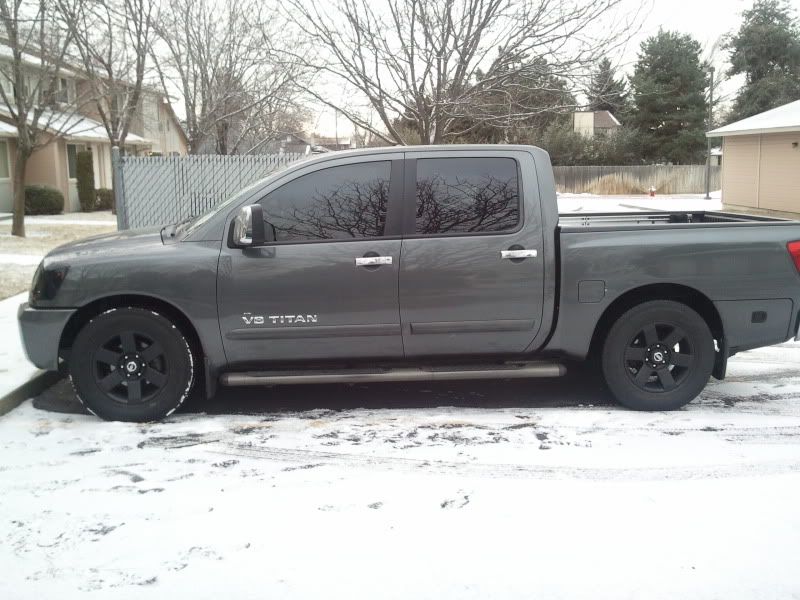

Finally picked up some ah this Bedliner stuf and I must say I now see why all u guys are addicted to this thing....I bedlined my wheels and they are sweet :redblob" btw its 19 degrees outside in Idaho when i did this..NOT IDEAL for this kind of project at all lemme tell ya lol FML
---> How My T looked on the dealers lot right b4 i bought it

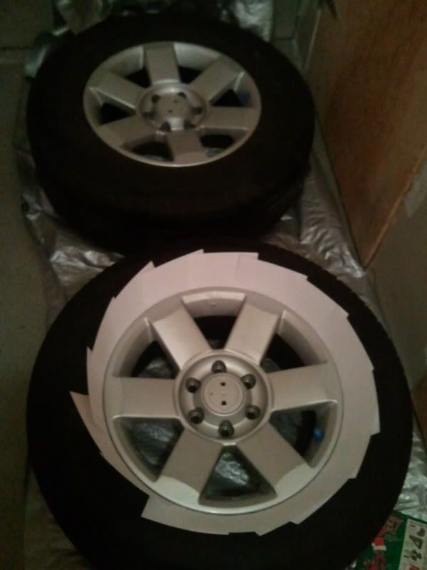

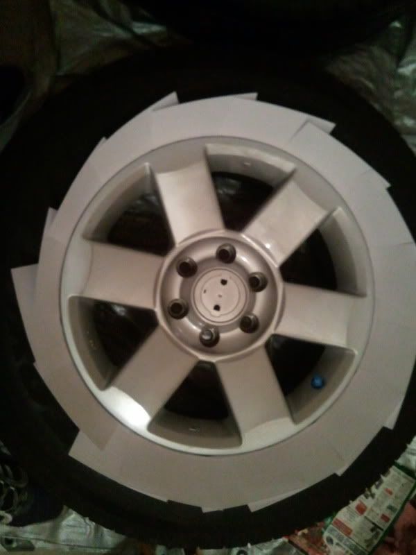

----> Yea im lazy, instead of taping off the wheel i jus got some Note cards i had Laying arnd and slotted them in one behind the other so they support themselves.

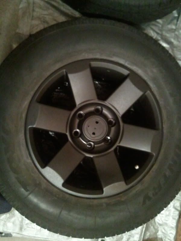

------> 2x wheels @ a time/// Washed with soap and water/// Sand paper//// Clean with acetone//// Hit with coat of Primer (Rustoleum Auto Primer)/// Hit with light coat of Bedliner////waited 20 mins/// 4 coats of bedliner 20-30 mins in between coats////let dry for cpl hrs

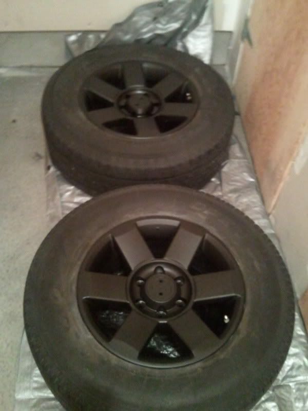

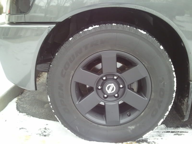

------> and the Finished Product.....:redblob" ......"idhitit2:.......:redblob"......:eyebrow:
Now to Bedline that Ugly *** chrome Bumper but it is Too cold right now.....lol

came out sweet. looks like a whole new rig!

Looks good.. watch your mud gaurd on that curb. Lol.

Hahahaha not to wory its got abt a good 6-7 inches or so to spare it only looks that close cuz of the angle of the pic...lol
