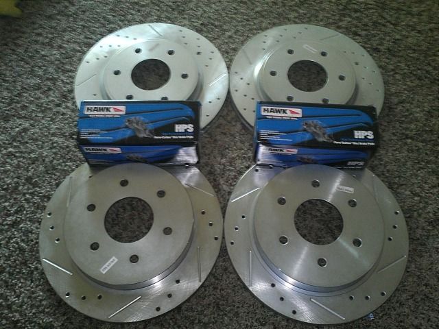

Well i dropped the $$$ on the pads then decided to get some rotors cause of vibrations and pulsing... i was looking at the ones from Frozen Rotors but didn't want to or have the funds to pay $160 each. Saw these on eBay for $160 for all 4 so i thought i'd give you guys a review.
I'm very hard on my truck and tend to kill brakes (not from over use but proper braking into corners while pushing the limits). They come with a 1 year warranty so lets see if i can get them to warp :coolsmile

ok got them installed and broken in today :banana: the front install was simple, just 2 big bolts that were the same size as the lugs to pull the caliper off and then the pads slid right out. Found out that all the vent holes were completely packed with mud though! The front pads were still good so i'm still sitting on the Hawks till they wear out. The back was a little weird, i though i had taken it apart before but i guess i hadn't. Instead of 2 big bolts you pull out 2 smaller ones and then have to press a clip down to rotate the caliper out. The back pads were shot so they got replaced. So far no vibrations and no squeaks so i'm happy! The rotors look broke in good too can't see any hot spots in them.

I'm thinking that mud was a huge part of the prior judder issue... Looks good Daryl...
