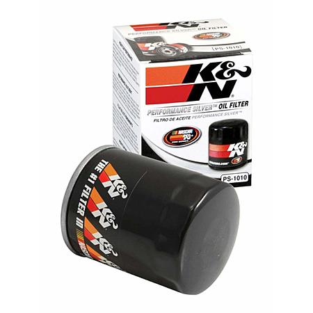

If you guys want to buy your own oil filter and oil, Amazon has a good deal on K&N oil filters.
I figure at $3.00, if it's an inferior filter, I can change it out a bit more often, as it's half the price of other filters.
#42 ·
Cheap sometimes means less filtration… bigger holes in the material… get a good filter and change it when needed…
Mobil1 filters are good but pricey, I use WIX XP filters kinda im the middle price range.
