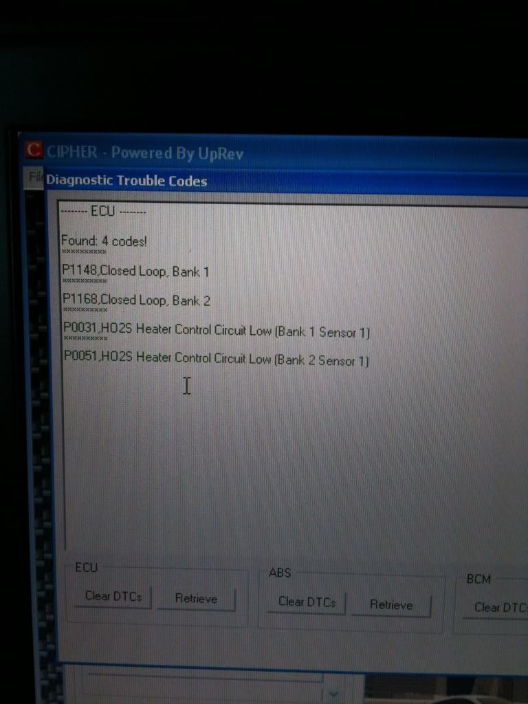

I now have Thorley's, Berks, and my second Uprev Etune installed.
The last picture is of the codes that I am getting. I have cleared them a few times and it comes back after a second or two. Not sure what they mean.

Look's like the front 02 sensors are dead on both sides.
Did you extend the wiring for them when you installed the DT's?

Make sure the exhaust shop didn't butcher up the O2 sensors and plugged everything back in properly. I'm pretty sure the codes indicate some kind of low voltage reading from the O2 sensors. I bet they forgot to plug them back in or stretched the harness too much when reinstalling them and damaged them. The O2 wiring could also be too close to the exhaust and melted causing the low voltage and triggering codes...
If you aren't already, make sure to "clear learned fuel settings" before you load the new tune and or run data logs... it's a good practice anytime you load a new tune or data log to help prevent CEL's.

^^^ Yup, both front O2 sensors aren't getting juice... Either they are unplugged or the wires got pulled and lost connectivity... Last thing is they are done for and you need new ones... If the installer's didn't unclip the OEM engine harness to allow the extended distance to the DT collector, then you could have a disconnected wire anywhere in the harness... Hope you find the problem and it's just not connected...
896 Posts
Found it. Blown O2 heater fuse. I just hope it was shorted somewhere during the install, and not a wiring problem I'll have to track down. But, so far so good.

Thanks for the help everyone. Especially Gary. I now have 300+ miles with no codes and no issues. I am very pleased with how it turned out, performance and sound. The truck runs like a beast.
