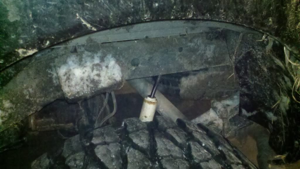

Slid into a ditch on an icy gravel road early one morning, the ditch was deep, this drivers side rear tire ended up in a 2ft deep creek while the rest of the truck was out. Shock appears to be fully extended and bent, this shock was due for replacement anyhow, it was squeaking and sagging. But any idea what could have caused it to bend like this? It is a procomp stage one lift. There was some other damage to the body, the insurance adjuster didnt think there would be any frame damage. but the left side of my box is pushed up because this shock is stuck.

There must be some sideways slop in the shaft at full extension, then it got bent on attempted compression. I would also check the axle shafts to make sure they are not bent.

For what it is worth, I drove the truck out of the ditch like this, and drove it 5mi to the shop i was having work on it, it drove fine without any noises (except a blown front strut) and the fact that the shock would not compress, which obviously made a rough ride.
