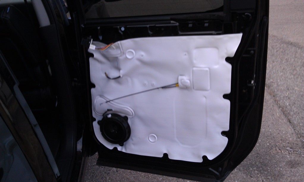

I ordered the Infinity Kappas 693.9i 6x9 and 63.9i 6.5...and I also purchased the Infinity Kappa 10.9T 1" tweeters, and they were delivered this past Thursday.

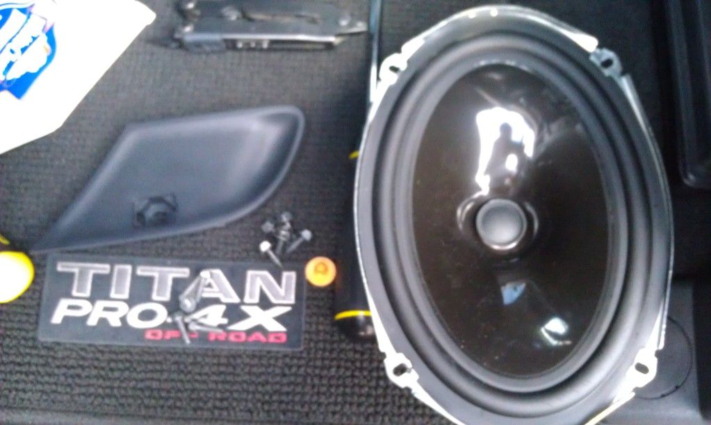

Taking off the door panels was super easy, I have had issues with door panels in the past so this was my biggest fear of the installation.

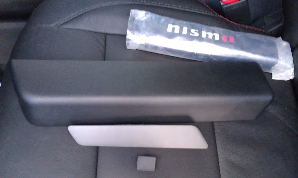

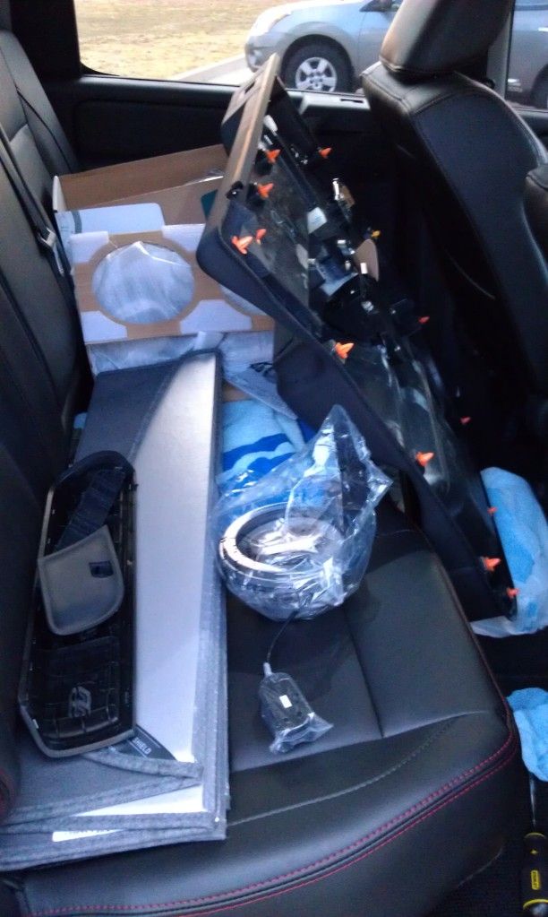

Once the handle cap, arm rest piece and door handle finisher are removed, there are 5 screws. Then the door panel can be pulled off. There were orange panel plugs holding the panel secure to the door.
There are a few things to disconnect before the panel can be completely removed and set aside: door lock/unlock cable, door handle cable, seat memory plug on driver-side only, window/door lock/mirror adj plug, tweeter speaker connector on rear doors only. Then your set.

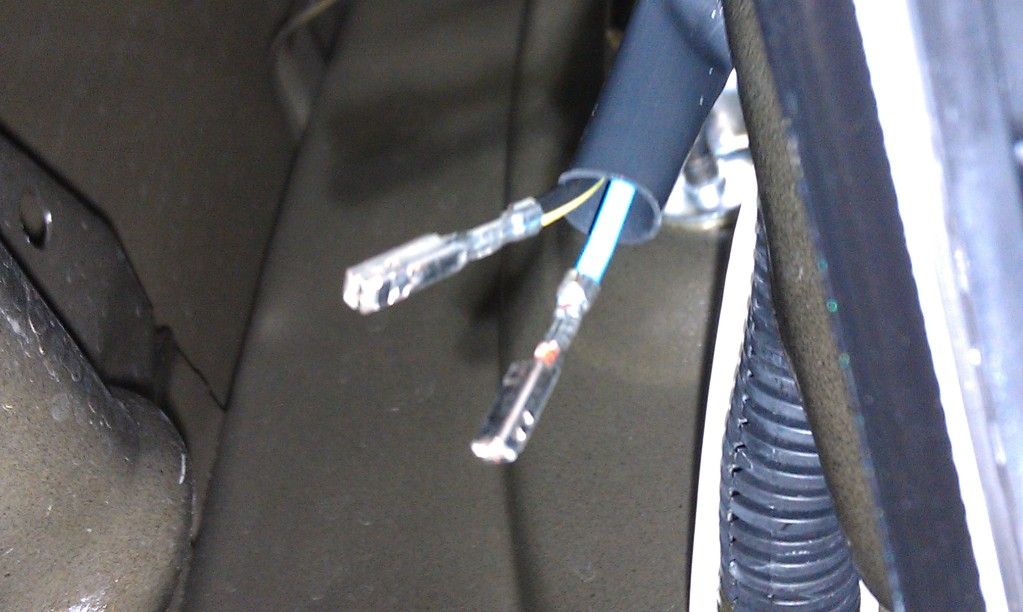

The 6x9s fit like a glove in the front doors, no modifications needed. They have the crossovers hard wired into the speaker so I simply removed the OEM connector on the door speaker wire and connected the individual wires to the crossover. I used 3M double sided tape to secure the crossover to the inside of the doors. All windows were checked repeatedly in full down/up position to check for clearances.

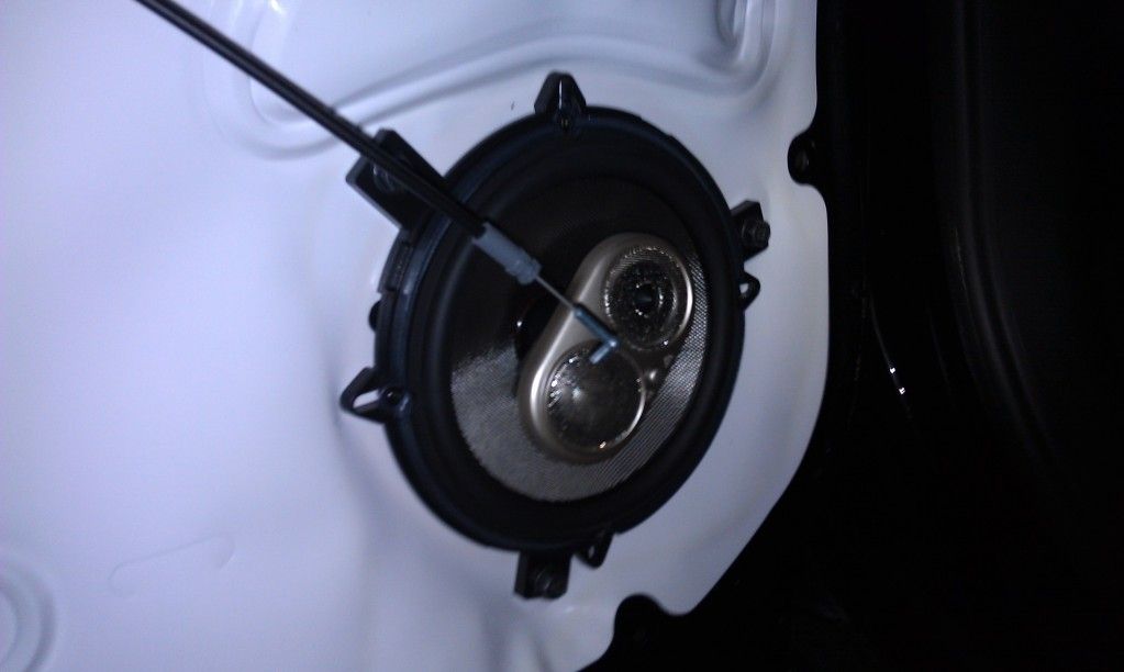

The 6.5s for the rear doors fit the opening fine and cleared the window in the full down position. There was a minor obstacle that I had to overcome, the 2 supplied door adapters did not line up with the three holes properly. However 2 of the 3 did, so to overcome this speed bump I simply used one of the 5 door sheet metal screws to tap a new hole. Problem solved...Then I simply used 4 supplied sheet metal screws and tapped 4 new holes to keep the speaker super tight and secure to the adapter and door. I did the same with the crossovers here too, just 3M'd them to the inside of the door.
One thing to note: The original configuration of the speaker wire for the rear doors is mounted outside of the door instead of inside like the front doors. So I looped it back thru a small hole on top of the speaker opening to the inside of the door and then connected the crossover. Again I checked window clearance full down and they clear fine.
The tweeters were mounted using supplied adapters and I used the OEM plugs from the stock speakers to hold the new tweeters in place. I wasnt able to re-install the OEM speaker grills because there is a little black cone piece protruding from the center of the tweeter. The only way That I can see re-installing the speaker grills is to dremel out a hole in the middle of the grill to allow the cone to protrude thru. I will test that theory next week. I actually broke the speaker grill fasteners when I removed them initially. They are 5 bucks a piece thru the dealership so Ill pick up some new ones sometime next week. Ill update with tweeter pics tomorrow. It was dark by the time I finished them.
All in all I have to say these were an improvement over the stock Nissan Rockford Fosgate speakers. I especially like that I have more tight mid bass as well as substantially improved treble output. CDs make it sound like a whole new system! XM Radio sounds better than before as well.
Here are a few pics to go along with some of the things to note above:
