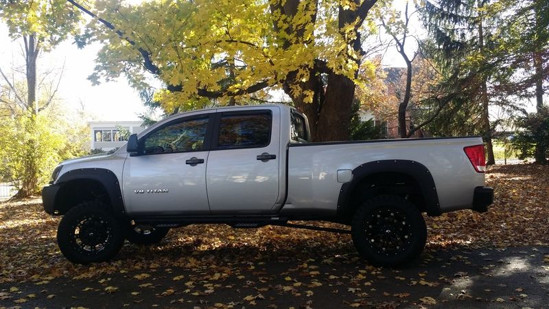

When I did my lift as you can see from my sig... I had the same problem as you're in. Because I didn't want the rake look... Here's what it looked like for example:
I forgot what the measurements were but it wasn't level. I than went with the PRG Deaver C-30's to give me 2.5" of lift.

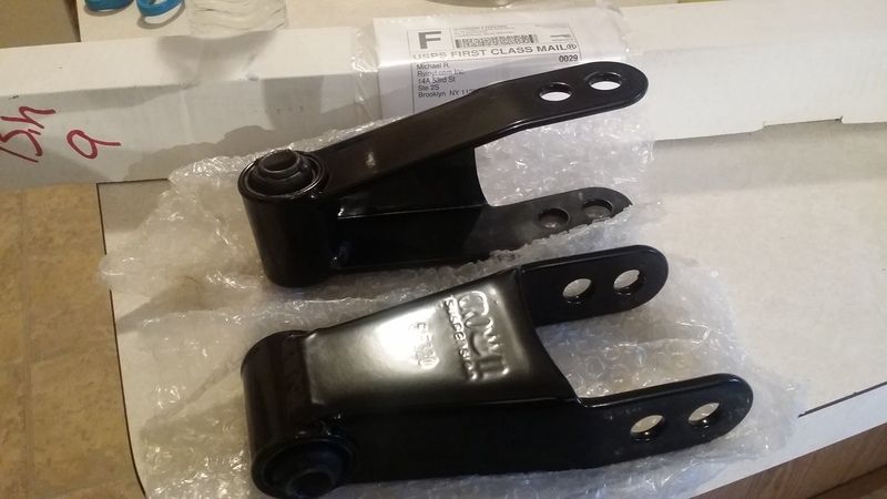

Well after the install the back end sat a little too high. Probably about an inch from being level. So I went and ordered Crown Suspension adjustable shackles.
now it sits level
Now keep in mind if you raise the rear more I'm pretty positive those 5100's will need to replaced with the 5125's

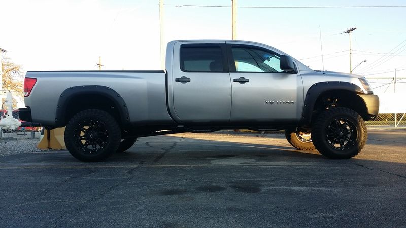

Here's the photo. Looks and rides great. I think it looks pretty level myself compared to the original photo. Time for some 35x12.50s

Is this with the 4" block installed?

Haven't even driven quite 10 miles yet with it all installed..so no, no issues with the drive shaft so far. I'm sure there's some wrap and I do plan to get traction bars down the road to fix that. I do have a PRG driveshaft spacer installed to help with the geometry a bit.
