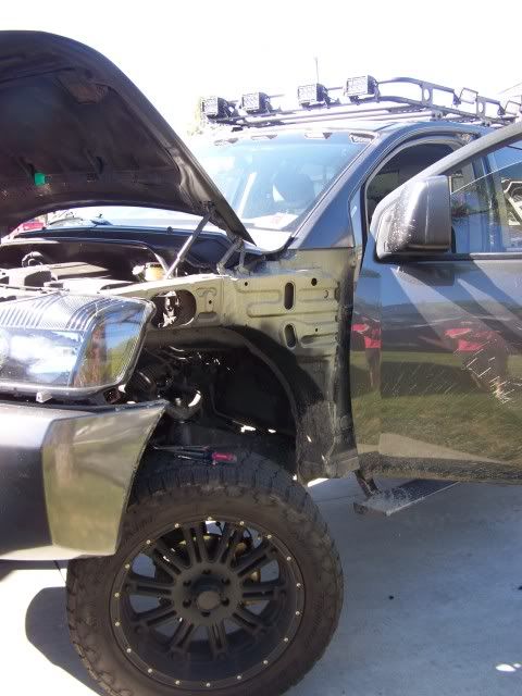

There's a total of 6 points where an OEM fender attaches to the body via 10mm screws. one up front beneath the headlight (also a hole with a grommet where the trim piece under the headlight goes) 2 bolts on top, one screw on the top side, one about a foot and a half below that you can access from the inside when the door is fully open, and finally the one on the bottom. I'll take pics and highlight them to make it easier to get...The piece below the headlight can be removed when the light is mounted but I highly recommend removing the light completely then sliding it out...or slide it out when it's mounted, choice is yours:bangit:\OK, can you be slightly more detailed for those of us that have no clue. Quick glimpse of the fenders showed me there is a phillips/10mm screw that is at the top of the door that you get from the side, there is one at the bottom that you get from between the driver door and fender, then there are 2 covered by the hood and then the hood prop looks mounted also. What else is there? How does the piece below the headlight come off, etc...?
What is funny is that I am not worried about the fender stretching. It would be nice if someone would say if they lengthened the rods that hold the bottom and if they showed where they cut.
If no one tells me, I will be doing a report on what I did and how.
