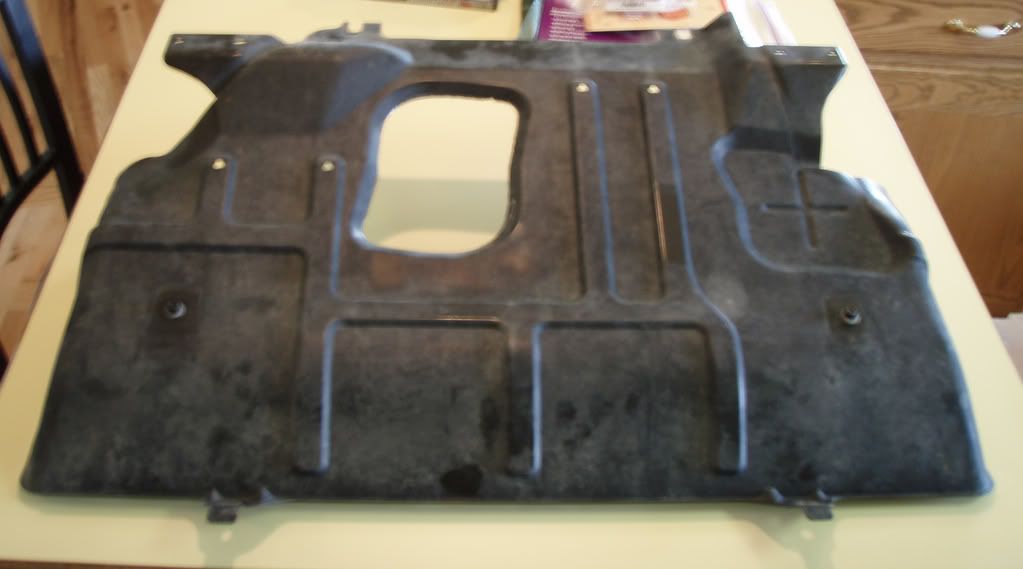

I would say lucky you......but i think i would rather have mine on, some pretty important stuff left in the open there. I dont think there is anyone who has been under their titan and said "damn couldnt anyone have thought about this better" while changing their oil. I have gotten pretty good at it now. I can do it pretty quick. Now the first couple of times it was a bit cumbersome.spoonman said:One of the dealers i went to forgot to put the plate back on my truck after an oil change, so i dont have to deal with it at all!! (if i only knew which dealer it was i would try to get it back!)
Yeah, it works fine, and I have fat hands. Sand the edges of the cut metal, to make sure you don't slice your wrists. I even put some black paint on the edges.carver1titan4x4 said:how big is the hole if you cut it out can you actually get your arm up in thier to take the filter out and with if a wrench if necc..
I doubt it, have you seen the oil filter we have? its right dead center below the engine unlike some other cars that have it to the side.sportbiker929 said:can't the filter be removed from the side through the wheel well?
