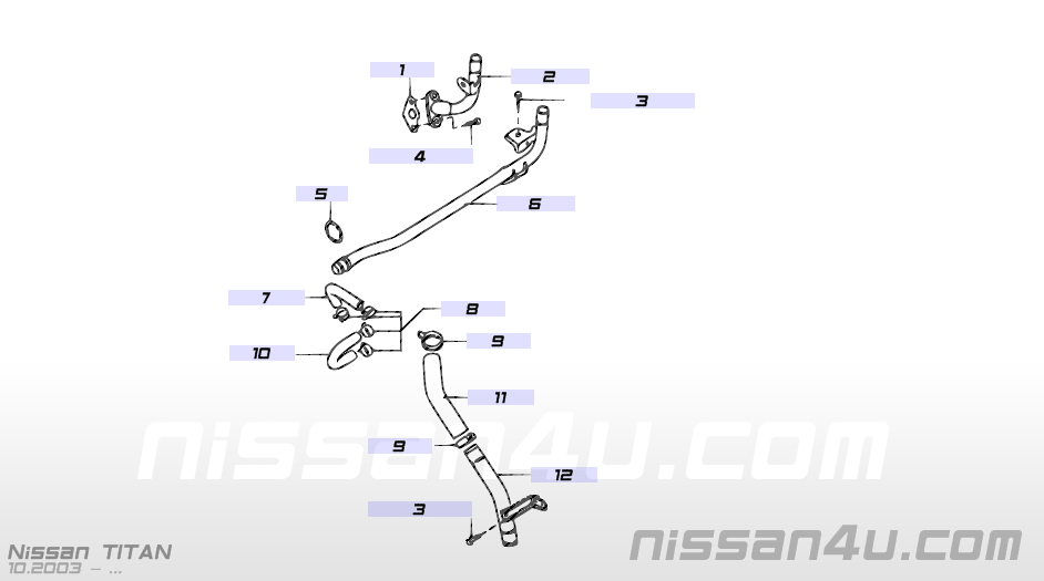

I replaced all the transmission lines and all the radiator lines this weekend. Pepboys only had the fuel line so I purchased some ... OOPS ... I was able to find the correct stuff at a different parts house. Its thicker and will hold up better to the detergents in the tyranny fluid.
BY The way ... there is a radiator line under the fan clutch that was the worst of all the hoses that I removed ... Do not for get that one.
Number 7 in this picture .. Part number: 140567S001
