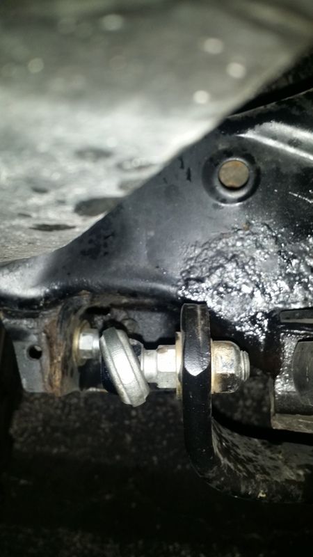

Okay brothers got some questions! I was having what I thought were binding sounds so I ended up taking the preload off my coilovers. So instead of 2.5" preload I'm down to 1" preload. Feels like before which was smooth. Now, I checked to make sure everything is still tight and torqued. Everything checks out good! When I turn I hear this metal clank which I don't know if it's the coilovers or maybe the PRG endlinks? I took a couple of pictures. The coilovers do they look like they are facing the right way? I mean you can see the top hat not facing exactly forward but angled if that makes sense? Did I install it facing the wrong way? Just checking. The PRG End links...to me I wonder by looking at how far off it is if that maybe causing my binding noise? I would think they should be perpendicular with the joint right? Please chime in guys as to what's causing the noise. Its only when I turn?

I'm wondering if I should remove the PRG End links to see if that's what I'm hearing?

yes pull those end links and go from there. Since you're running radflo's lets eliminate the easy stuff first. Cause its gonna be a endless pit if its not the end links lol
