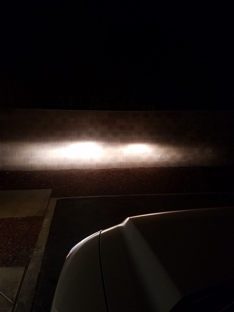

First pic: The new bulb (9011 in place of 9006) is installed on driver side only. Pics don't really do it justice compared to in person.
Front View (definitely noticeable)

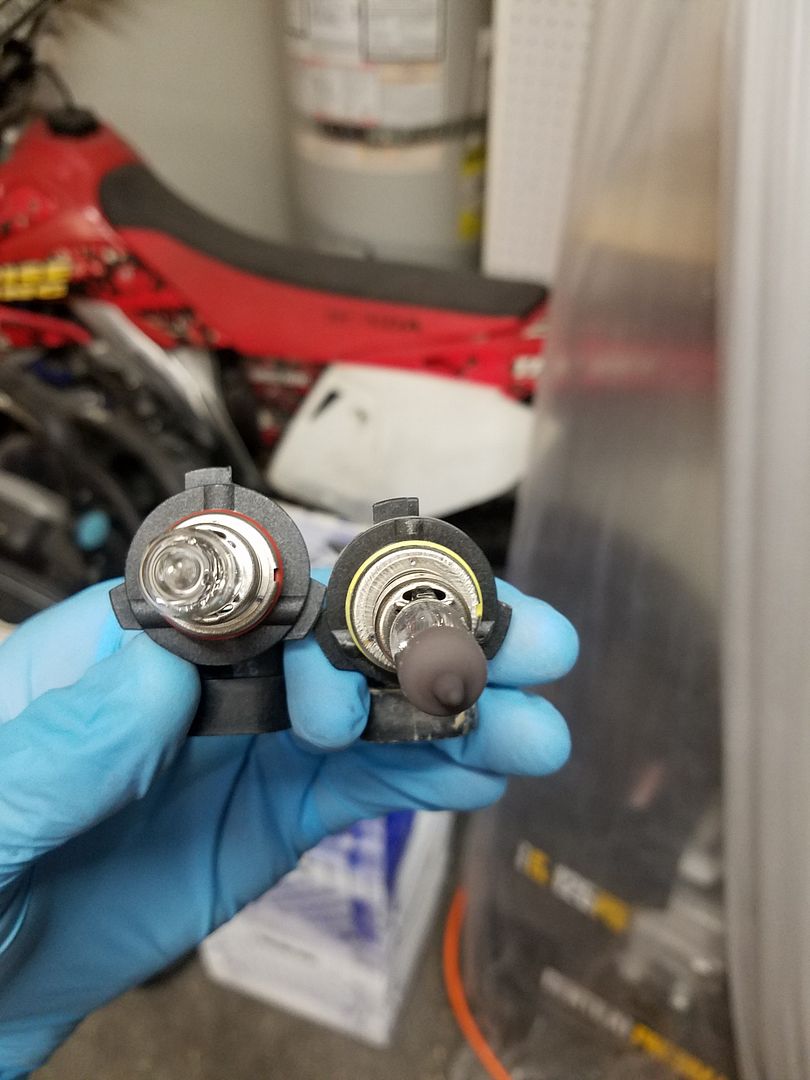

For these pics, the YELLOW O-ring is 9006 and RED O-ring is 9011. (9006 is stock)
So you can see from the first pic, only one tab on the 9011 needs to be modded to match the 9006 tabs. In the second pic the grooves inside of the plug do not match. In the 9011 I cut the grooves out all together.
I used a box cutter and pocket knife for the whole "operation"
The aftermath:
After that, you're ready to install! My driver side was nice and snug, but my passenger was not. I used an o-ring I found in my garage that fit perfect and fixed my not snug problem. I also had to adjust the height of my headlights as well, so be aware of that. The new bulbs are a HUGE improvement.
