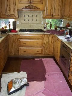

^The Work Station
2. Preheat oven to 275 Degrees. Next, grab a fairly good sized cookie sheet and set it on your workspace. Also, a good sized hand towel and dampen it with cold water. Ring it out and place on the cookie sheet.
3. Grab your first headlight, right or left whatever floats your boat, and place it face down on the towel-covered cookie sheet.

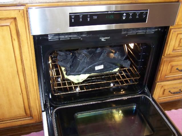

4. Once the oven's heated up, place your headlight in the oven and set your timer for 7-10min depending on your oven. I used my regular bake mode, as I have no idea how the convection mode would heat up the plastic. I don't think it really matters, but for us with those two options, simpler is better.
^Here's how tight my light was in the oven, CHECK to see if it even fits before firing it up...

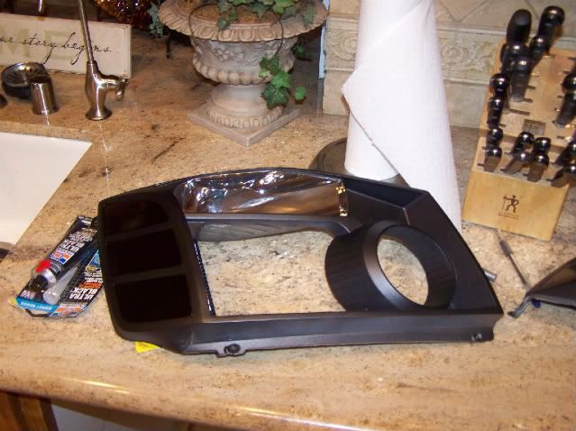

6.Once you have the two pieces separated, you'll notice that there's still gasket in the trough around the black harness. Get as much off as you can now, but if it becomes too cool or wasn't hot enough before hand, you're going to have to put that black housing right back in the oven.
7.Hopefully you left the oven on, place the black housing face down again on the cookie sheet and put back in the oven for 6 min. and remove from the oven when the timer goes off. Use anything from an exacto knife to a really small pair of needle nose pliers(I found these to be the best) to get ALL of the old gasket out. Once you've gotten it all removed, put the black housing and the clear lense off in a safe location. You can Seran wrap those clear covers now, but i chose to wait until just before I reassembled them to clean both inside and out with window cleaner, careful not to get any streaks on the inside.

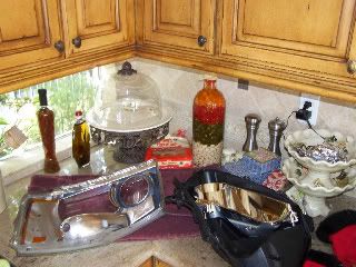

8. Repeat Steps 3-7 for the other light, once your finished, grab both sets of the chrome housings w/ reflectors and move to your work station again. remove the clear lenses from the chrome housing by using a T10 Torx bit (or really small flat head screwdriver) for the four screws holding it it place. After separating the clear lense from the chrome housing, its time to remove the orange reflector. Removing those reflectors is such a PITA but so well worth it, be very careful when removing those and take your time. There's 3 little pressure tabs behind the reflector, push them down and out to release them. Again, MAJOR PITA. Once both reflectors are removed take both your chrome housings and reflectors to your prepping/painting area.
^What the main housing looks like all separated. Note the Chrome Housing, Clear Cover and Orange reflectors

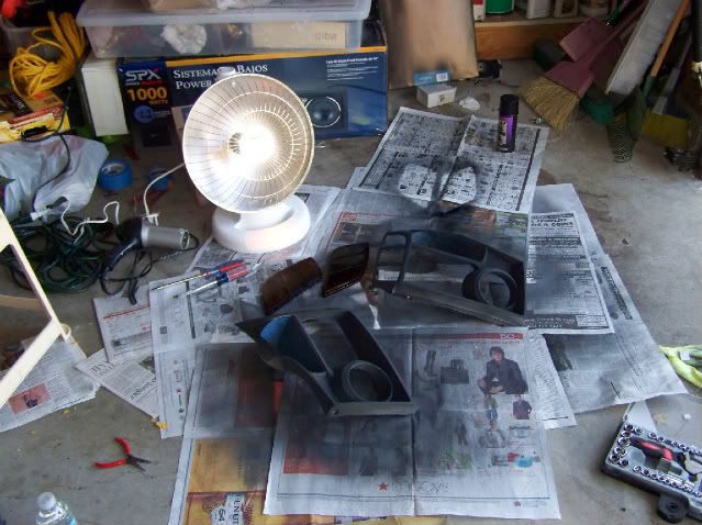

3. Set aside your reflectors and give them 5-10 min. between coats. While those are drying, get out your sandpaper (I had 220, 400 and 600 lying around) and get ready to start sanding as much of the chrome away as you possibly can. However, if you wish to maintain your blinker, mask off the upper section like shown in this picture below...
^After sanding up to 600 grit, and upper mirror masked off to retain stock driving light and indicator looks.

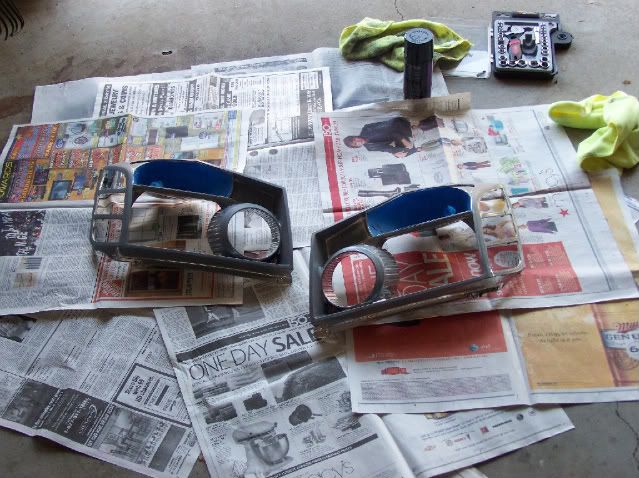

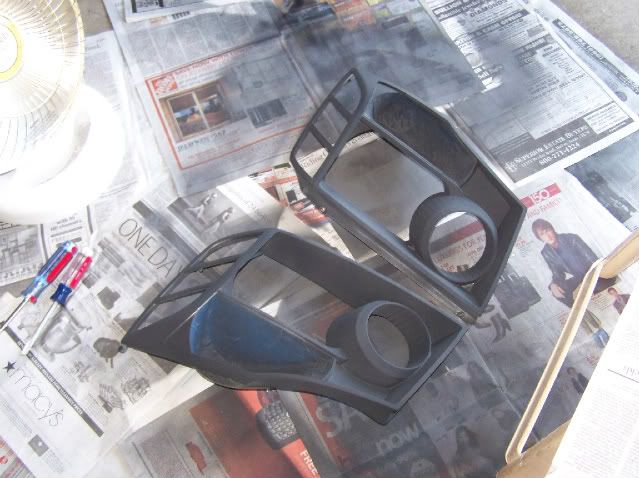

4. Alrighty then spray away, I recommend using a plastic primer before laying a base coat. Make sure its covered evenly and let cure for about an hour. Using as many coats necessary to completely cover the housing.
5. Once the primer is set, move onto the base coat of your choice. Note however, if you like the color of the primer, go with that if you'd like. I chose to use the 1/2 of a can of colormatched paint I had lying around, and after a few light coats of that, i set the housings under my heat lamp and let them dry for about an hour to an hour and a half.
^Heat lamp was working strong that day...
6. You may choose to put a layer or two of shiny clear coat if you'd like, but that's all up to you. Let dry for 1 hour under heat lamp before moving on to the final steps.
^After the primer and base coats were applied, and after a good chunk of time under the heat lamp.

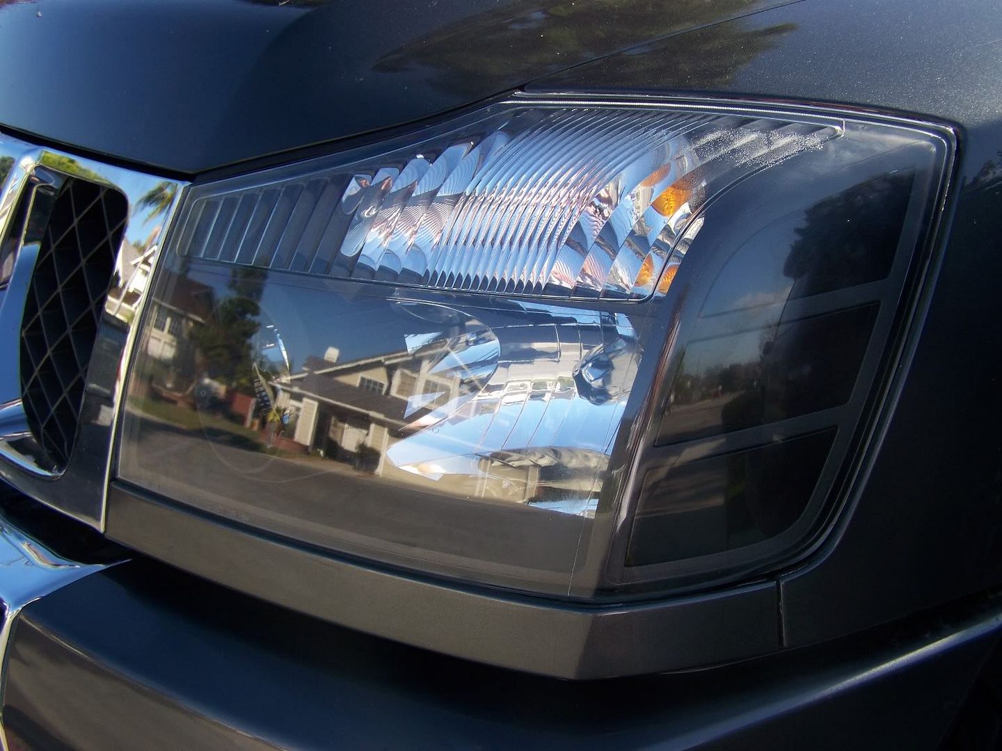

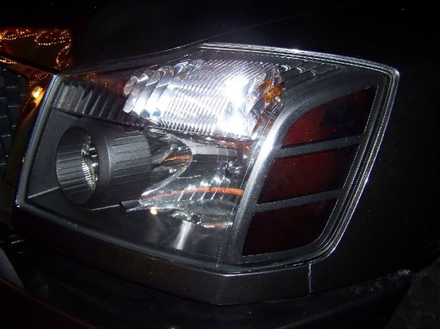

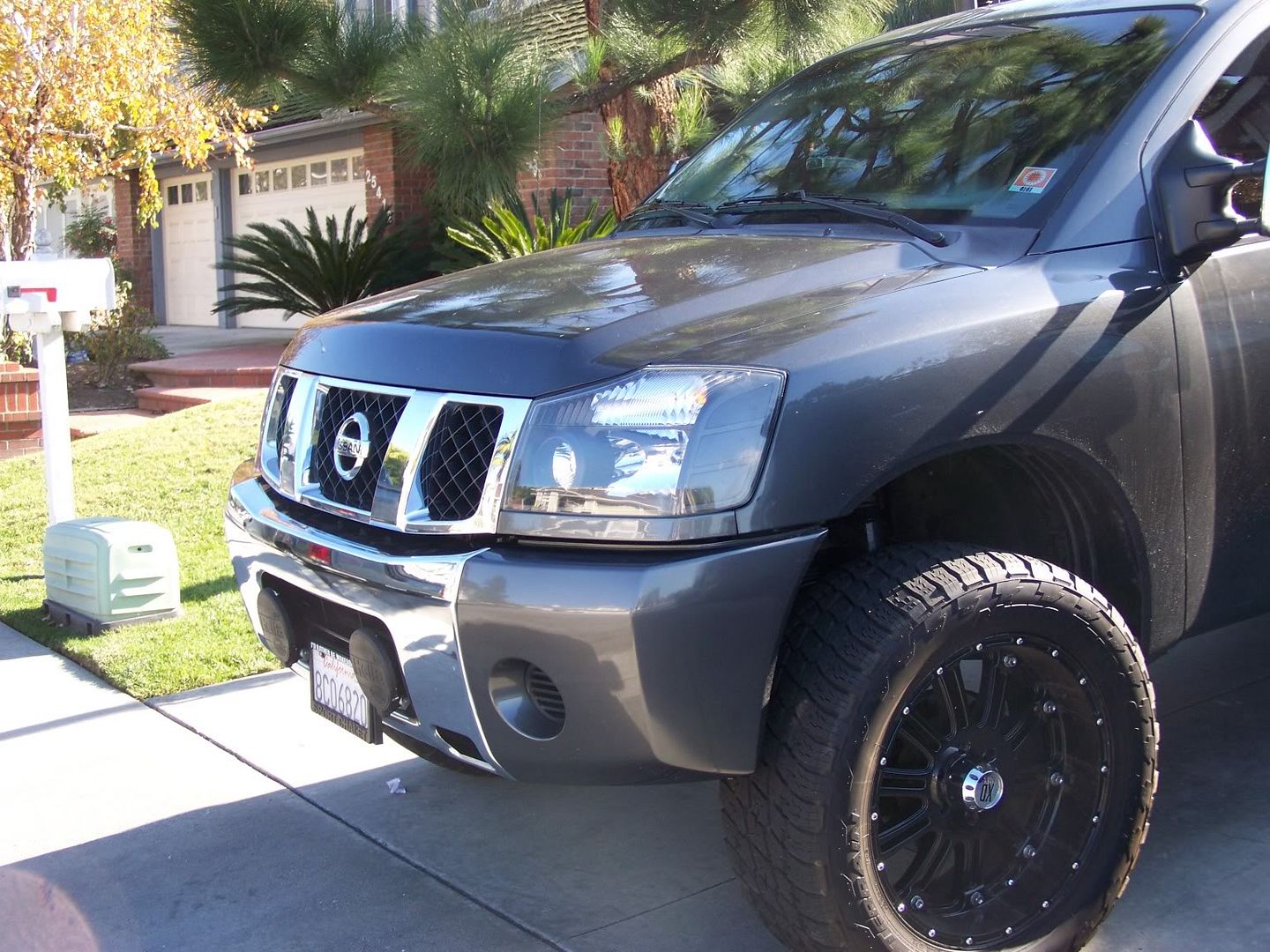

^Finished Product!
And finally the install pictures!

One of the best do it yourself mods if seen. Could you post a picture of what it looks like, looking at it from the front? Thanx
2,156 Posts
Discussion Starter · #13 ·
As soon as I get home tommorow I'll get you one!

Where is the night shots?

Hahaha looks the same at night buddy except the reflectors look red from the tint over em..
This should work just fine with the HID's...your not painting any reflectors just the plastic around em ;)
