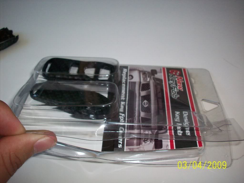

Now a picture of the new fob covers i ordered on ebay. They came in "retail" packaging (although ive never seen them at the dealers where you would think they would have them). The package said newkeyfob.com which i determined is the same company as USspeedo (at least they have the same address and phone number). The package says retail price is 24.95, although i got it cheaper from an ebay seller. Also remember there are different versions. This one is a complete replacement, but i have seen other listings that only come with the front piece.
First open the package and take the new covers out.
