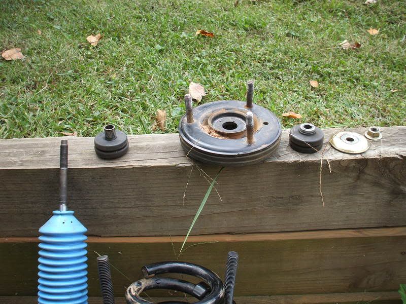

I put them on the other day and took them off roading well something went wrong. The front passanger side rattles like crazy after hittinh a big bump.
now it is always rattleing and rides like crap. here is a pic after taking them apart. I need help soon to fix this. tell me if I missed something or if you see anything that is broke or out of place. Thanks so much.

man I wish I could help ya, maybe post some more pics of the coils, entire shock, ect?
More pictures would definitely help.
I put them back together and they are still make noise. I will have to take them apart again and take some more pics.
You are missing a big-*** washer that goes under the rubber bushings (inside the coil spring, like the one on top) and the whole assembly is sliding down the shock shaft. You jsut need the big washer, these come with the bilsteins.

And the steel sleeve/bushing in the rubber grommet on the right is not supposed to be IN the grommet, it sits on th eshock shaft and holds the boot. The big washer will sit on top of that steel bushing. Ill post pics later.

They are sending me the washers but at this point a pic would deff help.
