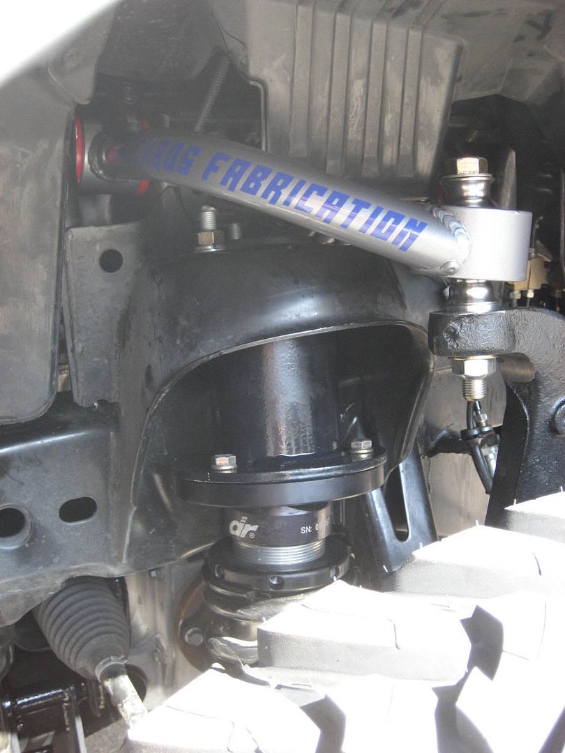

I had a 6" ProComp (bracket lift) & installed the DR / Now Icon Coilovers with the extended travel since i have the TC UCA's. If your bracket lift comes with the shock adapter extender then it will look like this...

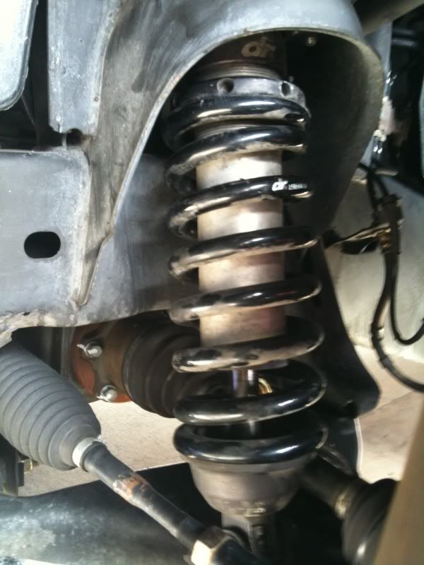

Since then, i have removed the 6" bracket lift and i was able to re-use my coilovers. With the shock adapter there's no difference in ride quality or travel. It just saved my big $$$ since i didn't have to buy another set. But it does look SICK with a LONG shock without the adapter.
Without the lift:

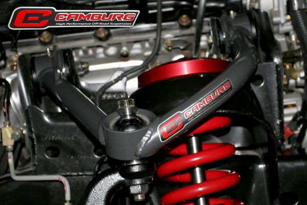

to gain the additional travel of the UCA the extended Coilover shock is recommended.
Advantage of the UCA's:
increases usable wheel travel
1" Uniball compared to the stock 1/2"
No Coilbucket contact
Eliminates weak factory joints
Heat treated SS uniball spacers
Total Chaos $680.00 + Free Shipping
Camburg $599.00
