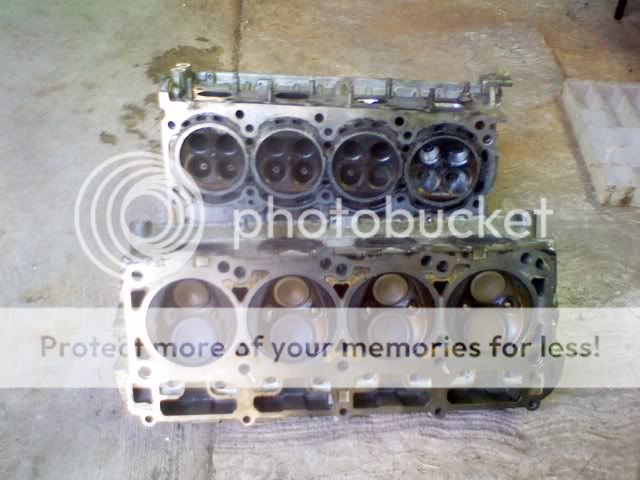

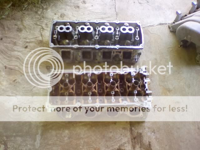

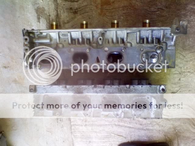

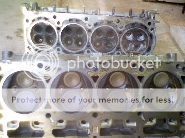

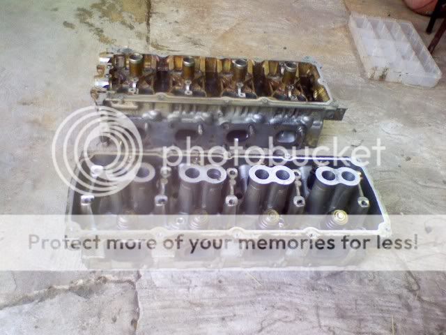

lol u might not like this or u might lol
the titan engine is actually built very similar to the hemi engine, although the titan engine looks like it has better intake and exhaust runners. hemi heads arent shabby in stock form (they outflow any gm cnc head) these are out of an 09 jeep cherokee SRT8 im fixing to start porting :) i already started porting the titan heads u can see in some pictures :D
and u wonder why dodge was gonna make the new titan :teethmast they have alot of similarities :read:

sorry man just dont see it....i see nothing that looks even close to the same...
There is nothing the same about them at all. Oval port vs square port, 2 valve vs 4 valve, dual plugs vs single. I guess the OP though that a hemispherical combustion chamber makes them similar???

And look at the size differance!!!!!!!!!

So, I wasn't the only one that had to read this twice and look at the pics a dozen times? (whew)

Nope! They are nothing alike. I sure am glad dodge didnt dip in to the VK at all.

Nice pics, but I don't understand where's the similarities are.. But I'm impress with the "big head" of the 5.6.

Not to mention vk56 dual overhead cam w/ no stinkin' half foot long push rods

and the reason the head looks bigger is because it had the cams on top of the head not like the pushrod hemi design. and the hemi head is actually alot lighter than the titan head. jpac i work on engines as a hobby and to get some extra cash flow :) ill be flow benching the titan heads once im done with them i already have the stock flow bench numbers ;)

So your statement of "built very similar" is based solely on the hemispherical chamber?
