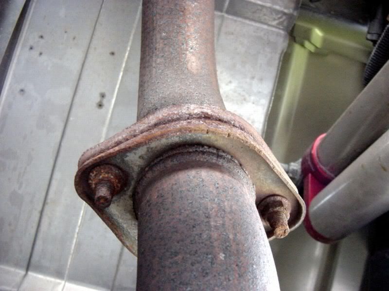

B-pipe to cat flange
Stock tailpipe flange to muffler

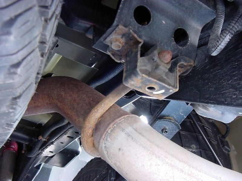

Lubricate the hangers as well.
Front hanger
Rear hanger on muffler
Tailpipe hanger
Remove the nuts from the flange connecting the tailpipe to the muffler.
Raise the front of the tailpipe up and pull tailpipe from the rear over the axle
to remove.

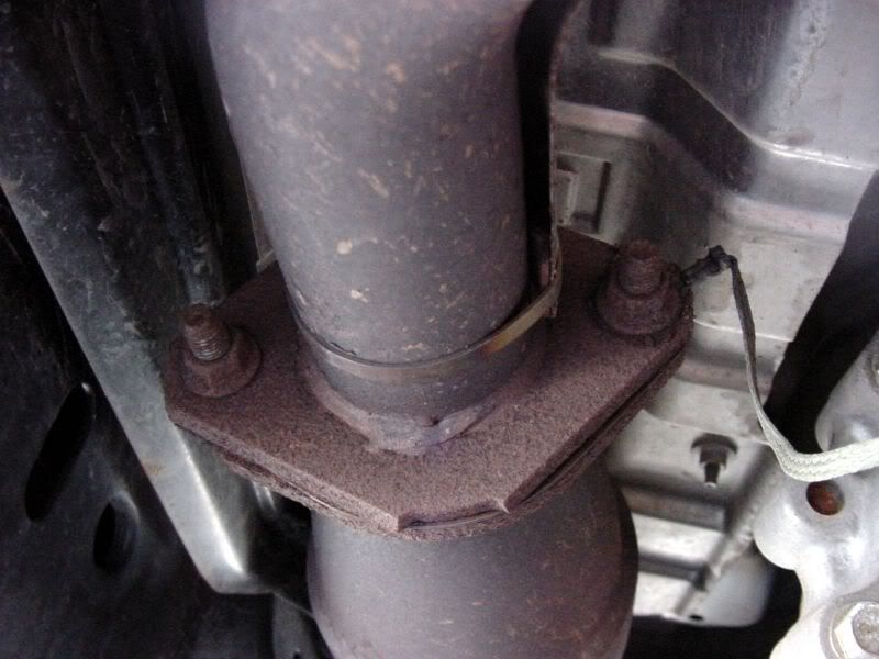

Remove the bolts from the nuts from the front flange behind the catalytic
converters. Remove the ground strap from the stud.

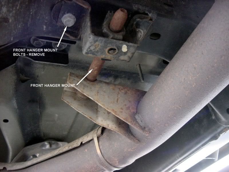

Remove the bolts in the front hanger mount. There is not enough room to
slide the rear mount forward to clear the mount unless this is removed.

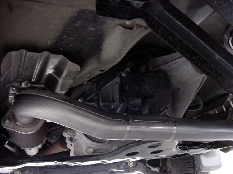

With the front hanger mount removed, and the cat bolt nuts removed, slide
the exhaust back and remove it from the truck.

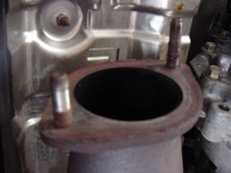

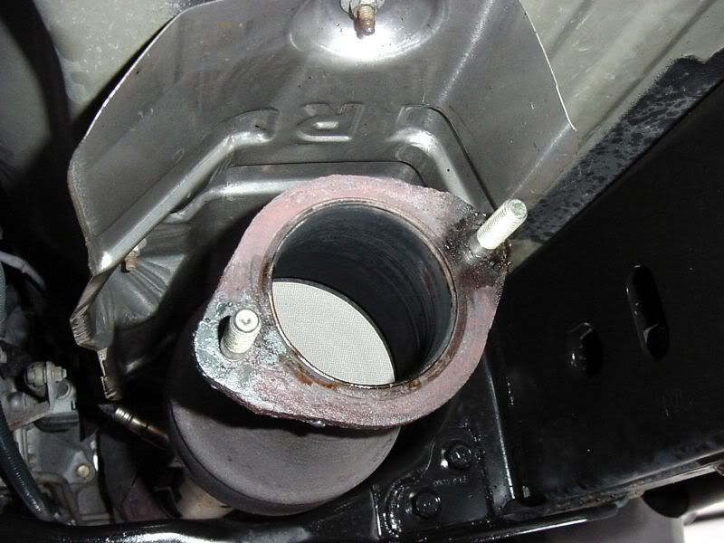

Sometimes the studs turn out of the cat flange before the nuts break loose.
This is to be avoided! In this case, circumstances were not aligned to provide
me with good karma.

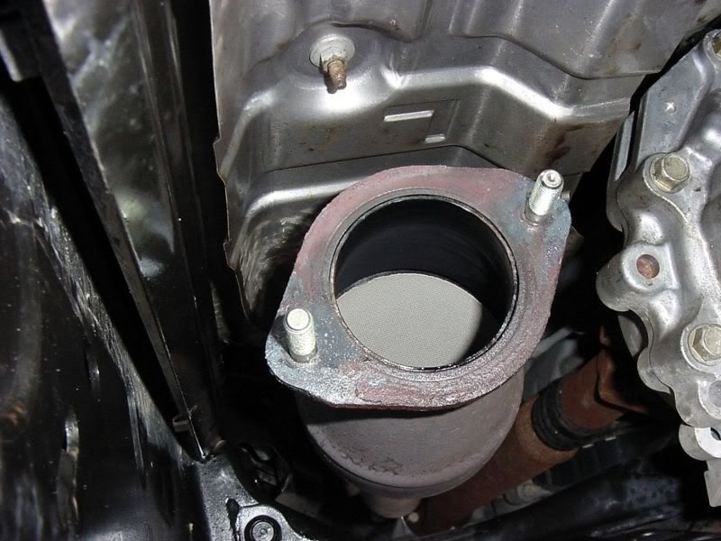

In this case, the worn stud can be seen where it “necks” down, so I decided
to remove and install new studs in both cat flanges. This is not an easy task.

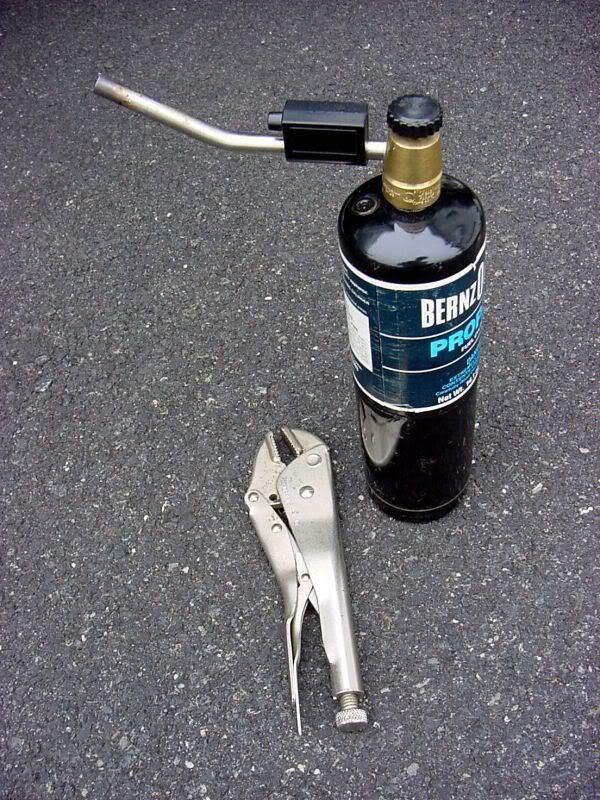

The studs are easier to remove if you superheat the cat flange around the
studs first. The tools of choice are a propane torch and a visegrip. If the
studs break, drilling the broken stud out of the flange and retapping the holes
may be required.
The stud replacement may not be needed in your installation, but I did it as
a preventative measure. Besides, one of the existing ones snapped off while
trying to reinstall it, so it was required.
Driver’s side cat flange with new studs
Passenger’s side cat flange with new studs
Clean the cat flanges with a wire brush and some sandpaper as necessary
to remove any deposits.

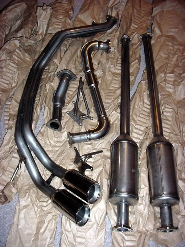

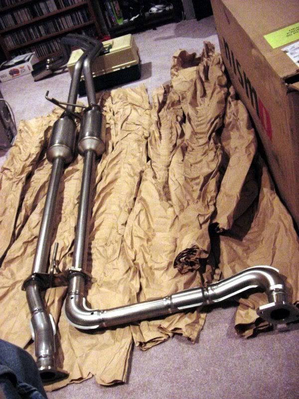

Now, it’s time to get out the new system and check that all the pieces are
there. Actually, this is something that should have been checked PRIOR to
removal of the stock system.

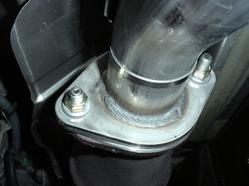

To install the Nismo Sport Exhaust Kit, the first thing is to place the new
metal flange gasket on the cat studs. Then, loosely fasten the new B-pipes
to the rear cat flanges with new nuts.

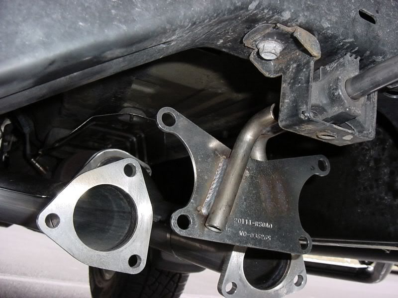

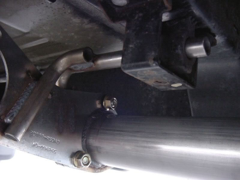

Then position the hangers in the existing hanger mounts. Note the orientation
in the drawing above. The front hanger slides into the mount from the front
and the rear hanger slides into the mount from the rear. Use lubricant spray if
necessary to slide the hangers into the rubber mounts.
Front hanger
Rear hanger

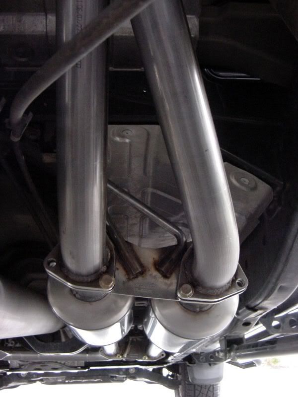

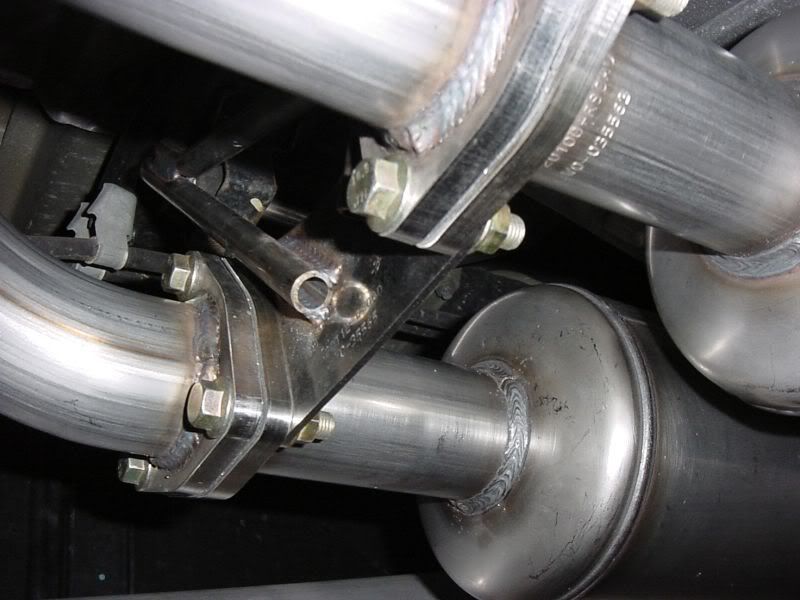

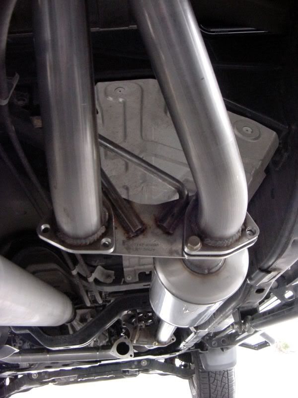

Lift one of the muffler/ pipe sections into place. Remember that the new fiber
gasket goes between the flanges and the front mounting bracket is attached
to the rear of the two flanges.

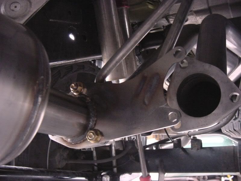

On the rear of the muffler/pipe section, the new fiber gasket is between the
flanges and the hanger bracket is to the front of the two flanges.

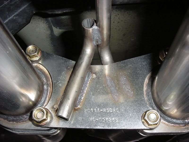

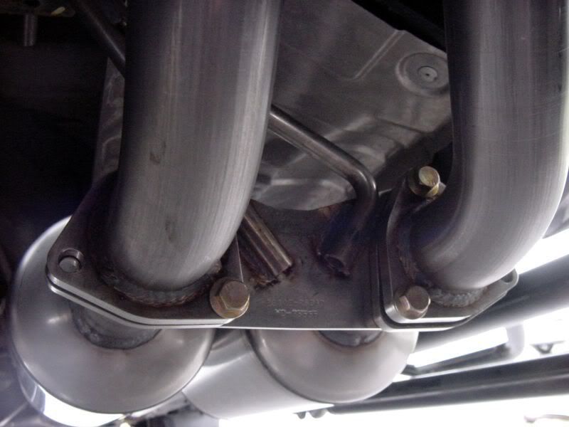

Hang the second muffler/pipe section similarly. Take care not to damage or
bend the edges of the fiber gaskets.
Install the remaining bolts and nuts, tightening them all finger tight to check
the alignment of the system and the clearance to all wires, cables,
brakelines, and suspension components.

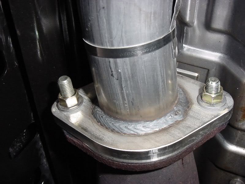

Tighten all bolts to a torque of 38-40 FT-LB starting from the front to the rear.
Driver’s side cat to B-pipe flange
Passenger’s side cat to B-pipe flange
Front hanger bracket
Rear hanger bracket
Rear flange side view
