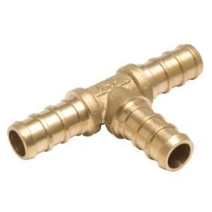

Here is a pic of Venom and the Proper routing of an oil catch can. make sure to hook up the lines correctly.This will keep the oil out of the intake. Off the valves and away from the spark plugs. This should stop the smoking and reassure you the engine is ready for another 100K.
Parts list needed
1. Oil catch can ( Baffled )
2. 3/8 Tee x2
3. Marine grade zip ties for a proper seal( Clamps can be used but are overkill and ugly )
4. 10 ' of Oil resistant hose like Transmission line . do NOT use fuel line or SILICONE hose.
