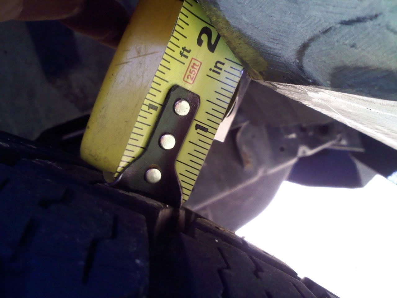

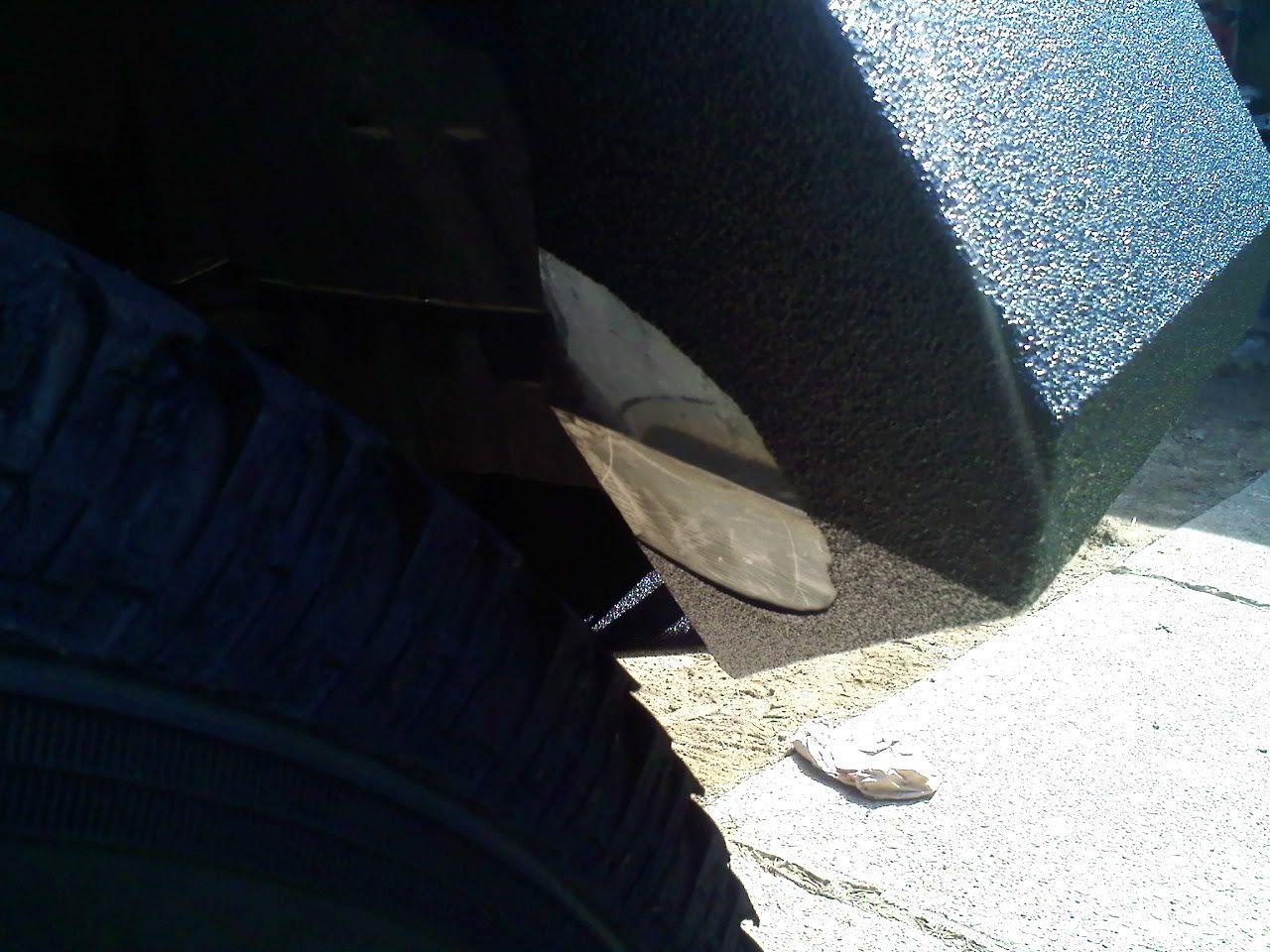

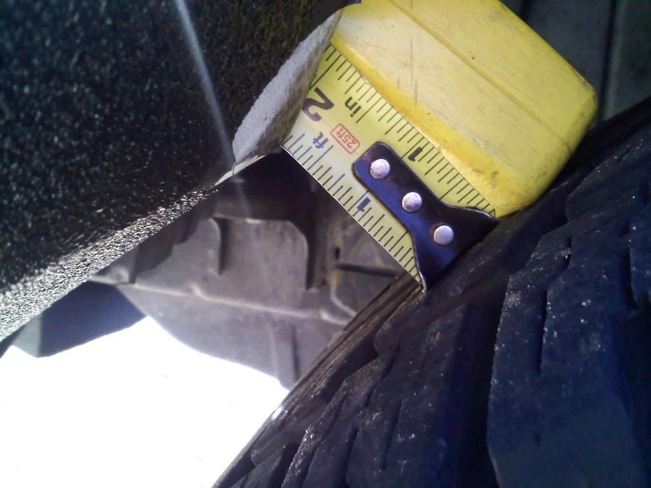

Here is the current clearence of tires to bumper.
Went for a road test, no problems turning, or braking into a turn. However, no potholes allowed or speed humps. The tires are still rubbing when the suspension is compressed by engaging one of those.
So another email sent to Ironbull last night, and I'm kinda at a loss at what to do next.

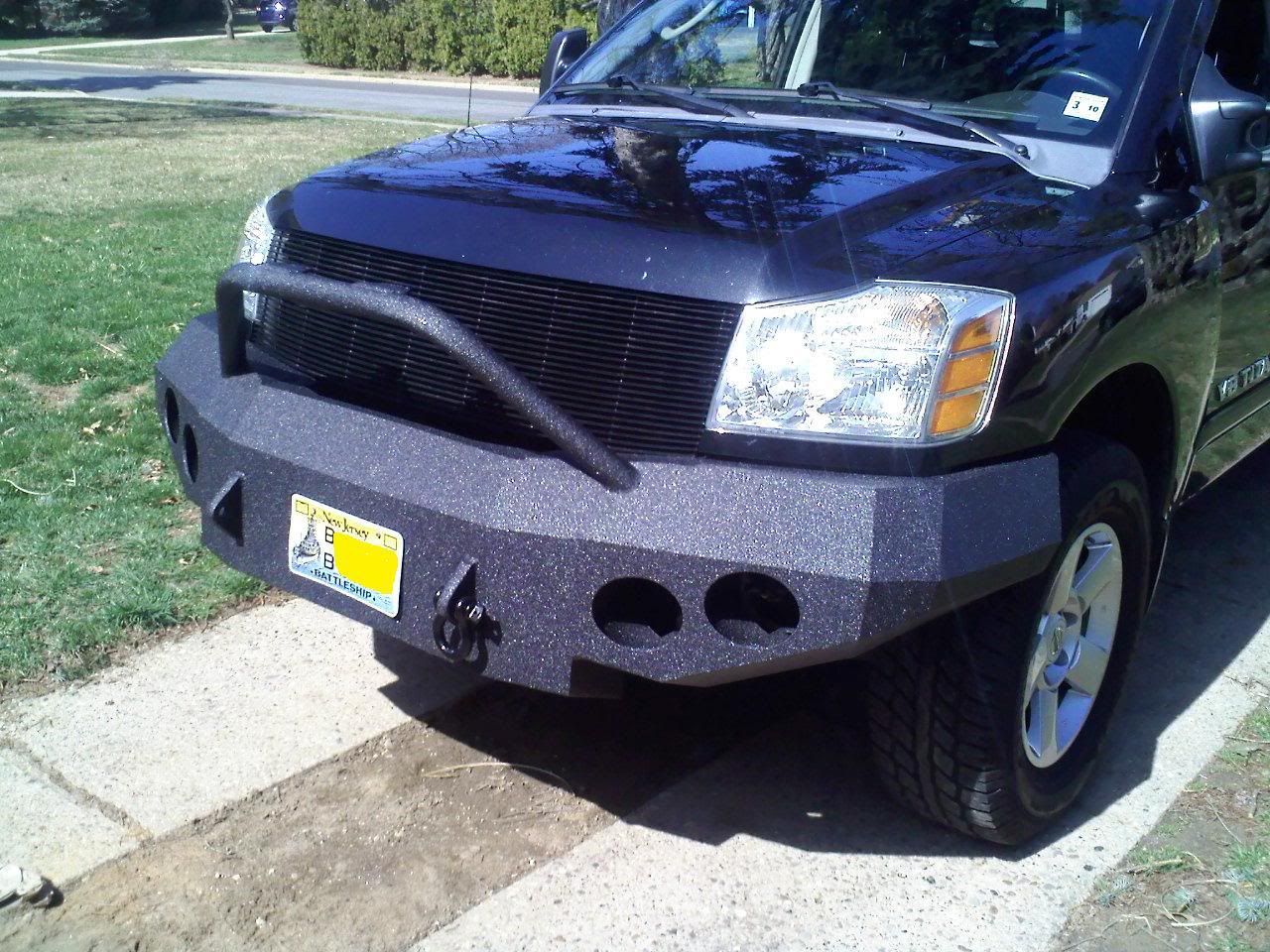

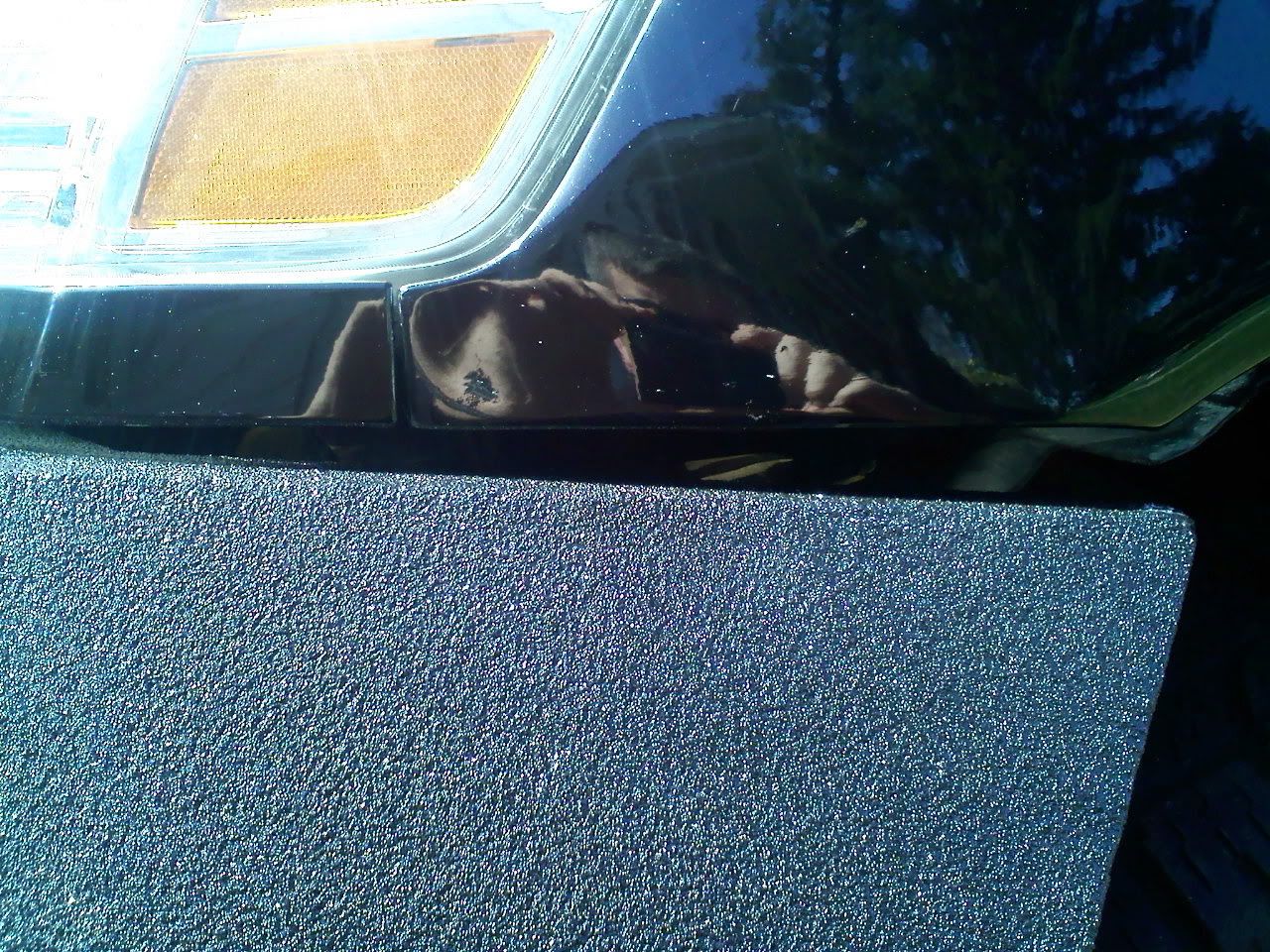

Here are some other pics of my Titan with the bumper installed.

Look really nice man, But i think you need to roll the bumper forward as you shouldnt have that Angled look it should sit in there flush like the bumper piece did.
Look really good, Thought id let you know about the angle thing as it would drive me insane

It did on the initial install, but when I did the parkinglot road test the tires grabbed onto the bumper, pulled it down, and bent something in the process.:teeth::teeth:
And yes the angle thing does bother me, you know everthing has its place and will be in is place...........

I was hoping the 2" coil spacers from PRG would be the end all fix, but there is still rub when the suspension is compressed. I really don't have the fundage right now to do a suspension lift or go back to the stock tire size. I also don't know exactly how far back the Ironbull bumper goes into the wheel well vs the stock bumper.
One of the emails I received from Jessie @ Ironbull said they are in the process of redesigning the bumper for the 2006 Titans that have older suspension components.

Did they not even test their product for fitment? That is horrible. Judging by the lack of contour to the body, I would bet it is a universal shell they make and they slapped some titan mounts on it without testing. I'd ask for my money back. There isnt even any flow area for your radiator.

My friends agree with me....looks like the shell to a dodge bumper....look at the gap in front of the grill and the lines of the bumper....they match a dodge. Great job to Iron bull for slapping some titan mounts on a dodge bumper and calling it good. Thats some good $$$ spent on their engineering/R&D.

After intalling my winch and winch mount (just north of 200 lbs together) I installed the SAW coilovers from PRG. I did this because the added weight on the front end had lowered the front a bit and when hitting moderate bumps the suspension would bottom out. With the stronger coils and adjustability I don't have that problem any more. Still, it looks like the bumper isn't designed right. If that angle cannot be eliminated then I would send it back, that looks wrong and may be contributing to your problems.
