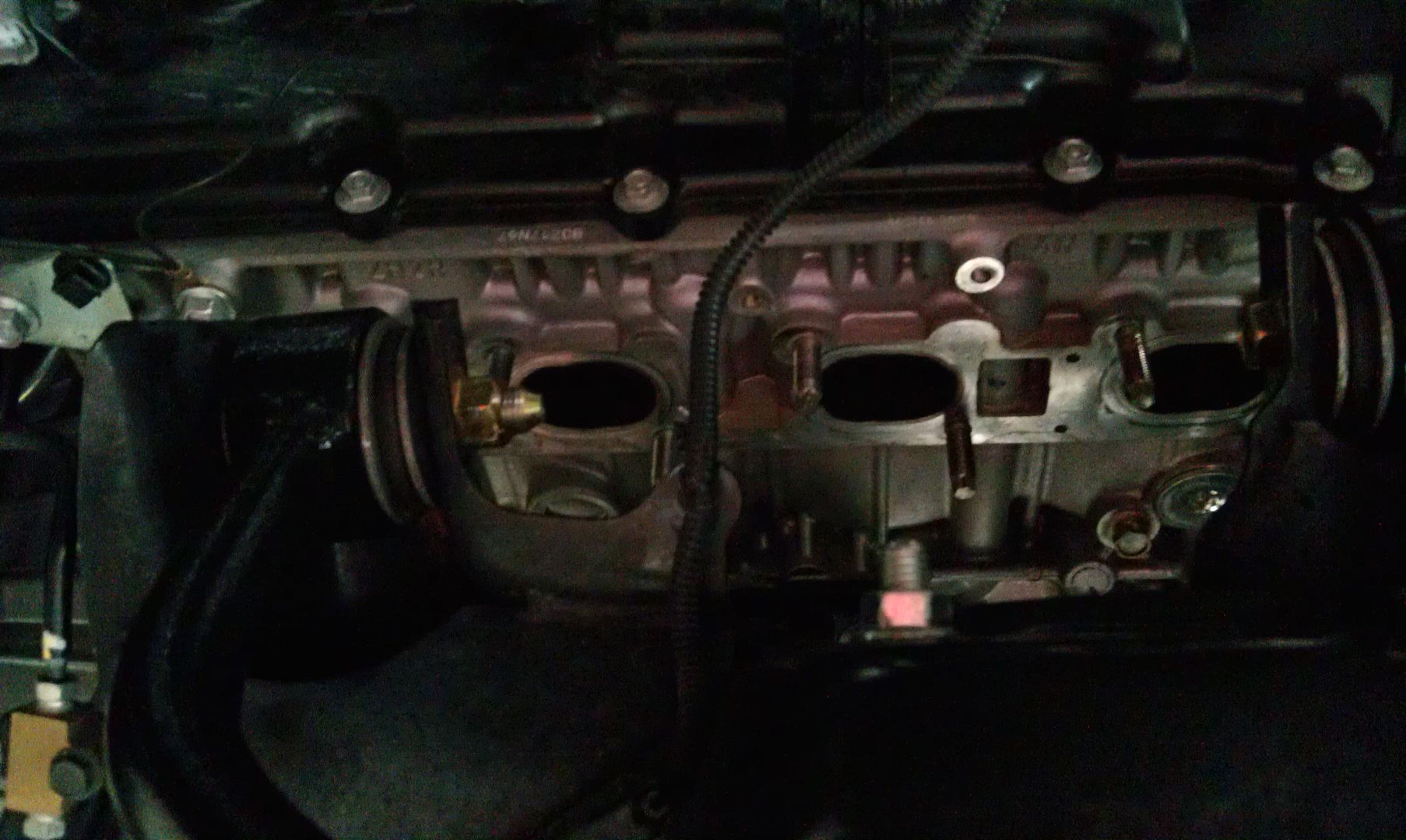

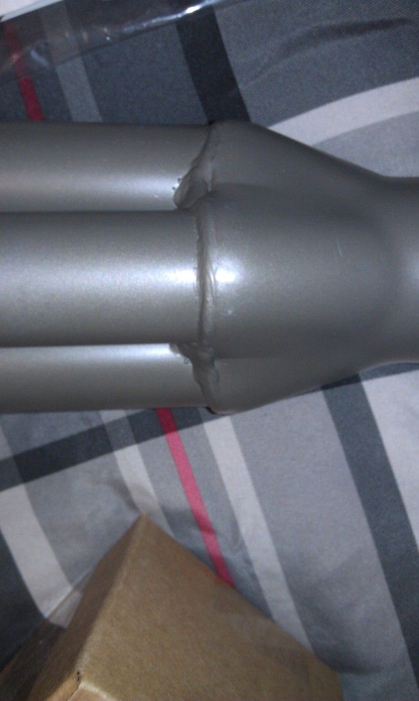

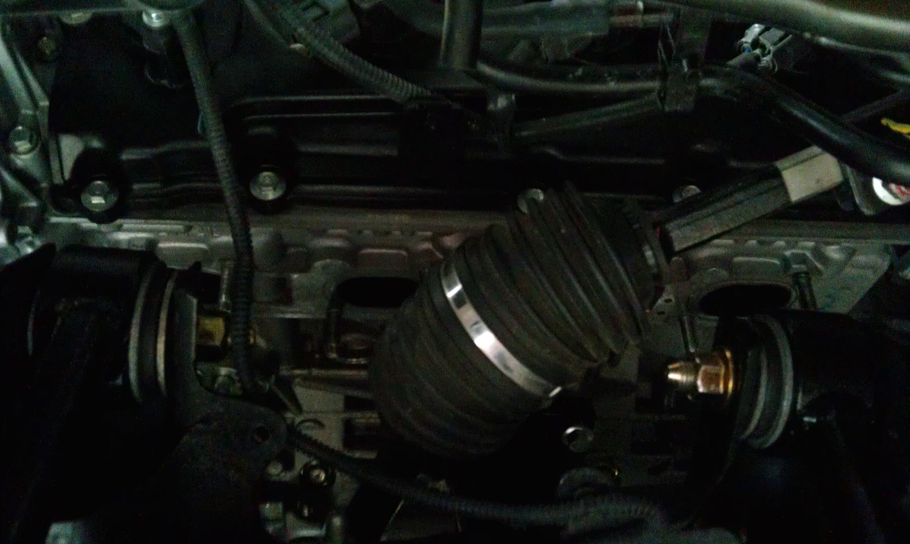

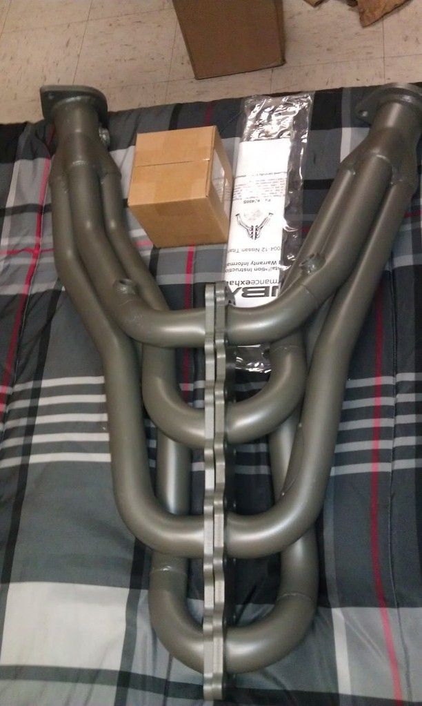

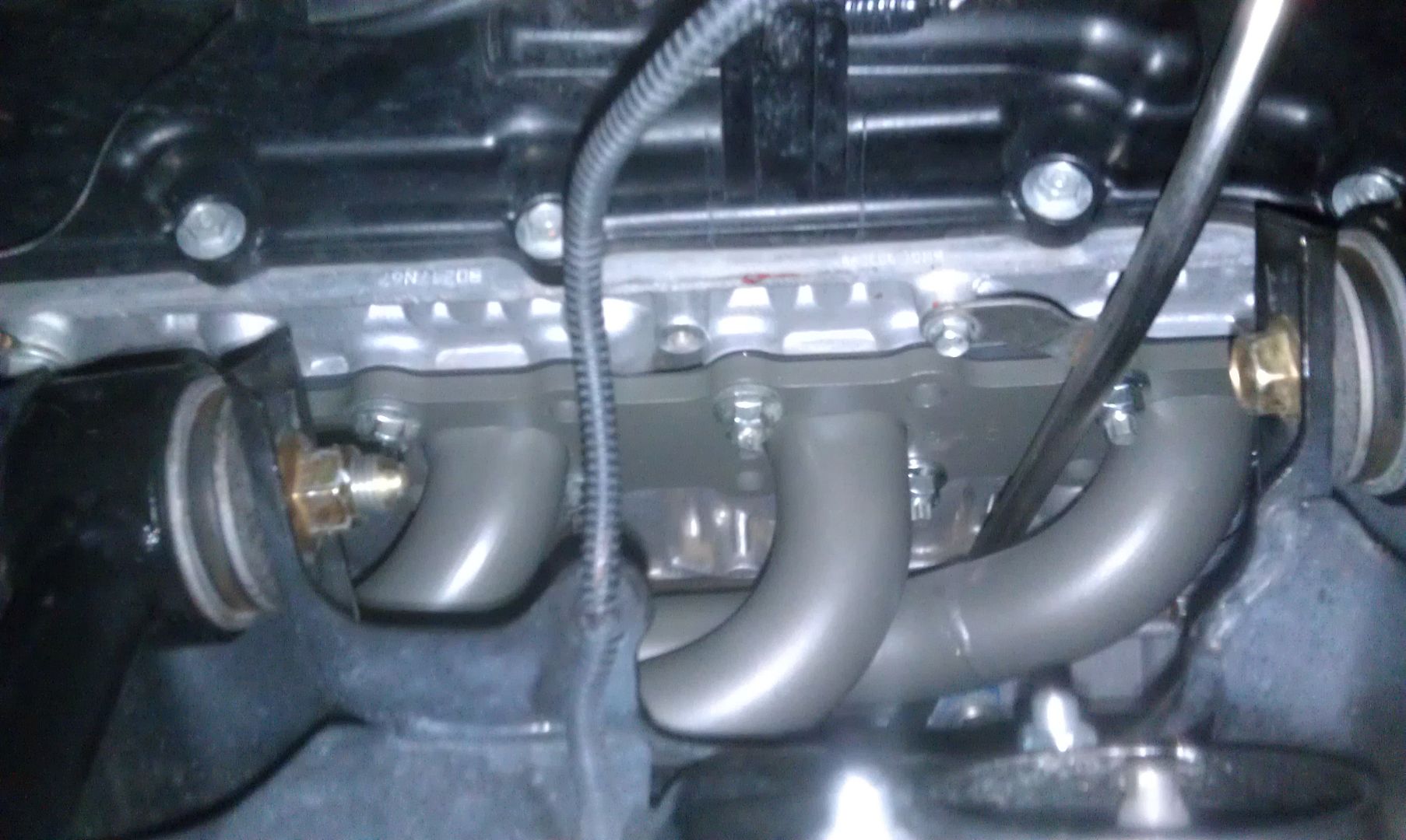

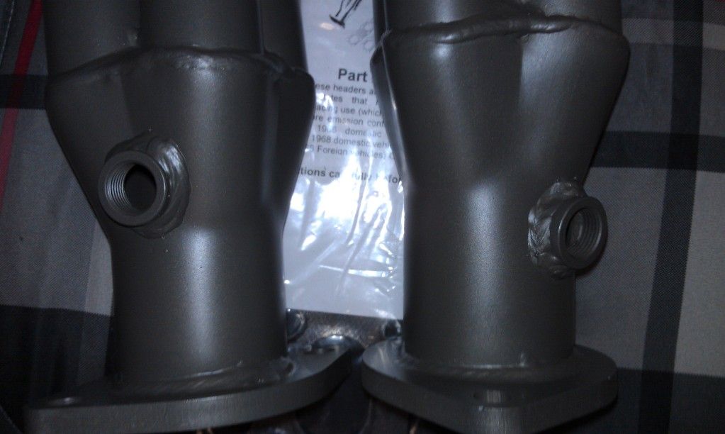

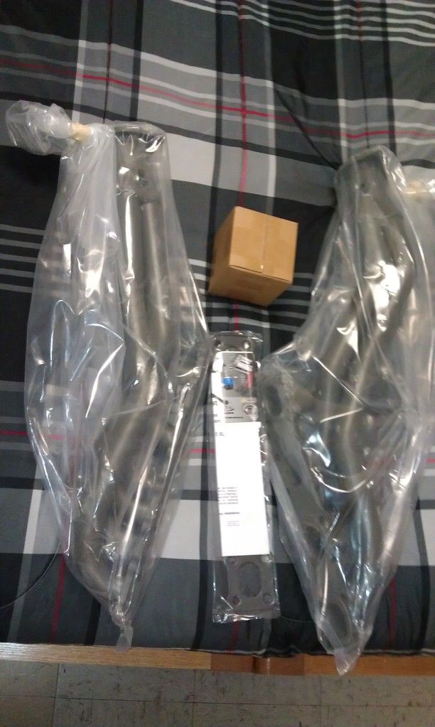

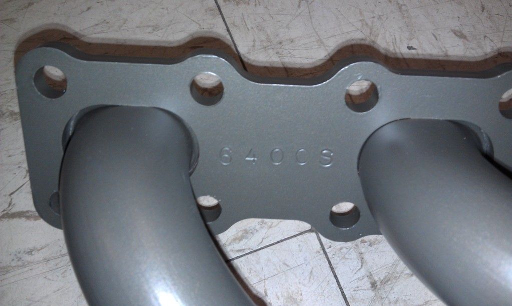

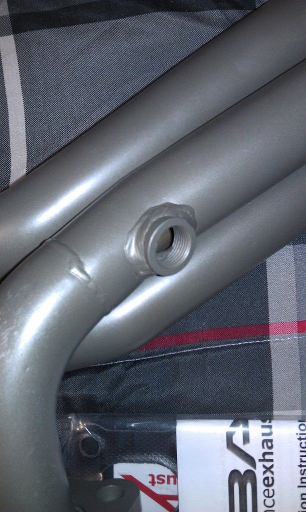

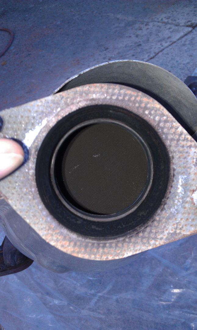

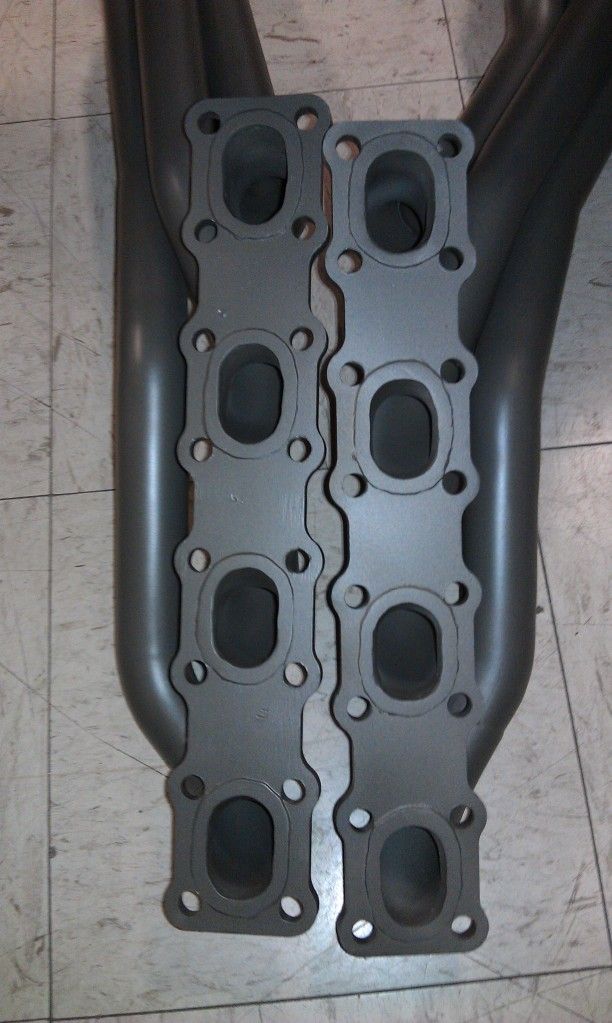

I did this install last month at my brothers shop. The complete installation time was a little over 5 hours total. I used 02 bung extenders on my cajun bpipes to keep the CEL from coming on. about 300 miles after the install I got a CEL for the secondary 02 sensors, I cleared the code with my BDGT and haven't had any codes since (500 miles later).
I have put about 800 miles on it since the install, and AFRs are in the 12s at WOT according to my BDGT and in the 14s/15s normal throttle. I will eventually get UPREV and a proper tune later down the road, but being a FFV I think I'll be ok for now.
a few pics of the install

@ jbowles, I am 4x4 and clearance is the same as others here have stated...its about 1/2 inch. Ill have to get some pics the next time I'm underneath...
@bigjimbo, 8 hrs sounds about right if your doing the swap alone...my brother did the passenger side while I did the driver-side, so 10 man hours total. tips; you won't be able to remove the manifold studs, that was my original plan, I was trying to keep from loosening the motor mount bolts. I ended up loosening the motor mount bolts and jacking the engine up to get the manifolds out and the headers into place. Make sure you have multiple long extensions and a few swivel joints for the ratchets and extensions...We did everything while the truck was on the ground, we didn't need to jack up the vehicle itself at all. I also used swivel ratcheting wrenches, they were handy...

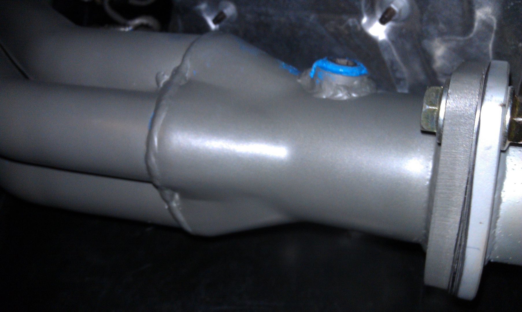

Which O2 bung extenders did you use?

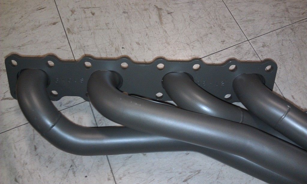

is that titanium color ceramic coating on those JBA LTs? if so, they look sick. Great write up/install and pictures as always from KDO (KAY-DOE/KADO, is how it sounds lol)

Yep, thats the titanium coating. Silver Ceramic is almost chrome like in appearance.
There fixed it for ya. These are my silver ceramic coated ones.
