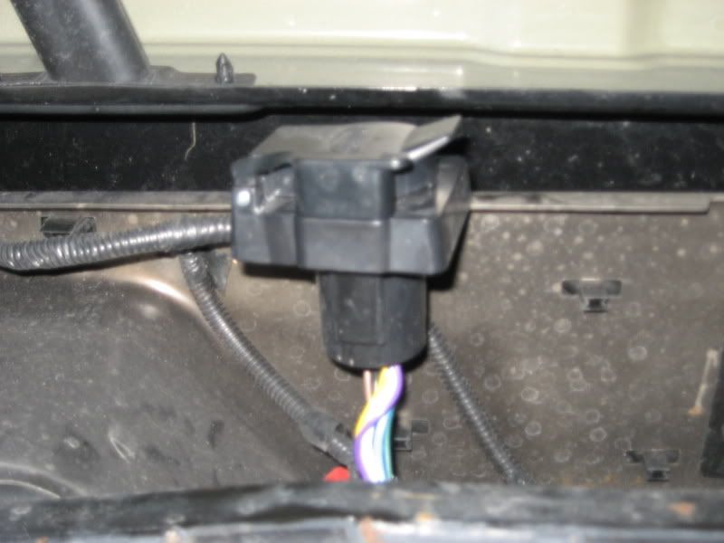

so i bought the Line Of Fire on ebay and then found out that it was on backorder for over a week. Now i finally got it and when I went to install it the thing wont work. It will only light up when the parking lights are on... NO Blinkers or Breaklights.
I bought an adapter from a local store to make the factory round 7 pin a flat 4pin. I have an 07 SE CC w/o the towing pkg. All I had under the truck is the factory round 7pin plug.
So i got the only adapter i could find after trying 4 stores and it still wont work. the dealership told me that i needed relays to make the plug work correctly. is this true??? i have heard on here that all i have to do is plug it into the adapter that i installed. The relays are only if you want the white backup lights to work which i dont have on the line of fire.
heres a pic of my adapt under the truck that goes from the factory 7pin to the other end that has a 4pin flat and also a 4pin round.
PLEASE HELP!!!!!!!
THANKS!!!!!!
i had previously purchased an adapter for pullin out boat, but thats all i used to plug it in. and mine works with the running lights, brake lights, and blinker. i never added a relay.
may just be a problem with the light bar. or with your trailer light wiring....
you need two relays to make it work. the other might have had the relays already. the only way the tow harness will work is with the two relays. get those first before you send your line of fire back!!:domohit:

will i need the relays if i hardwire it to one of the taillights???
just got the 3 relays and it works, thought that would be easier than hardwiring even tho the relays cost me $50 :(
