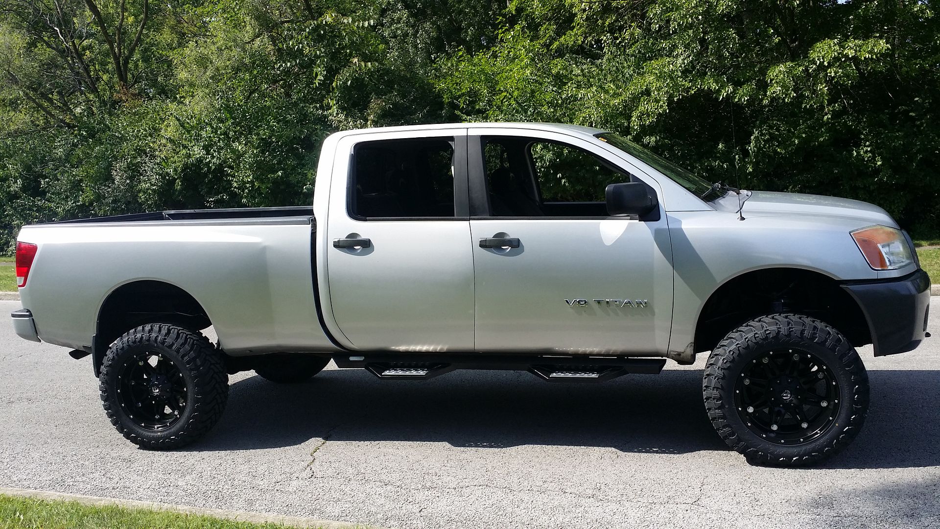

Thanks man and your truck looks good! See I want my tires to stick out like yours. What tires are those kinda look like trail blades.

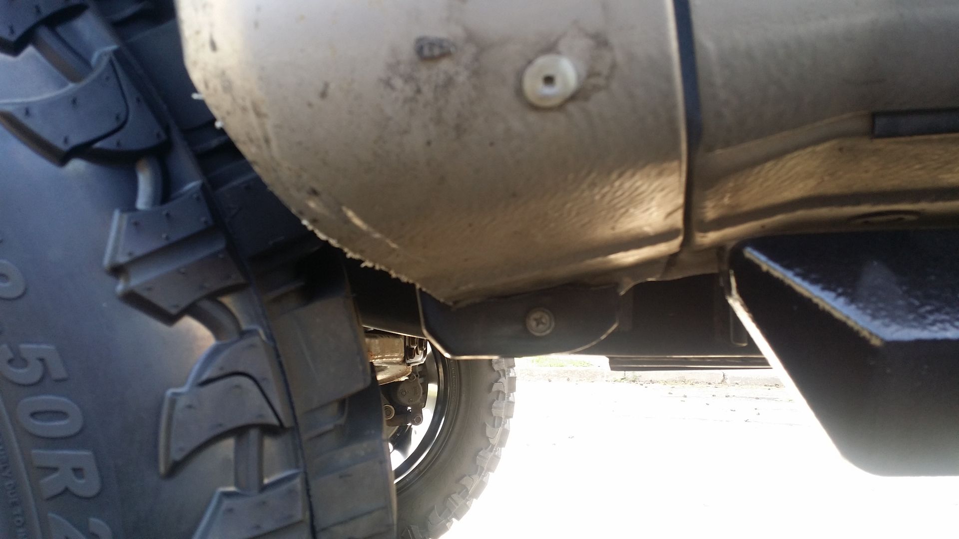

i thought about that too regarding 22's but for the Fuel Hostage i didn't like the offset available. they only carried the 22x9.5 -18mm offset but i wanted a 10" wide wheel with -24mm offset to get the 2-3" past the fender. -44 is too wide for me and you're talking 3-5" past the fender. and yes, those are the Atturo Trail Blades MTZ's. you will need to do a PWM cause i rubbed big time and i have a 8-9" lift.
i cut about 1" across the bottom as well as the PWM. you can see the cut. also, i was able to pull the fender flush and i used the fender bolt there that fastens the fender to the bottom...i drilled a hole through the liner and reattached to that point. came out really clean if you ask me.

That looks AMAZING.
Do -44, you will love it
ugh...love that LED light bar on top! :devil: the stance is sweet! i'm still wondering if i should've went -44's but drive thru's would have been a PITA! :eek_surprise: OOOH...what stuby antenna is that?

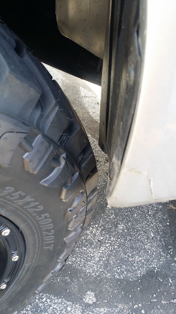

It's not too bad, I whip through the Dunkin Donuts drive thru everyday for my liquid crack addiction.
I must say it feels more stable with the wider footprint on the -44s vs my old rims.

What size lift, tires, wheels etc. do you have on your T?
Sorry for the delayed response, it didn't notify me for some reason.
It's a six inch Rough Country Bracket lift with Bilsteins in the Front on mid perch. The rear has Monroe load adjusting shocks and a lift shackle put in to make it even with the front as the Bilateins caused it to be higher.
Wheels are 20x12" Moto Metal 962's, -44 offset.
Tires are BFG KO2s in 325/65r20.
Hope that helps!
