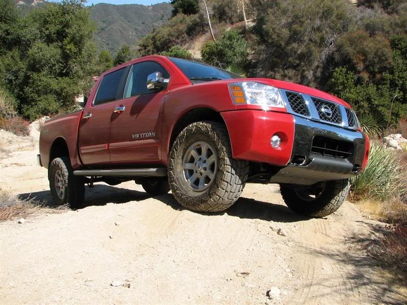

Here's a pic of mine way back when on 35/12.50R17
315/70R17 BFG a/t KO's
Nice truck. Does it have a 2.5 lift? what about the rear end? Thanks

Factory wheel allow the most tire, when going to aftermarket wheels most of them have less backspacing which means more rubbing...
Did everybody notice on Yellomantis's truck how little the Titan frame torques?...
The suspension would have flexed a lot more if I removed the sway bar prior to off roading...
