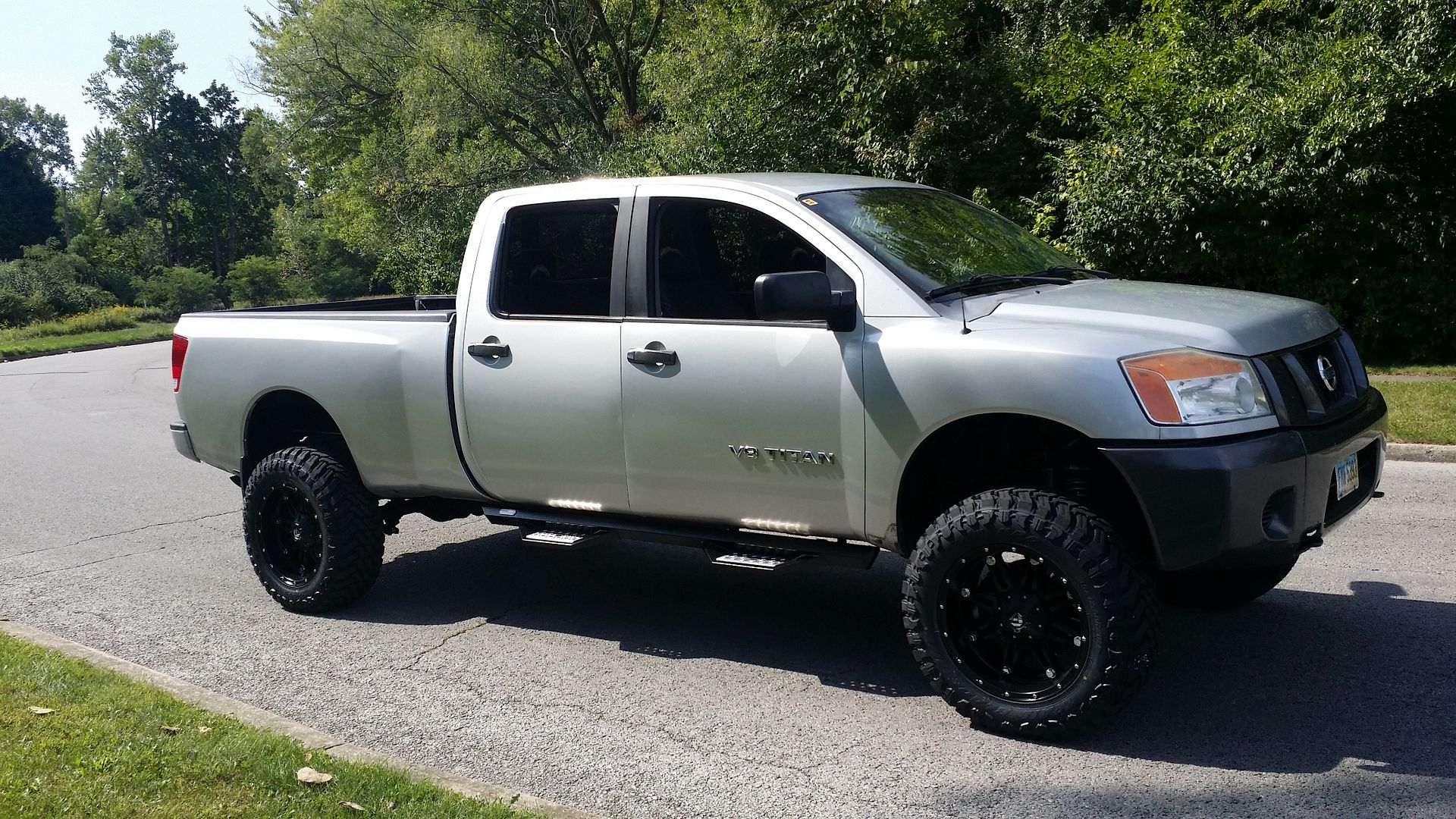

so here she is stock 2008 Nissan Titan LWB

So stock height the truck was sitting at 36.75"
she measure at 39"
here's how it looked with the install"

and here they are in the flesh! :devil:
so after breaking the bank (wifey) :wink: here she is coming together! what i still have yet to install which i have to wait for my next day off is the Carrier Bracket and have my buddy here at work weld the CJD Traction Bar brackets on. i already installed the CJD bracket that goes under the axle instead of using the OEM plate to save time.
here's some teasers pictures for now...i'll get a full on shots when it's done. also need to finish putting the rear tires on as i couldn't believe how heavy MT 35's are that i thought i was going to break my back! :eek_surprise: lol i had to slide a 2x4 underneath the tire and pump the jack up and down until i can get the lugs to line up! what i *itch! :eek_surprise: and because the black paint or powder coating on the Fuel Hostage was thick i couldn't get the socket to go inside the lug hole. i had to use my impact gun with the socket on to grind out some of the paint inside a bit. so that put me back a bit from installing the rears. anyways, here's what she looks like as of now.
here's the front suspension with the Maxtrac Spindle installed. i went ahead and spray painted Black Satin Rustoleum on the frame and wheel well amongst other components not seen here. looks clean to me! :big_grin:
i'm gonna say that's about 3" outside fenders

hope you guys enjoyed my build so far! i welcome any advice, comments, criticism and what not :devil:
