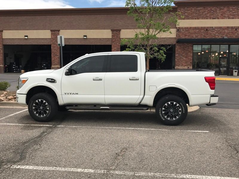

Discussion Starter · #10 ·
I should have the finished product tomorrow if all goes as planned. Here is a sneak peak. What I can tell you is the 3" motofab kit has the front end up a solid 3" and with 2" blocks in the back it's dead level per the level I put on the bed rail. I did not order sway bar end links and it needs them so I ordered them tonight. The SPC UCA's went on perfectly, they are very beefy including the adjustable ball joints. I just had back surgery so my mechanic came to my house and installed the whole thing for $300. He said with the new UCA's the geometry looked good and he had no concerns.

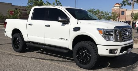

Discussion Starter · #14 ·
It's on, it's sick looking, and I'm thrilled. I'll get pics up soon. First off, I am getting massive rubbing. I've done some shaping of the fender wells with a heat gun. I can see with some discreet trimming behind the fender well and shaping it will no longer be an issue. Question... How does one know if the 2" blocks made the shocks too short? Going over a bump in the road at speed and you get a clunk sensation by chance? I think it's official that 2" blocks need longer shocks as some wise men have already stated. I believe I will be going to 1" blocks.
