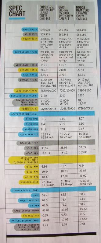

I was very suprised to see how bad the gas milage is on new diesel trucks pulling a load.
Here is what my Popular Mechanics November issue posted.
Check out the bottom mpg tested stats. Empty they did good but with a 10,000LB load the best truck was 7.49 mpg :huh:

That's bad. That's down in Titan range...almost. :lol:
Of all my friends and family who tow heavy with diesels, I've never heard them talk about numbers that low. I'm a bit skeptical.

My brother in-law has a 08 or 09 loaded F-250 diesel (all stock) and tows the same boat i have but on a single axel trailer we both towed to the same spot last year and when we arived his trip computer said he had gotten 11 mpg and mine said I was at 10 mpg. I thought his computer maybe off but after reading this i think it was correct

Heck, a newer tractor trailer weighing in at 40 tons total can get the kind of mileage posted on that PM page. It's just sad that a towing rig weighing in at 1/5th that weight total can only get that kind of mileage.
