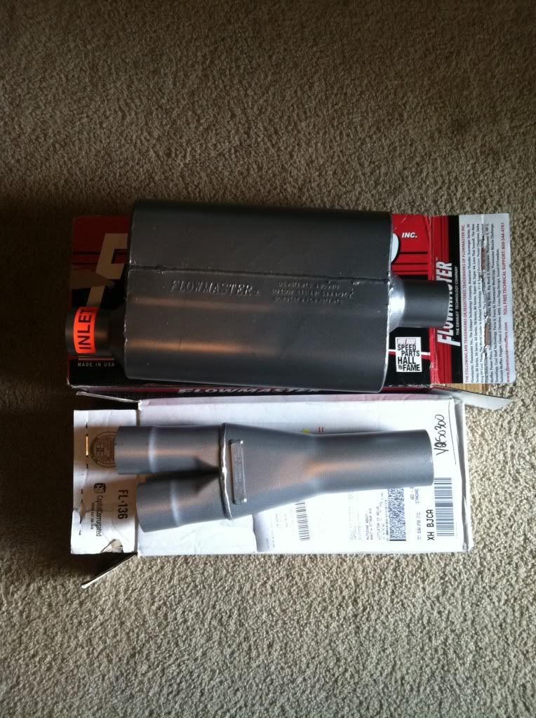

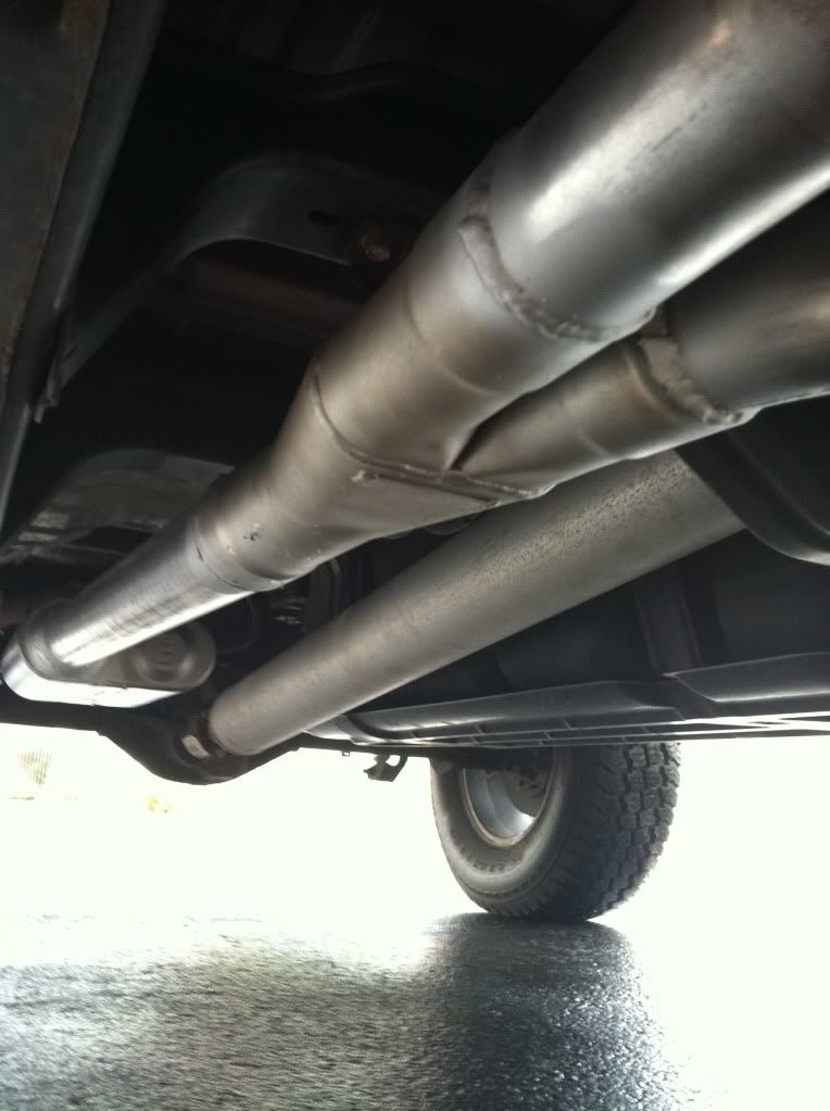

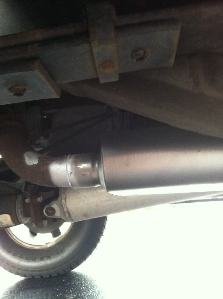

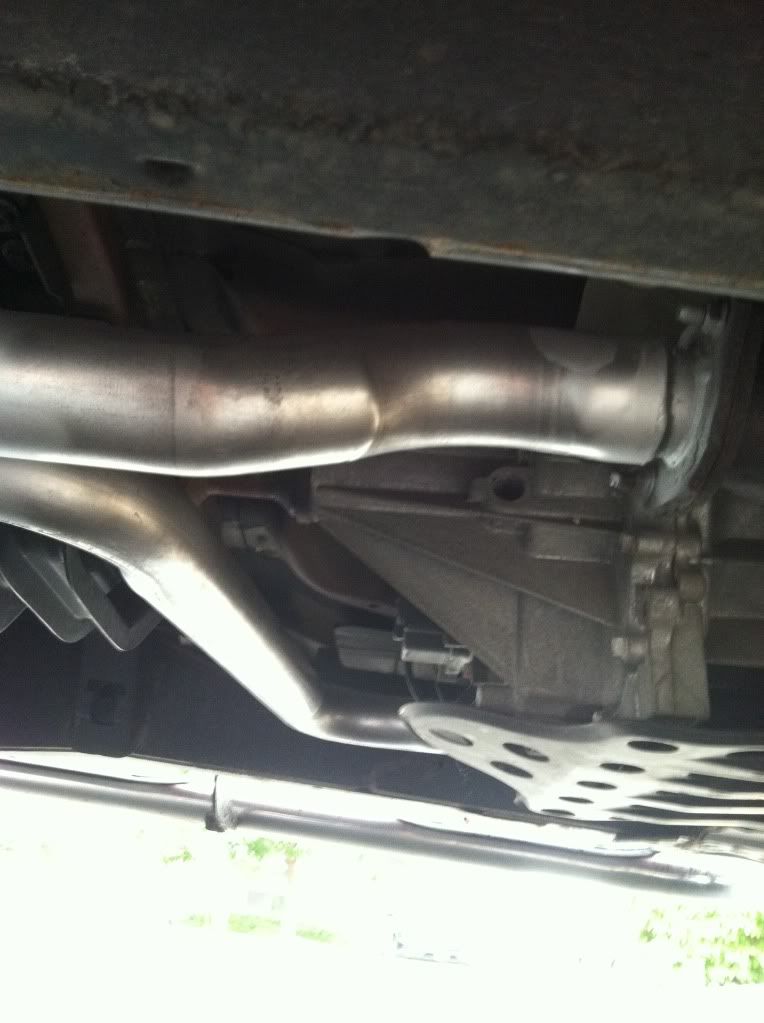

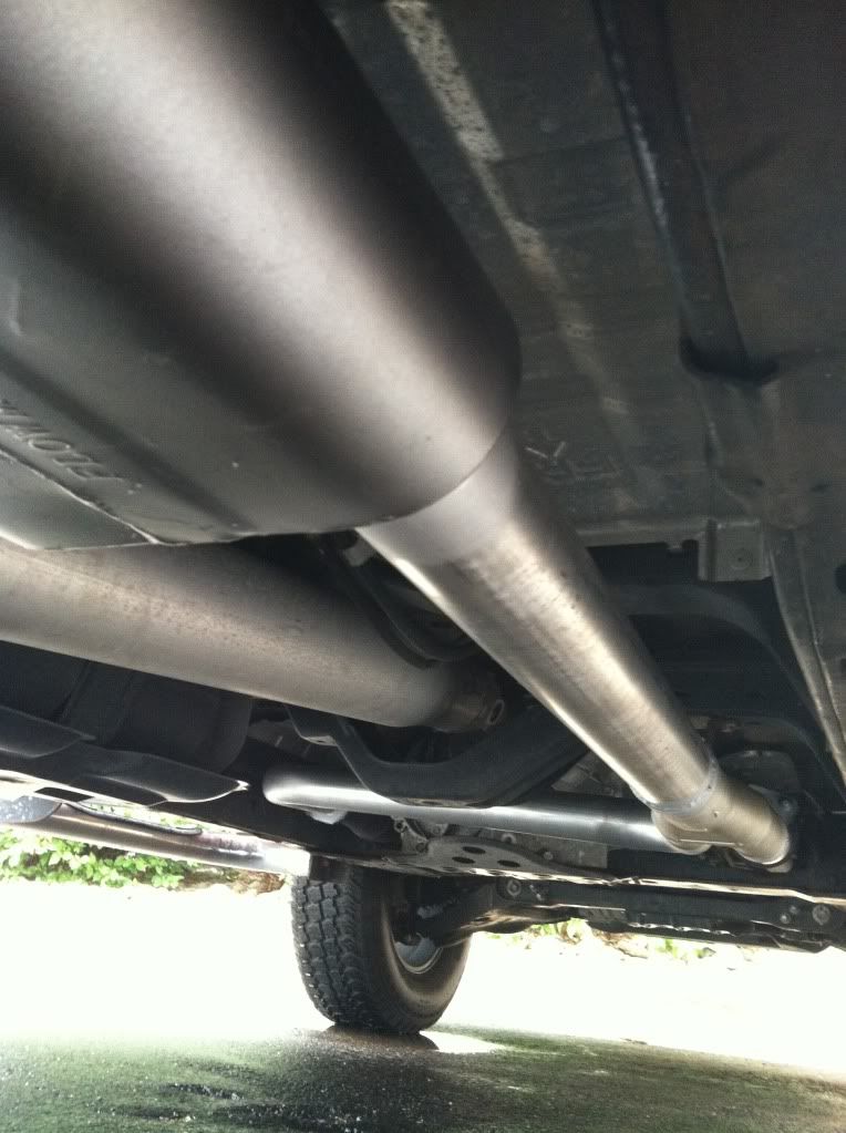

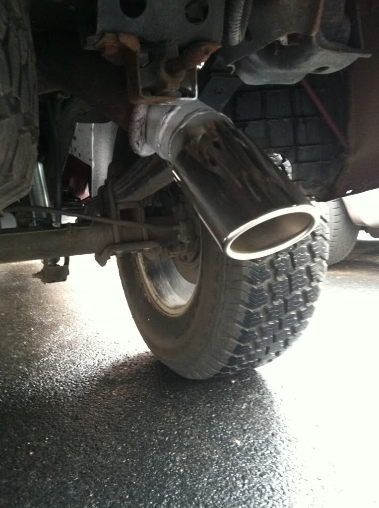

Here are the pics from the install...came out really awesome...exactly the sound I was looking for. I couldn't be happier!! They cut off the stock pipes right at the rear cats. Ran new 2.5'' pipes to my new FM y-pipe and then ran new 3'' pipe from there to the FM 40 series muffler. Then they kept the OEM exhaust from there and cut off the OEM tail pipe and welded on the tip. The tip is pretty much hidden from the rear. You can see it if you're fairly far away. But you can definitely hear it! :)
