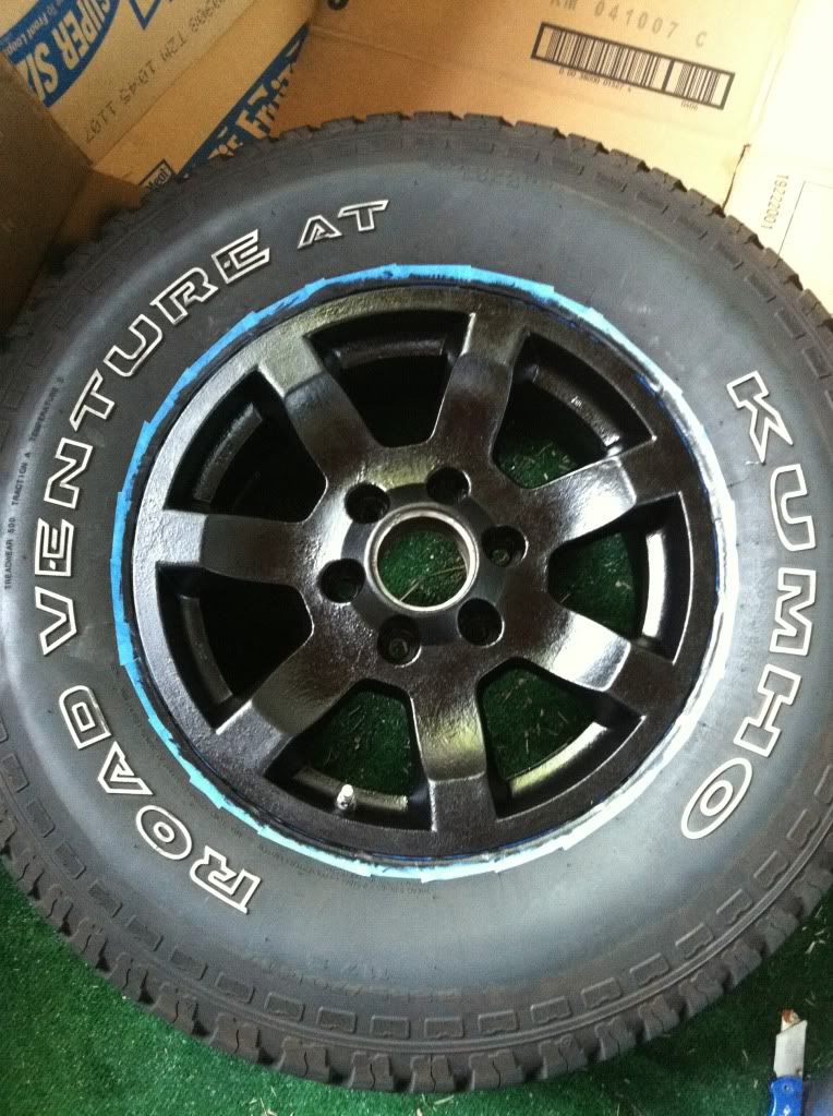

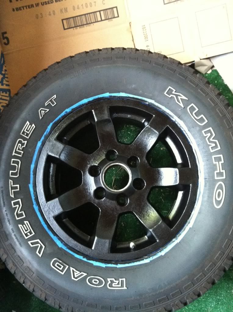

Unfortunately, I live in an apartment right now. So, I been wanting to bedline my stock 4x4 offroad rims. Well, I couldn't spray them cuz it would just smell WAY too bad on the patio. So, I went to autozone and purchased the roll/brush on can, 2qts just to be safe! I also got the applicator kit that comes with a brush, roller paint brush, a pan and a scrub pad.
Now I know there are going to be good and bad opinions. I don't mind. In the end myself and my wife really like the outcome so far. We really like how it is textured, makes it look rugged! Anyway, this is the first rim. I sanded/scuffed with 180 grit paper and layed on a really thin coat. Waited for that to dry. Then put on a nice thick coat, waited 2 hours per instructions, then layed another coat. These pics are about an hour after the last coat. Same rim just 2 different pics. 3 more rims to go!!! :clap:
Its not fully dry yet. So, that is why some spots look bright and shiny. It just needs to fully cure! It does look MUCH better in person ;)

I have a feeling this stuff is going to be WAY stronger than the spray stuff. But, it does look much better in person than those pics. I did try spraying that rim first but it filled the apartment with that HORRIBLE smell. Plus, we have a 7month old baby and a 2yr old. So you can only imagine what the wife was saying! :bangit:
