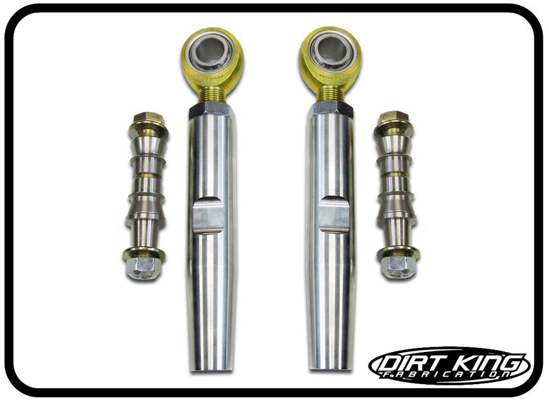

Interesting that the DK Billet Heimed Steering will work on lifted Titans but not on Spindle lifts according to DK's website? I'll probably go with CVTitans

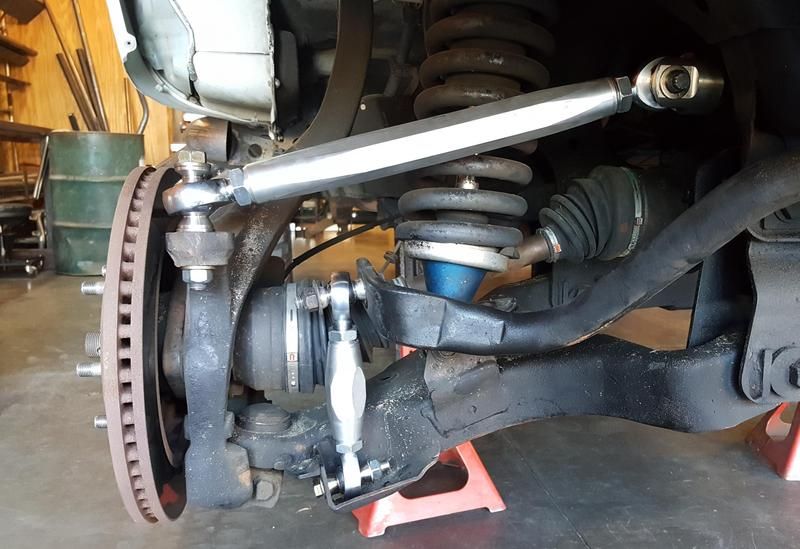

I accidentally deleted my inbox and all of his quotes were in there. I'll have to PM him and ask if that heim steering will work with lifted spindles? Also, the clevis it...is that needed to work with steering heims?
14,458 Posts
be careful when doing clevis. it adds stress to the rack if you don't move the outer mount (the one on the spindle, can't be moved on a cast steel spindle)
if he just machines you a part for the outer tie rod, it will thread onto the OEM inner tie rod, and still have the Heim joint to bolt to the spindle. just like what DK sells.
