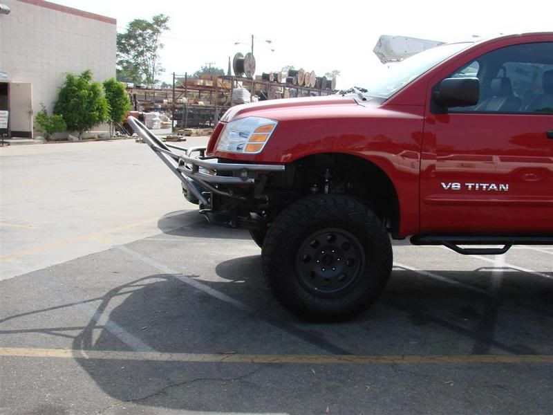

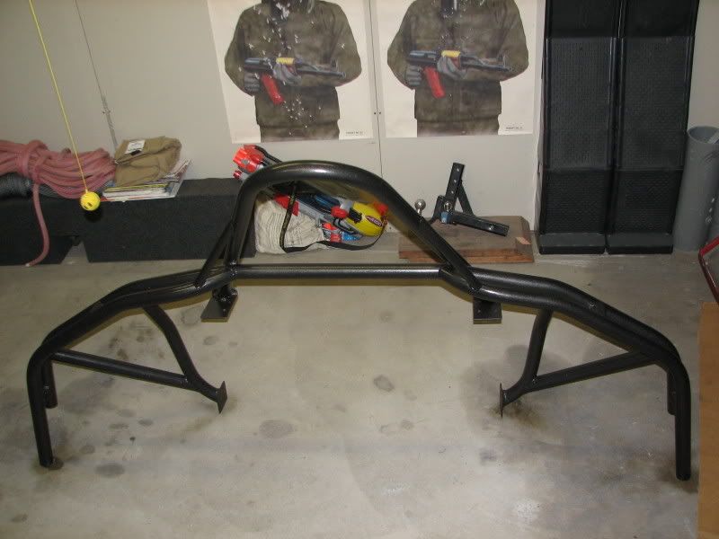

.120 wall DOM for crush factor. 1.75" pipe, 35' used and the skid plate is 1/4" aluminum plate. 100% bolt on.
5,752 Posts
d0va said:
mantis your bumper is badazz, That style is not popular at all here in Tx, I bet people would look at it weird but I like it...
Hehe, thanks, but I get a lot of retarded looks here too. I think the only place it would get "the nod" would be near the Rubicon.
