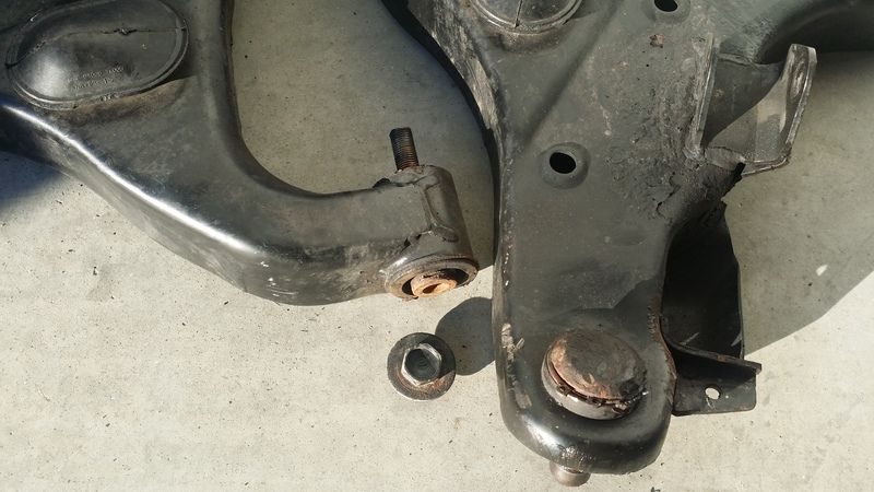

The Ruff country arms arrived yesterday and look good. It does say in the instructions to grind the inner tabs of the control arm pockets? Do I need to do this?
Sent from my iPhone using Tapatalk Pro
14,458 Posts
Yes. Or else the tabs will destroy the rubber bushings.

Just a quick update, passenger side is just about done but I am having trouble getting the rear nut off of the upper control arm. There is not very much space to get a breaker bar and socket on due to the steering column that comes down. Anyone have any suggestions?
14,458 Posts
Put the wrench on it (the closed end) and then stack another wrench on the end of the open end. Takes some effort for sure, but this is how I do it every time, haven't busted a knuckle yet. Slow gradual increase in pressure keeps you from slipping off the wrench or nut. Throw a wrench on the bolt but don't worry about it unless you can actually see it move. that nut might break loose without needing to hold the bolt in place.
DO NOT ROUND THAT NUT lol.
