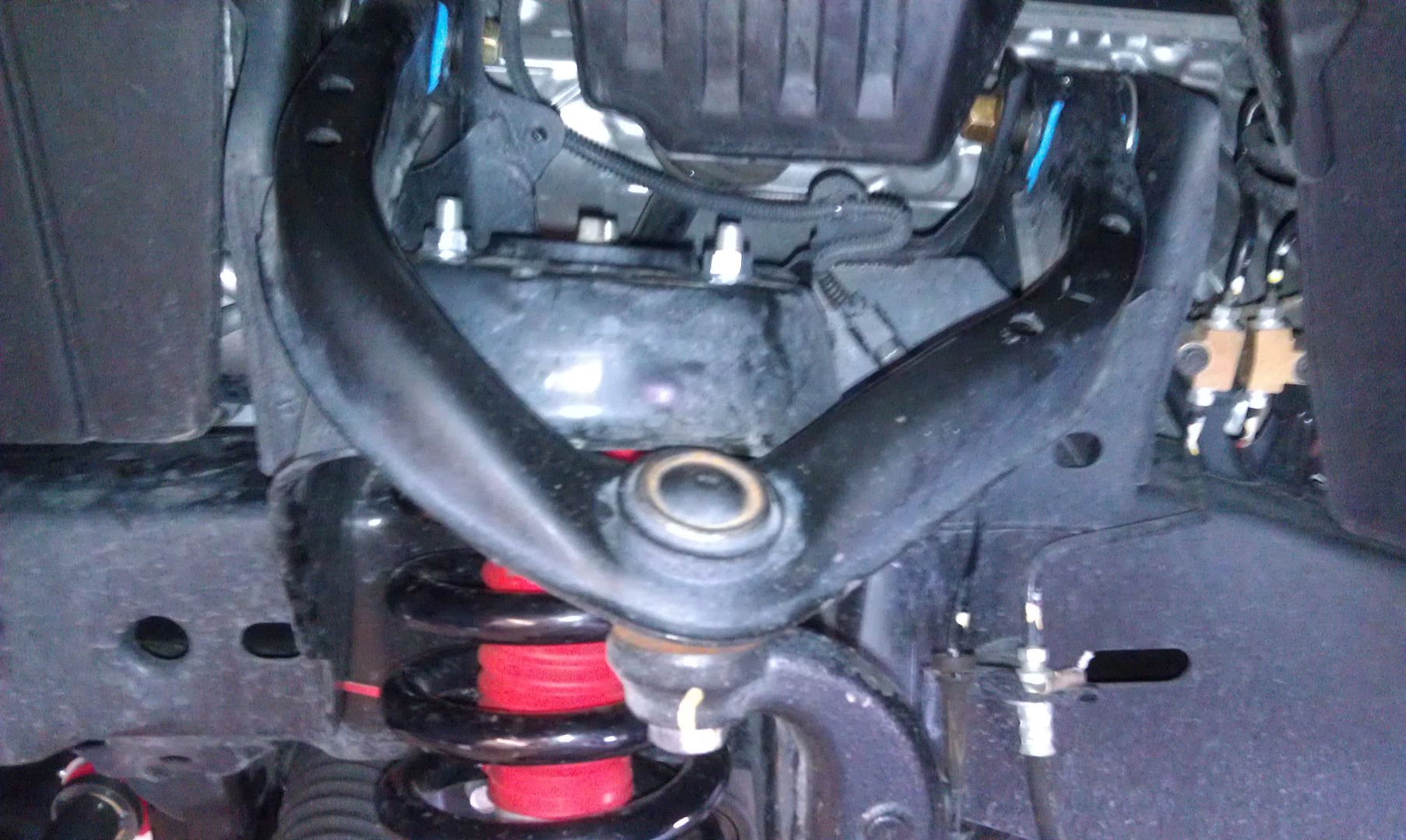

I didn't use the supplied instructions as they are pretty much worthless...
I used the frame lift at the RPM Center to make things easier.
First I removed both front tires.
Then I removed the spindle cotter pins and nuts.
I tied off the spindles to the coil spring with a dirty shop towel.
Then I removed the upper bolts and nuts on the UCAs and remove them.
I performed the above steps in reverse order with RC UCAs, and no grinding was required as per instructions. I was happy about that!
Pretty straight forward, only had one snag on the driverside where I had to remove one nut on the brake line and move it out of the way to get one of the top bolts out of the UCA. This can be seen in the pics below.
The bumpstops were super simple. I did not even have to drill out the hole to make it bigger, they were already the right size so "that was easy".
I also picked up a 1 dollar clamp from Ace Hardware for the brake line on the back axle, now I just need the E Brake bracket when Chas gets ahold of some, and that will be complete.
Front suspension is done for now! I have to say that suspension work is not my favorite thing to do but it is non the less rewarding when its complete.

Right side, NO MORE CBC!

When u installed the rc ucas did it come with a silver washer between the nut and the ball joint? An if so did u use it? I couldn't tell from your pics
Sent from my iPhone using AutoGuide.com App
2,440 Posts
Discussion Starter #17
the silver washers did come with mine but I did not use them...the threaded bolt was not long enough to accommodate them.
