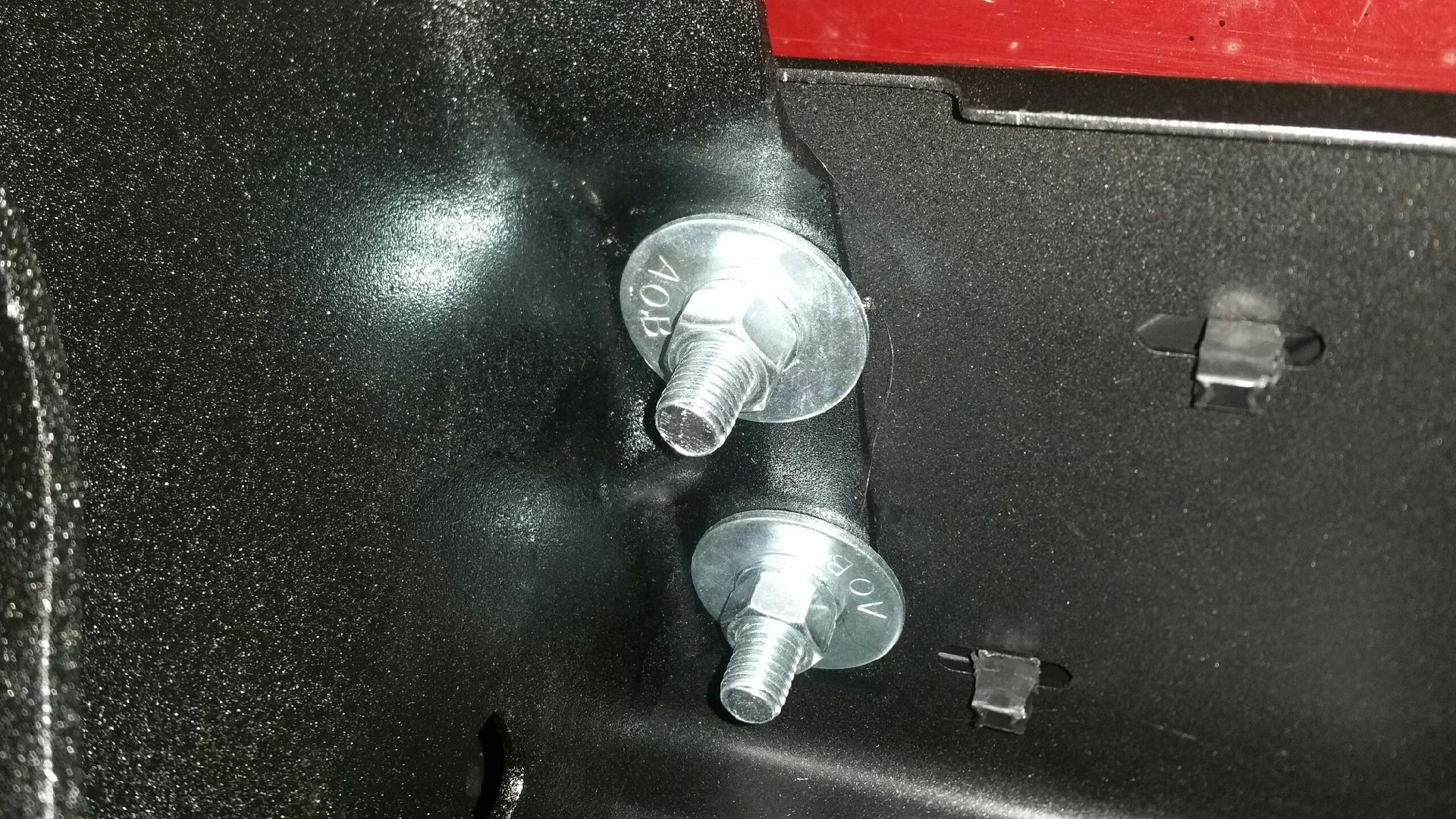

There are 6 carriage bolts that attach the bumper to the rear bumper reinforcement and I had to saw off every one of them because they just spun due to rust and being undersized. It is easier to cut off the nut rather than the carriage bolt head but you don't have a choice on the two on the bottom of the bumper. I used a grinder and a diamond blade to chop them off and then purchased 8 carriage bolts for the new bumper from HomeDepot (Everbuilt Zinc-Plated 1/2 x 1 1/2). I had to use a flat washer and a locking washer to seat the bolt properly.
REAR BUMPER ASSEMBLY
UNDERSIDE (note flat washer and locking washer)

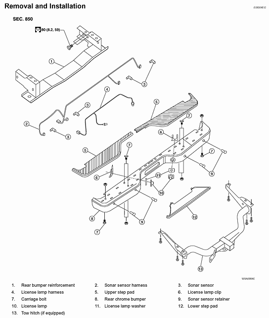

2,778 Posts
I'm assuming those are the ones labeled #7 in the drawing? Those are the ones that just spin on me as well. Thanks for the bolt sizes, maybe this coming 4 day I can get this rear bumper finally replaced!
