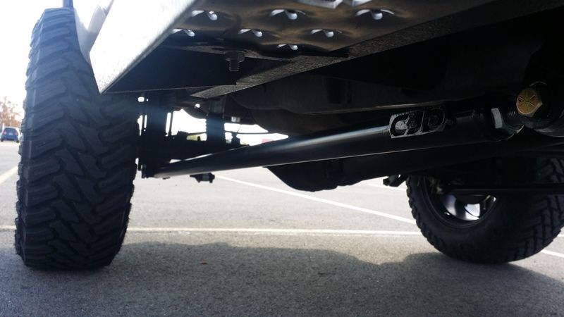

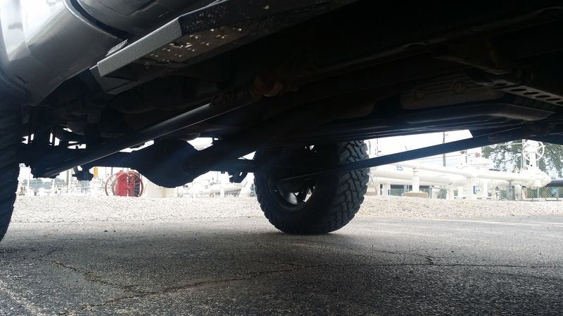

I installed the RC traction bars with PRG upgraded hiems, and mine behaves much better. Mine is not lifted, so no pinion shims needed, although I did check my driveline angles with an inclinometer when I was troubleshooting my shudder/shaking/driveline vibration issues. Check your angles, then install traction bars and pinion shim if needed. That should iron out your axle wrap issues.
you definitely need tractions bars! i was in the same boat as you with my 2wd LWB when i first installed my 8" lift. from a dead stop and just pressing the gas like normal the back end would shake/vibrate. i felt something was eventually gonna break! so for awhile there i had to ease of the gas pedal when i moved forward. after much research i invested in some traction bars. CJD to be exact as he was able to custom make mine since i'm LWB! biggest mod improvement and i love to this date!
