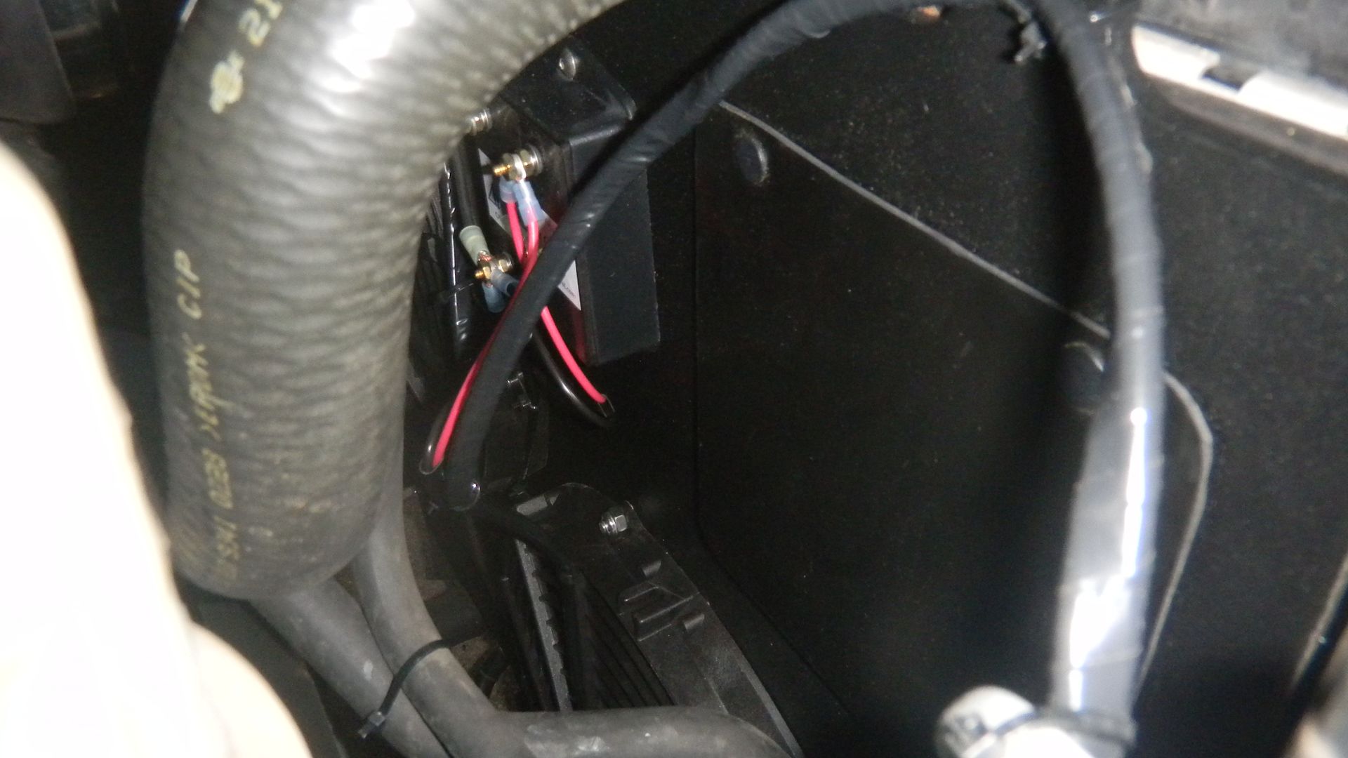

The Red is power/ Black is ground to the battery, the BROWN wire (fusible link) goes between + battery terminal and power wire. The 4 supplied allen bolts go into factory clutch fan threads in WP pulley.

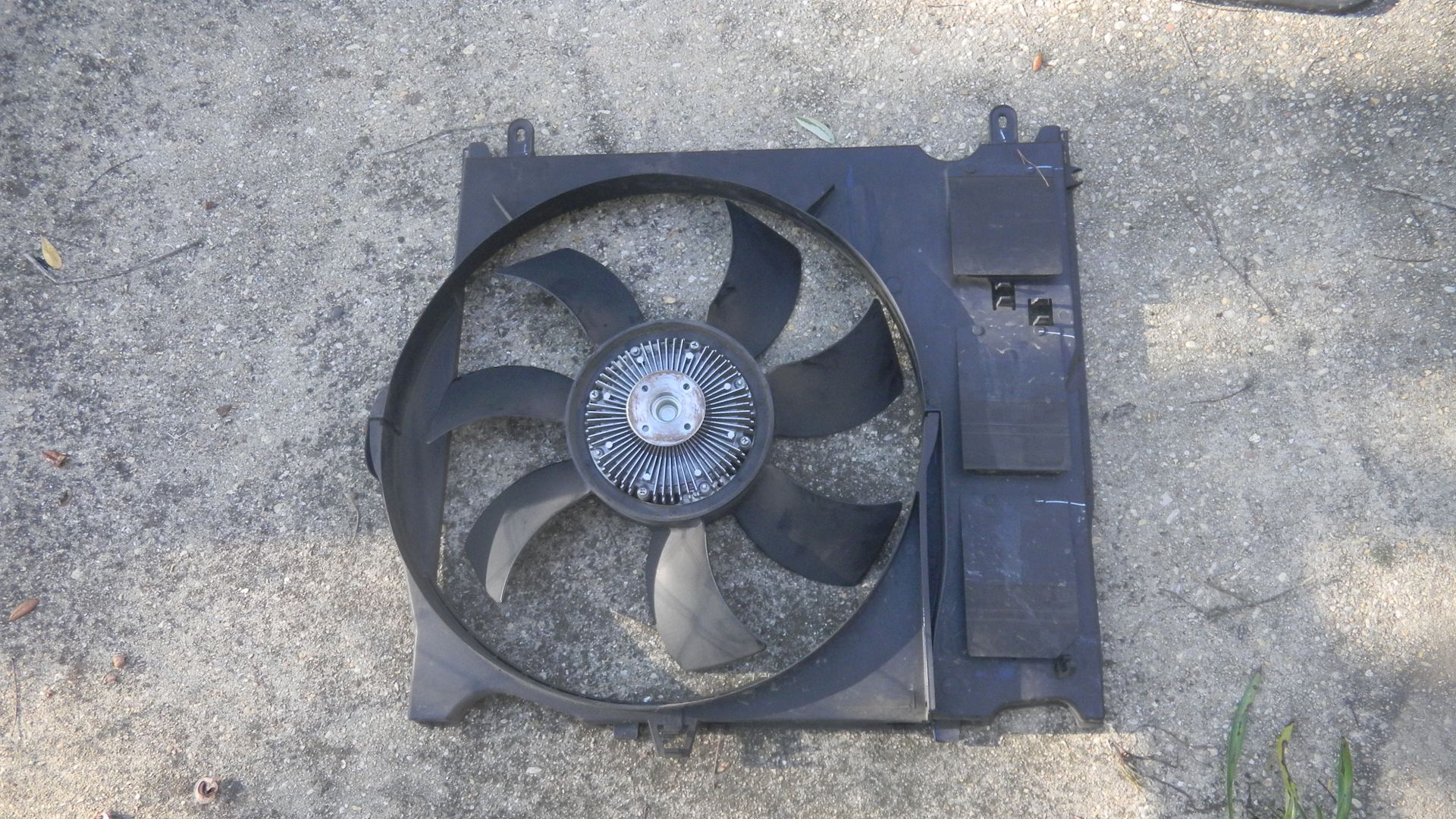

OEM Clutch Fan, POS hate you so much lol and you OEM bolts!!!

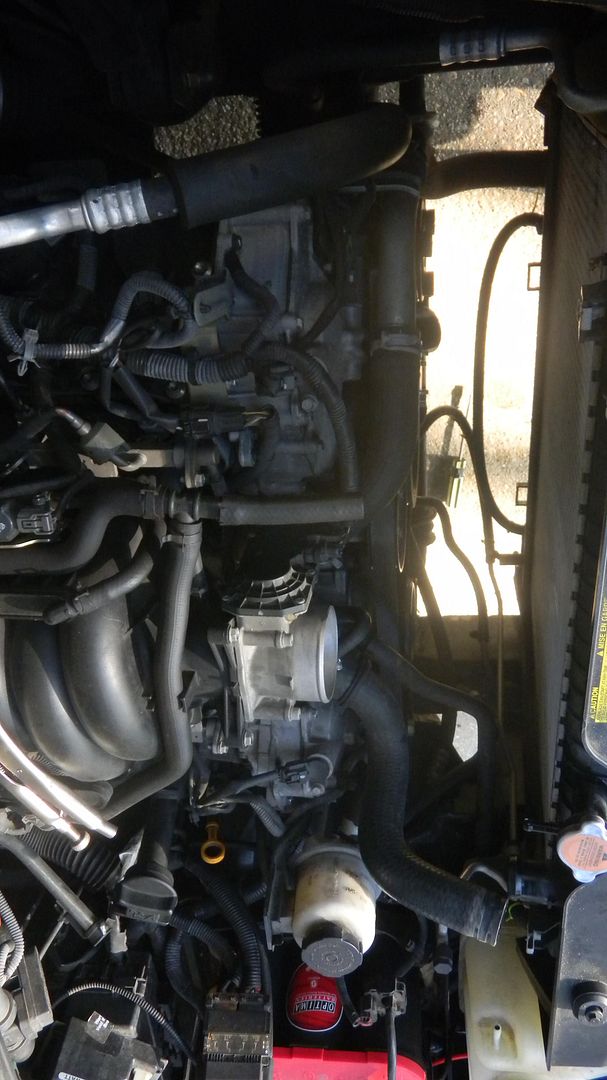

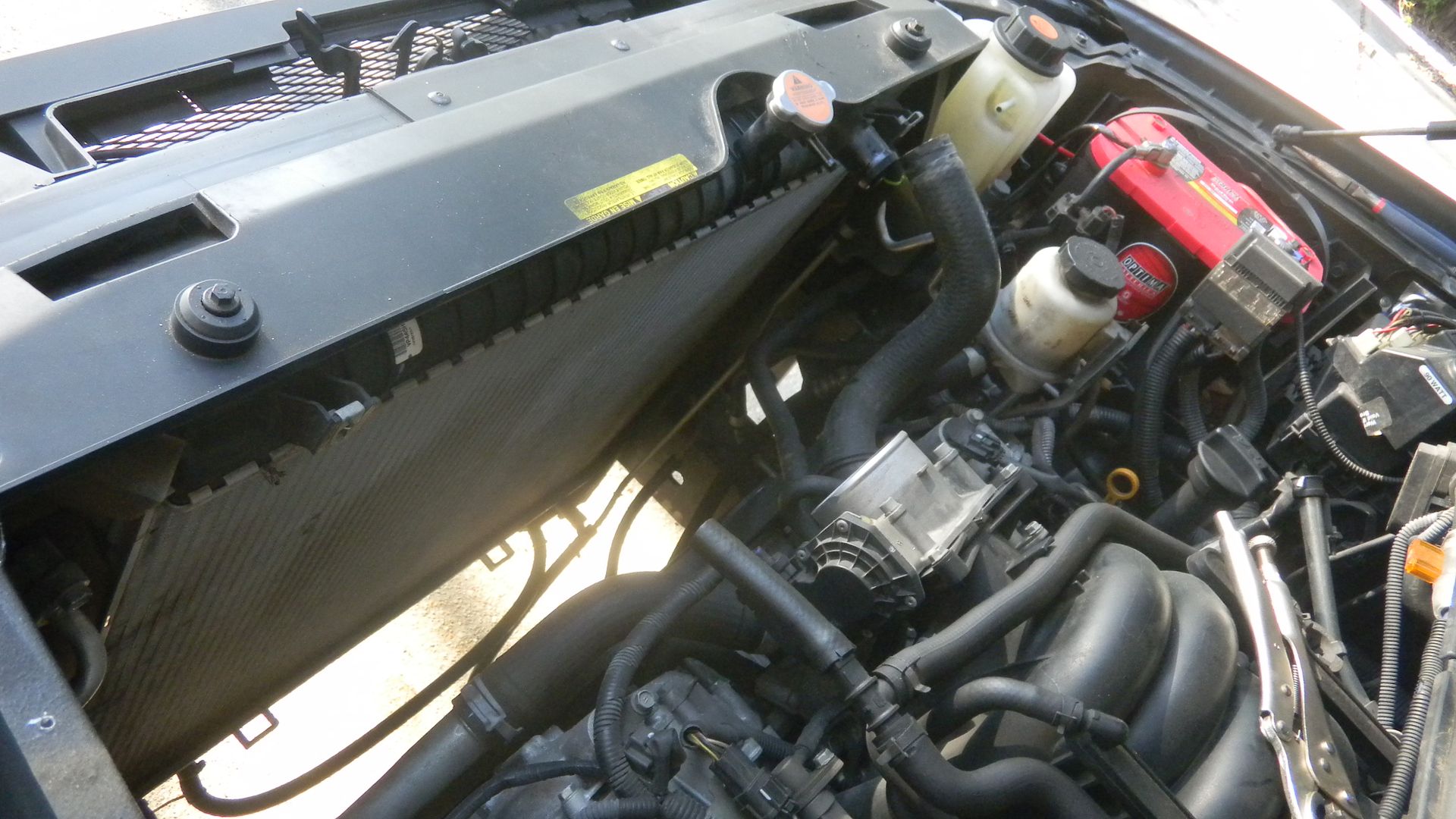

This pic shows all stock fan/shroud components removed. Note: The factory transmission cooler line on the passenger side (metal line). get to that in a min.

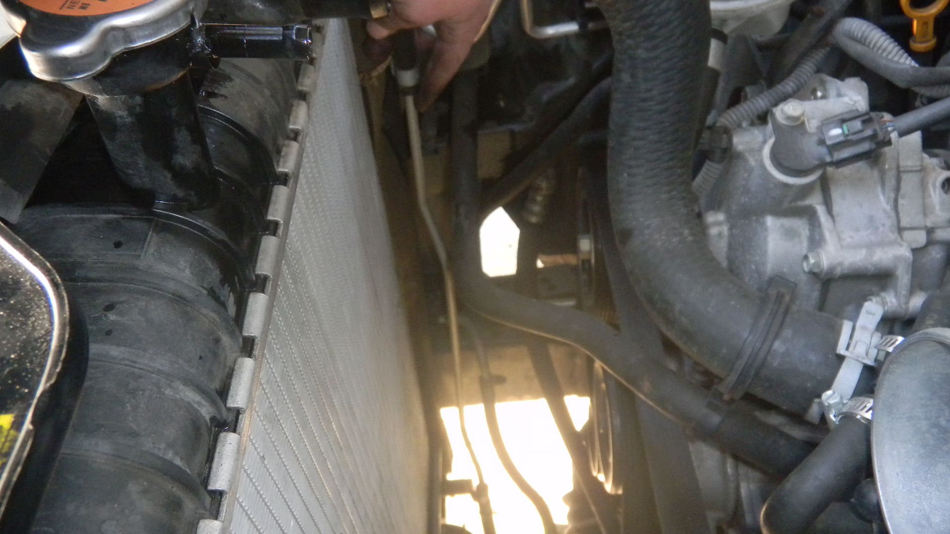

This is just showing the metal transmission line for those who are doing a Trans cooler install, just to show what it looks like and where it routes.
Top view of OEM fan/shroud removed. You get the idea lol.

Finished Installation, Top view and so on. Some may route wiring differently, but this gives an idea of tru 4in CAI distance to RP-Perf shroud.

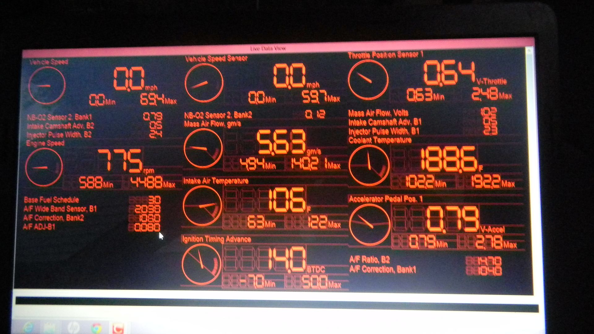

This shows Cipher Coolant temp of after a 15min drive and idle for 10mins with hood closed. Hottest was 192.2, and the fans were actually on briefly when the temp went to 188.6. They would turn on a off to keep temps around 186-188.
