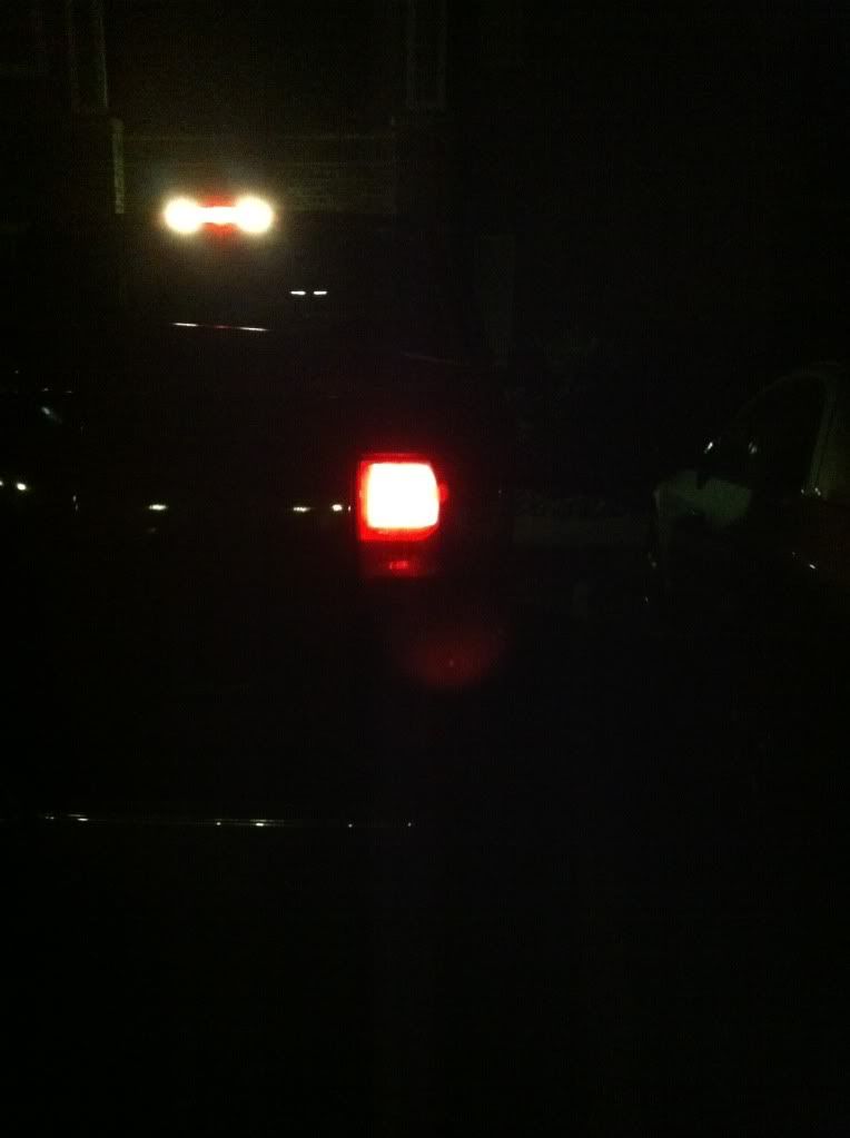

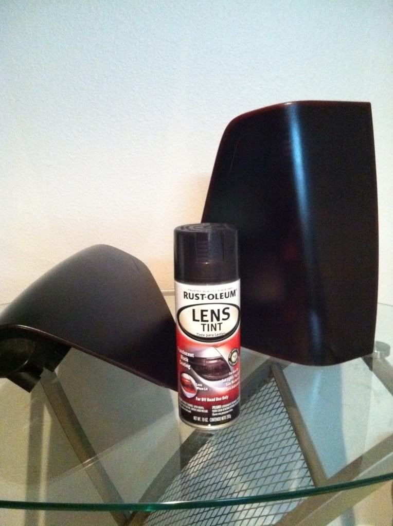

Hope this isn't too dark. I guess I could always get brighter tail light bulbs. I cannot find if there is a too dark law in the state of colorado. I would hate to get pulled over. Do you guys think this is too dark?? It may also be that it is inside and it is 1230am so maybe it'll be better in the sunlight...hope so. Or I may have to use some sort of paint thinner or mineral spirits and start over. I really like the blacked out look and I think it will look pretty [email protected] sharp on the truck. Yes, I know the bottom pic the tail light is upside down. It wouldn't stand up the other way.
EDIT: I will post some more pics tomorrow/this morning with them mounted and lights on!

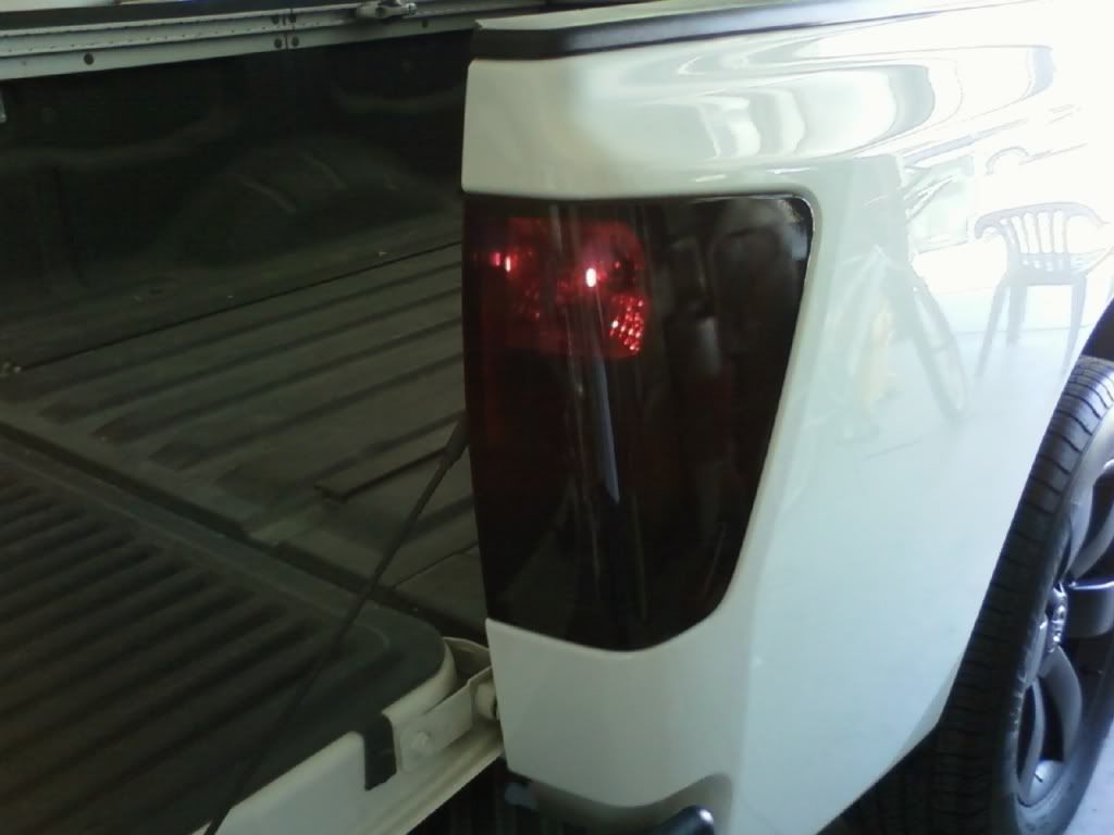

Those look to dark.. You should wet sand them and then clear coat them.. it will be less dark.. here are mine..
but I used VHT Nightshade, and some clear coat.] I did about 4 coats of the Nightshade

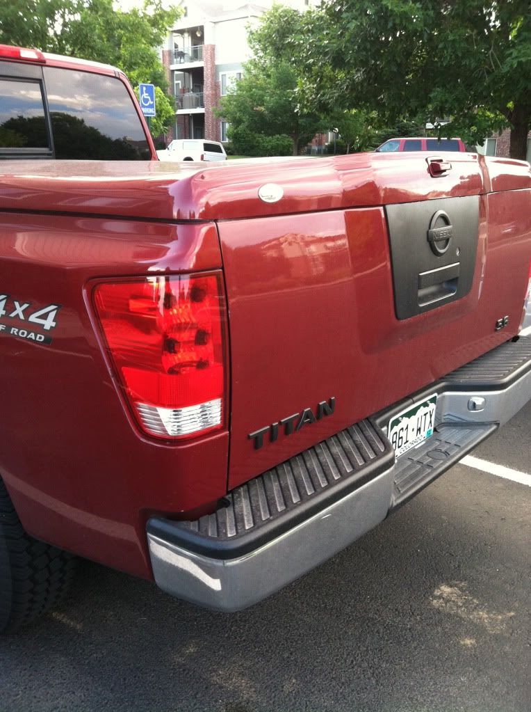

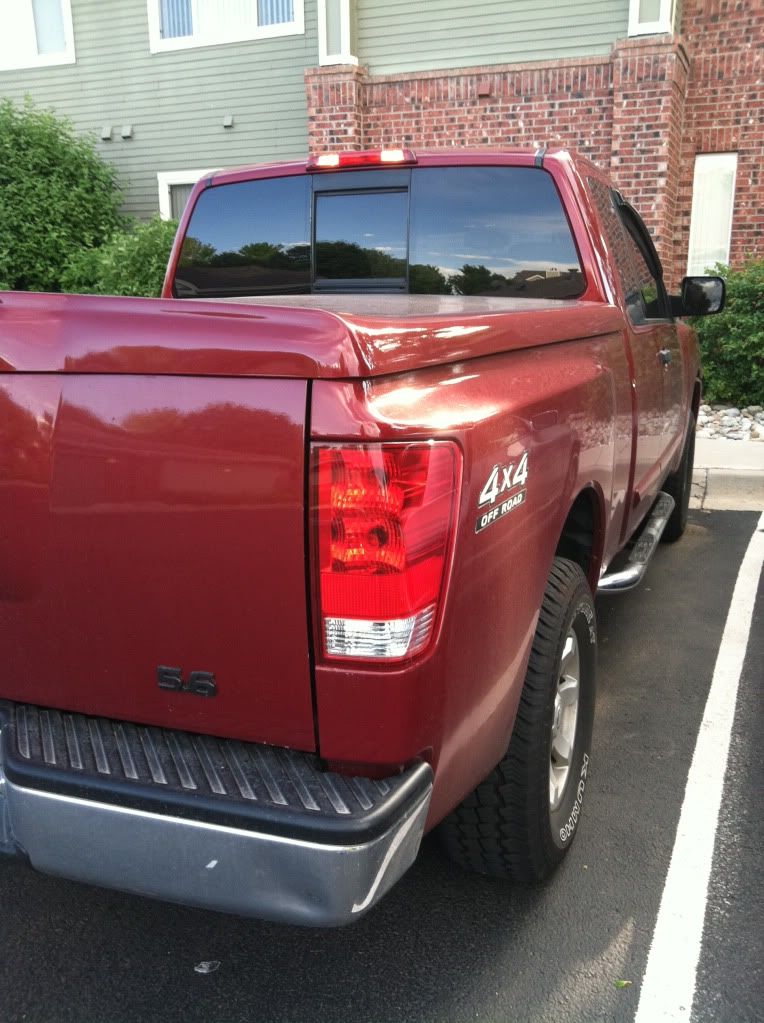

I still need to put a clear coat on them. But, I mounted them real quick since it is late and wanted to see how the light would shine through. I did not black out the 3rd brake light yet. I did find the law in CO. The tail lights need to shine red and be visible at 500 feet.
Brake lights on...
blinker in action...
That looks really good. Can you please explain wet sand them?? Do I get a fine grit sand paper wet and basically sand the dried paint then clear coat it?? Sorry...never wet sanded before. thanks! appreciate the advice and support
Just do what I do...get a spray bottle fill it with water and get ur sandpaper and spray the lights and sand away keeping it wet with the bottle..simple. Water is just used for a little more lubrication so it's not so rough

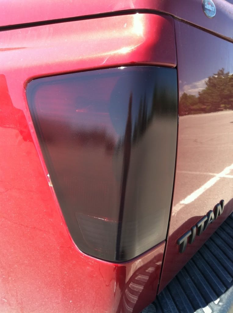

heres what mine came out like with 3 coats...ENJOI

put a few drops of dish soap in the water also will help use 1000 grit sand paper. I have also used brake fluid and Napa brake cleaner to remove paint off of plastic with good results obviously it you go this route you should test small area.
I actually used gasoline on a rag to remove that lens tint and I washed the gas off with soap and water and then repainted. Love how the 2nd time go around came out. So I am leaving it like this
Looks way better!

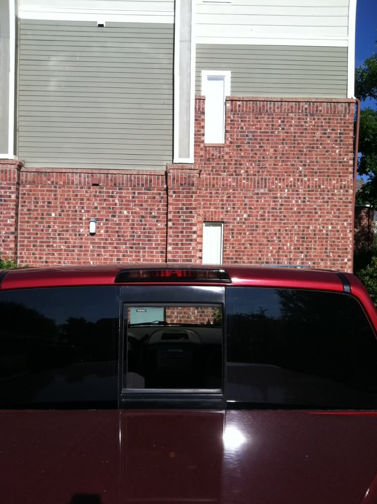

Time to tint the 3rd brake light now! I did mine tonight. I'll post a pic tomorrow. Its too dark now.
I'm happy with the 3rd brake light turn out
