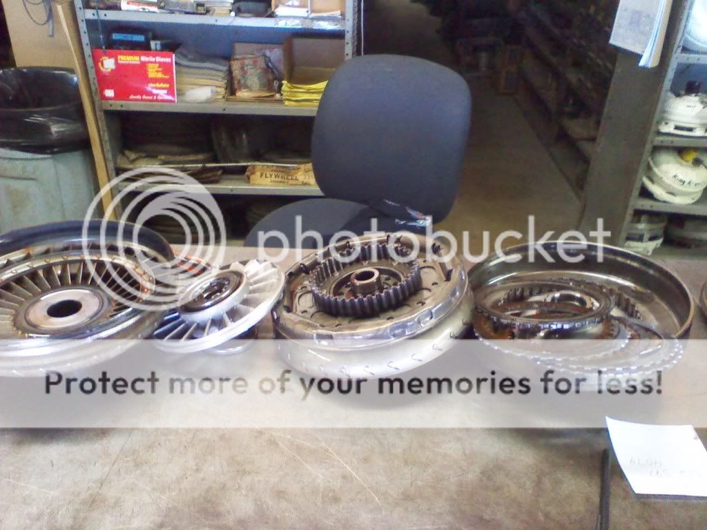

sneak peek at my transmission build

anyone care to guess what that is???? anywho i have more pics i forgot the camera at the mechanic shop LOL more to come tomorrow morning plus i have some news thatll help all titan owners trany life ;)

That would be an opened up torque converter. What gives w/the extra life info?? Cough it up already!!

i knew u knew lol its being bumped up a little bit just shy under 3300 to give me a lil more tranny life plus more grunt while taking off down the racetrack :)

initial tear- down
found the problem ;)
every ring should look brown..... looks like they burnt up to the bare metal...
back together :D
upgraded stall converter built by "xxxxxxx xxxxxxx" (you guys will know soon once i have her up and running :D)
i know i was eating refried beans theyre GOOOOOOODDD :D

Did you just up the stall, because of cams, or did the TC require a tear down anyway? Was it shuddering at all?
#18 ·
one time i felt a shudder from the tranny while i was going to the track. never knew the problem but i think it was the clutches. i wanted to open the converter up just to be safe and see if everything looked in good shape. plus bumping the stall up a little bit more will help me get going sooner with the cams :)
