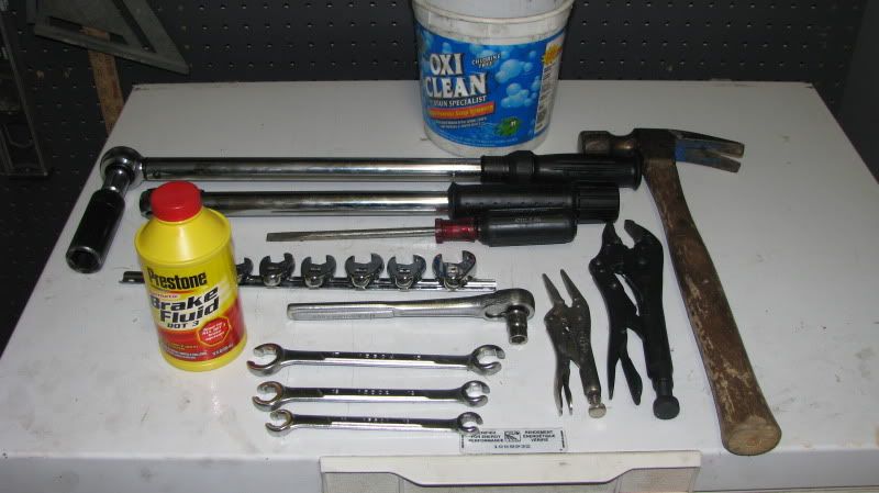

Tools needed:
Hammer
Flat head screwdriver
Vice grips
Torque wrenches ½ and 3/8 “ drive
Line wrenches (10 &12 mm)
Flare nut Crow foot socket fittings (10 & 12 mm) to torque your banjo bolts and flare nuts
Small bucket to catch brake fluid
A lot of towels, rags
Patience
Beer
An able body assistant to help bleed your brake lines and hand you tools / beer.

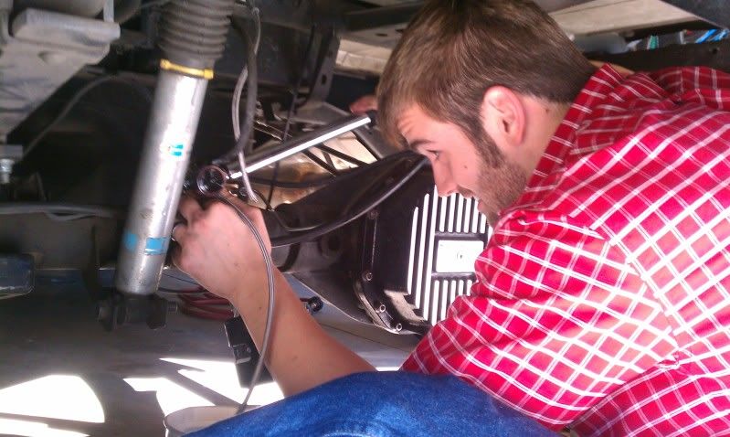

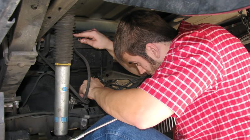

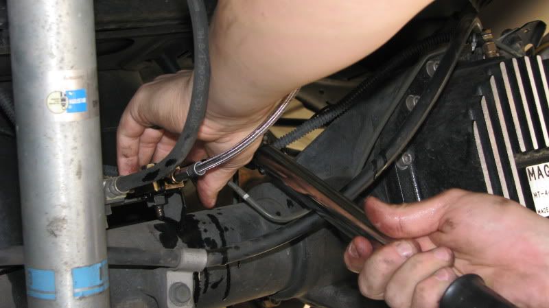

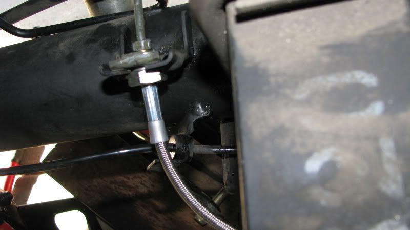

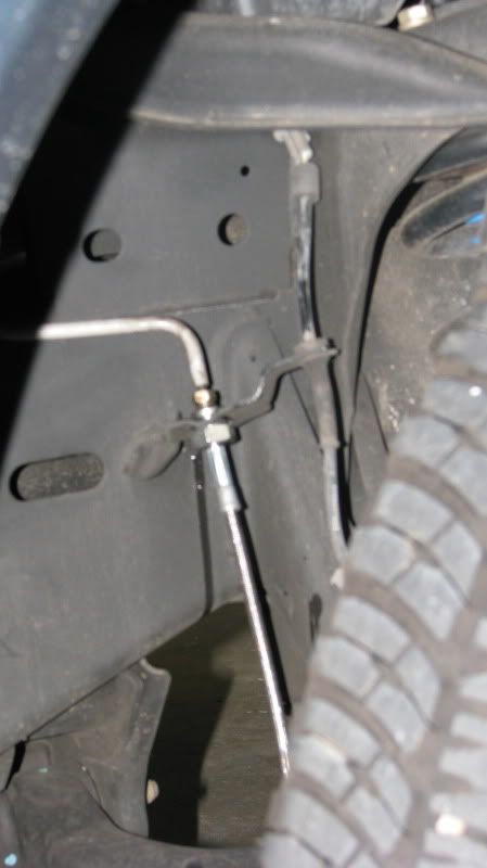

We started with the right rear wheel. Removed the wheel and spare and did this side first. Then put the wheel back on and removed the left rear wheel. After that was able to install the front lines without removing the front wheels. You gotta be nimble and with the wheel turned left/right etc. it can be done.
The flare nuts and banjo fittings are torque to 12 ft lbs. I wish I did a step by step but here are the pics with descriptions. Sorry for the lack of documentation

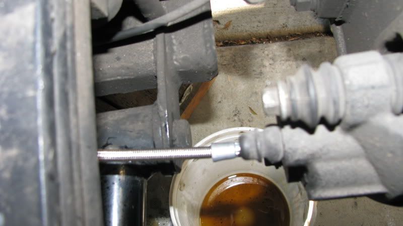

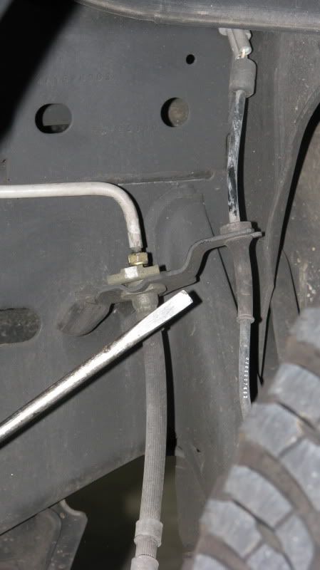

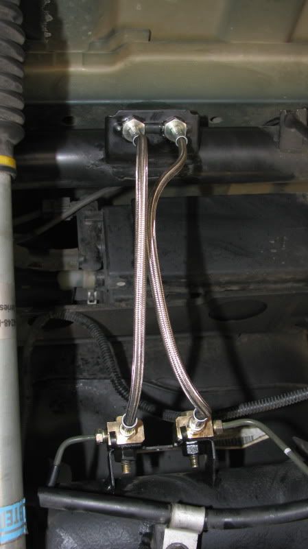

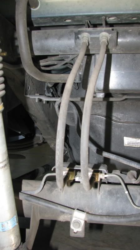

Rear lines before:

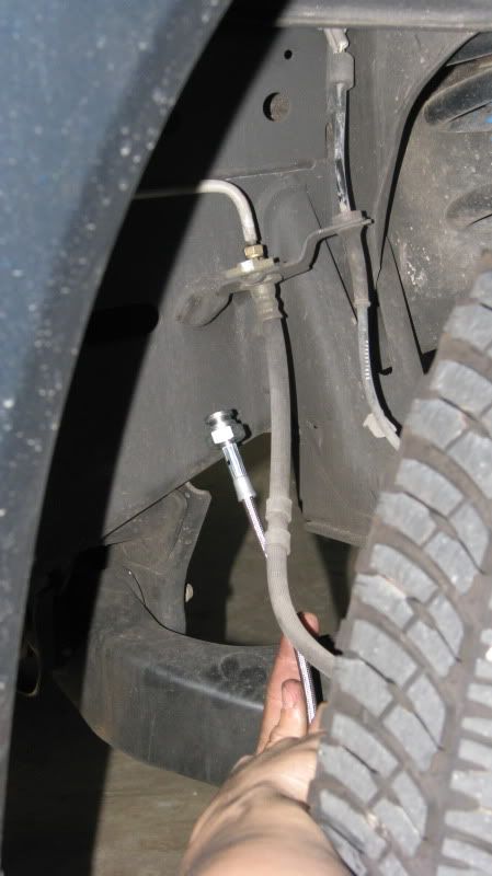

After
12 ft lbs of torque
The fronts, much easier than the rears.

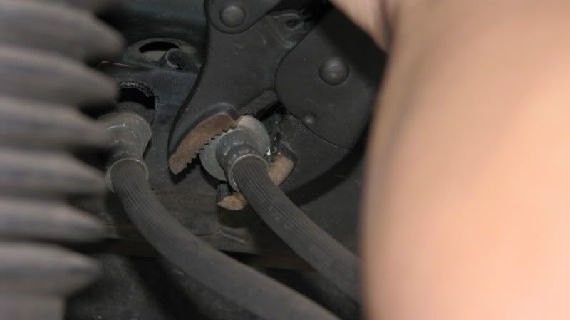

Flat head screwdriver used to pop off the retaining clips from the brake lines. We used the oem clips instead of the ones from the kit. No real difference. Also, make sure you use the new copper washers from the kit on the banjo fittings. Don’t re-use the oem washers.

It is true, if you have the dual lines from the frame at the rear down to the blocks at the axle you will need the six line kit. Here is a picture of the lines that were removed from mine, a 06 SE 2WD with no VDC.

5 or 6 lines, 2 for the front calipers, 2 for the rear calipers and 1 or 2 lines from the frame to the top of the axle.
Look under the Titan at the flex lines coming off the frame to the top of rear axle. If you have 2 rear flex lines you need the 6 line kit, if you only have 1 flex line you need the 5 line kit.
6 Line Kit
5 Line Kit

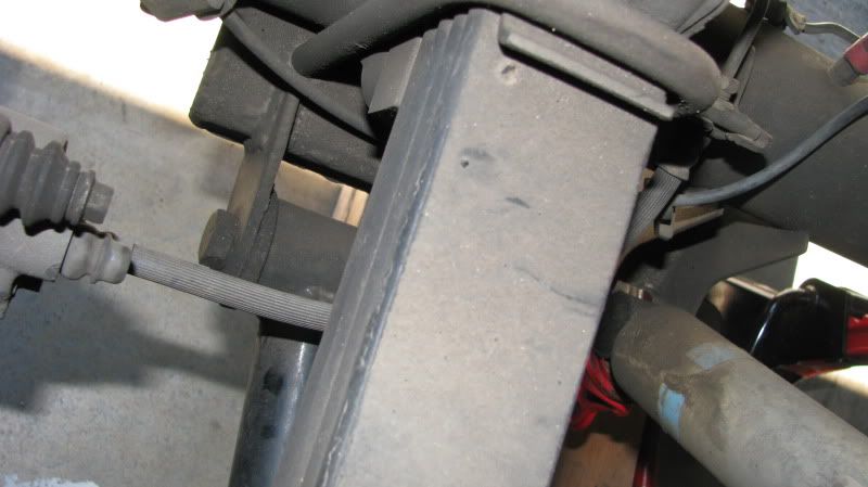

I dont get it. Why. Is it because after '05 Nissan did away with VDC as an option? Hmm. Pics?
Here's what mine look's like. Just a single line running to the rear block, where it split's to each side:
