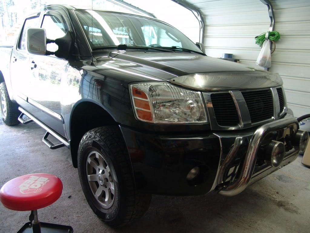

I arrived at tech12volt's place on Sunday, March 8, as planned. Due to a recent bout with a nasty virus, his whole family was under the weather that weekend, so we didn't get to the Titan until Tuesday. But she was in "The Shop" and preparations were being made.

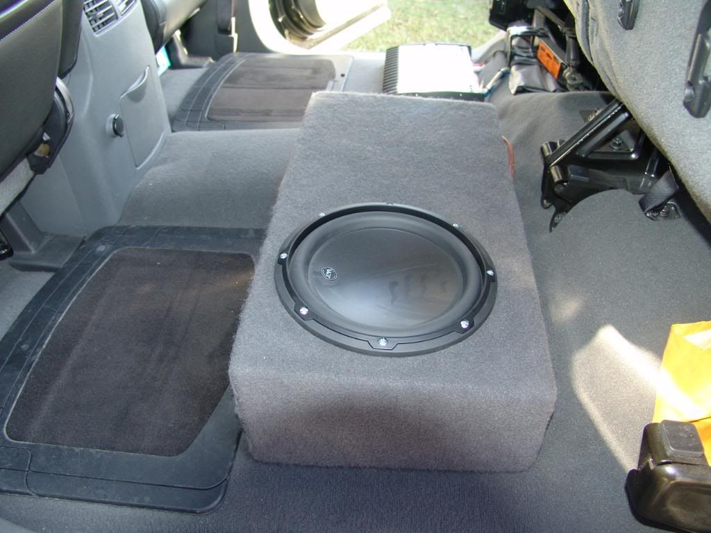

Before the installation, as you may or may not know, I had the JL Audio 300/2 amp pushing the JL 10" sub in the first sub box that tech ever raffled. I thought it sounded pretty good... Well, I didn't really know "pretty good"...

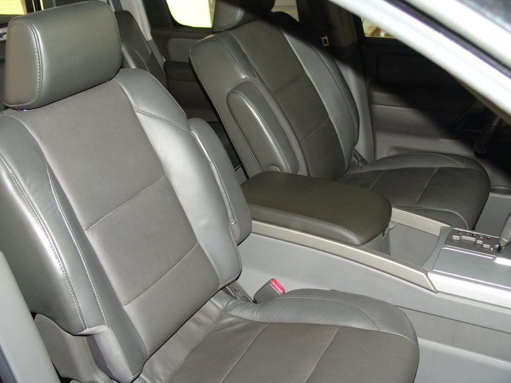

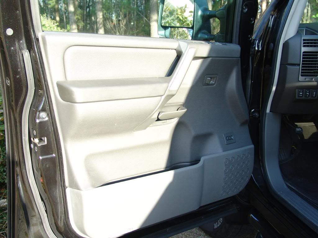

The rest of the interior was stock....

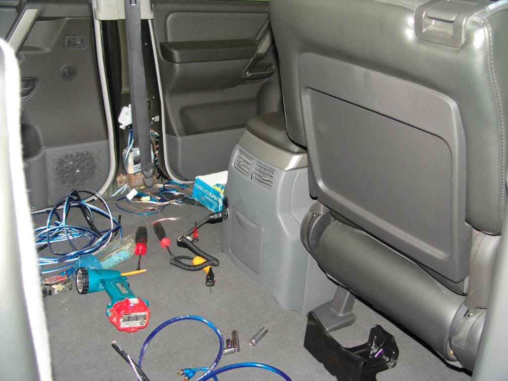

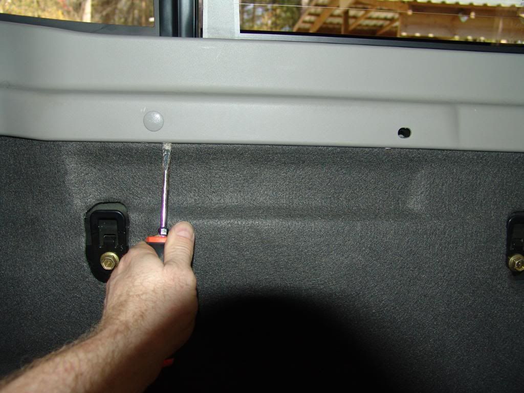

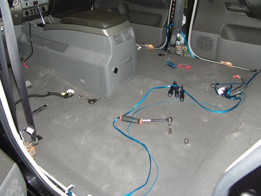

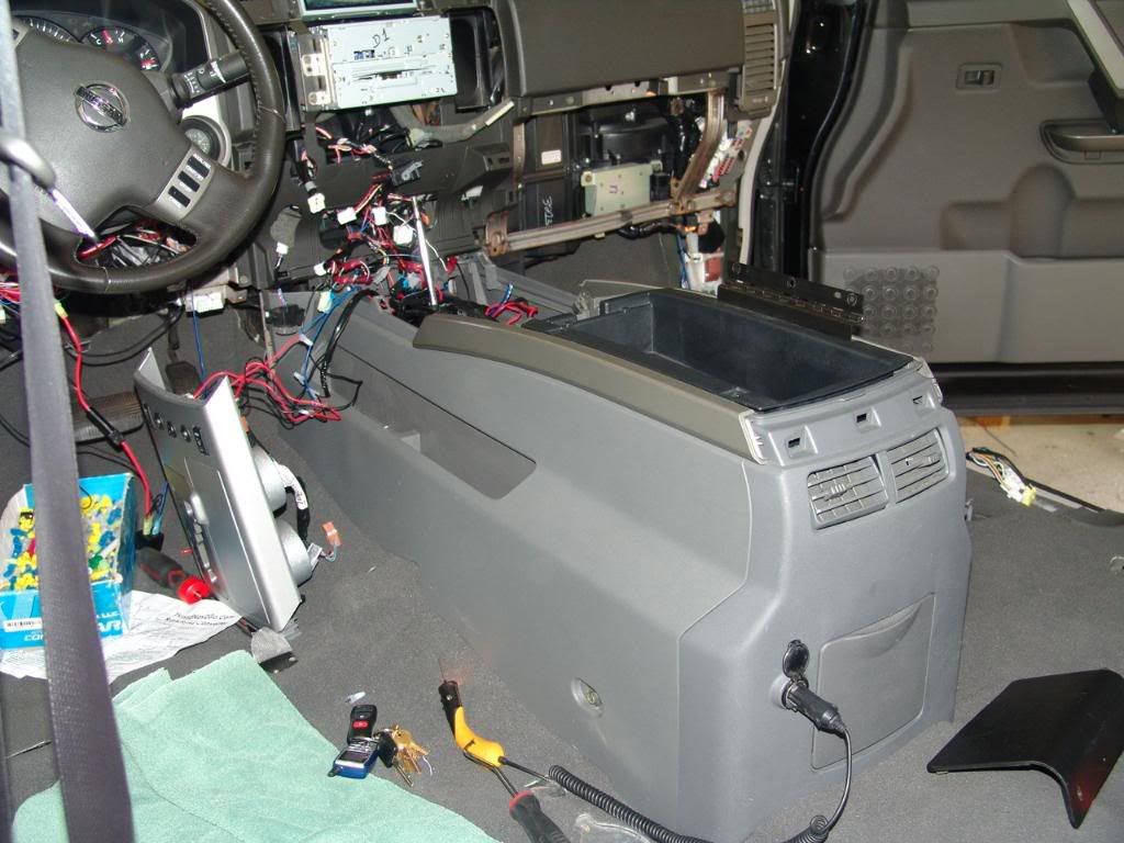

We got to tearing out the interior... Seats, trim, rear wall, but weren't really removing the carpeting yet. The plan was to just sound deaden the doors.....

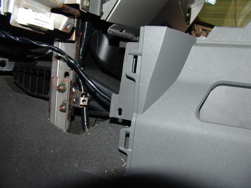

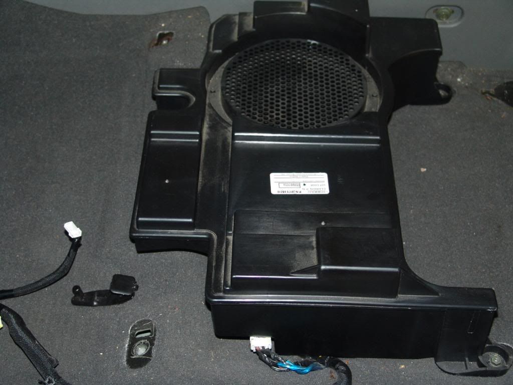

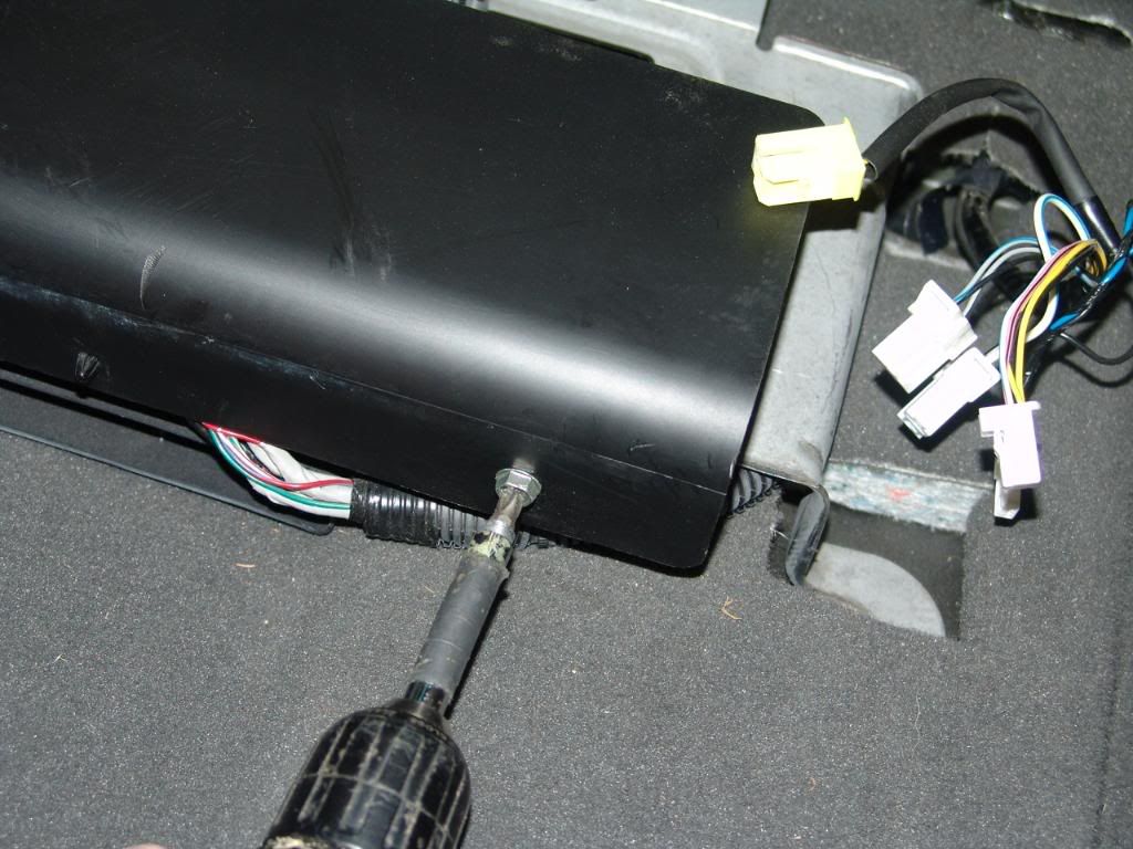

We had to remove the factory NAV DVD player under the passenger's seat as well as the factory R/F sub under the driver's seat.

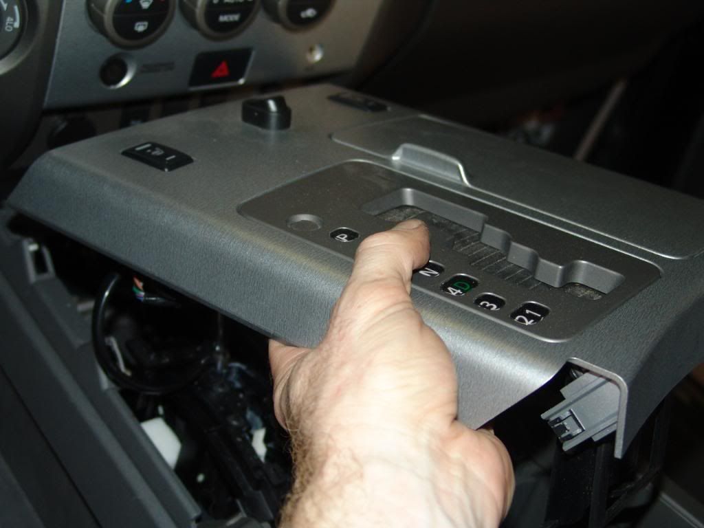

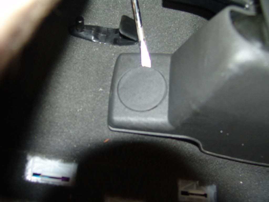

The center console cover came off, and we figured we were just about done with the teardown....

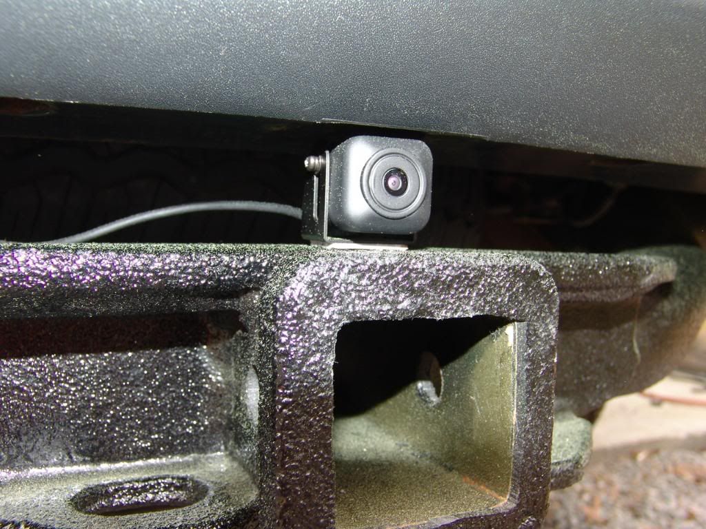

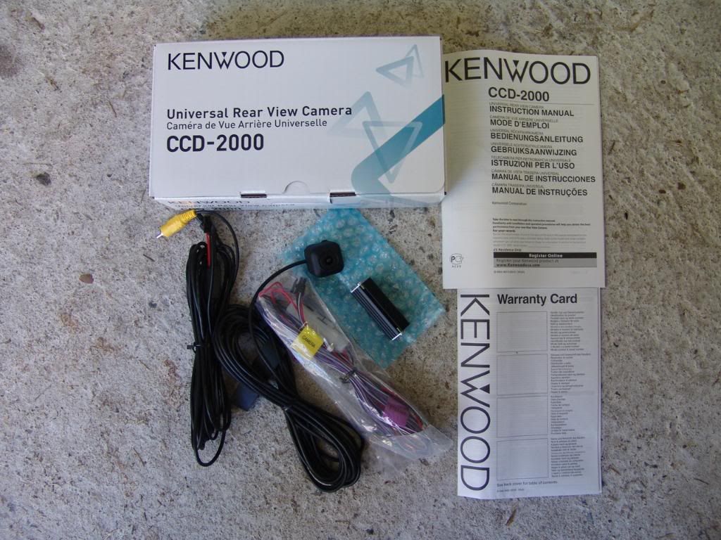

Kenwood CCD-2000 Universal Rear View Camera:

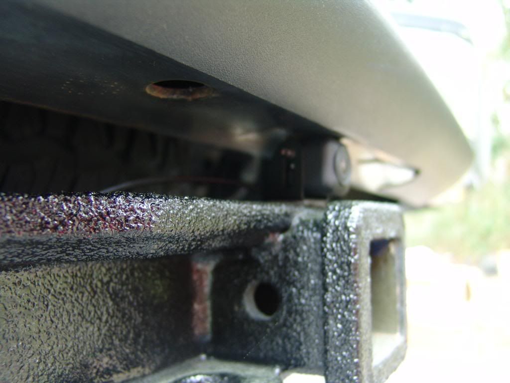

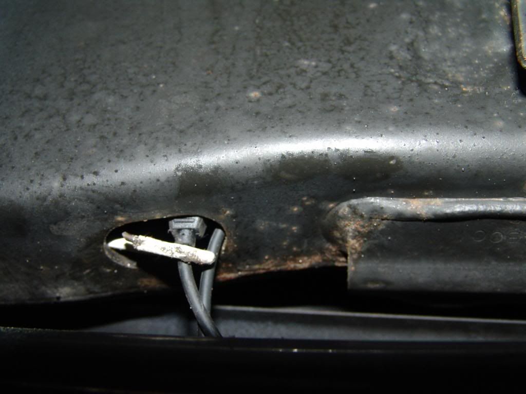

This was mounted on the rear hitch (which I had Line-X'd just prior to hitting the road to tech's place - that's Mystery Mod #2.) The wiring was run inside the frame rail under the truck.

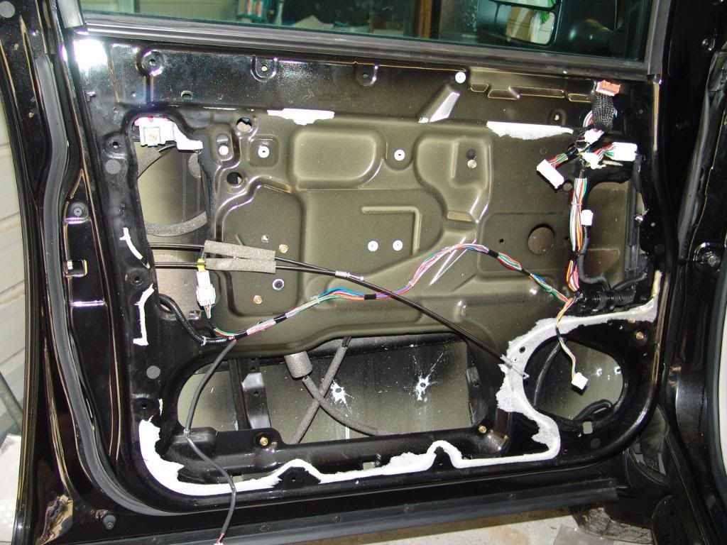

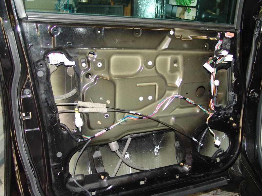

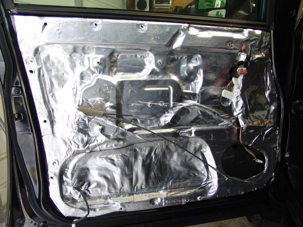

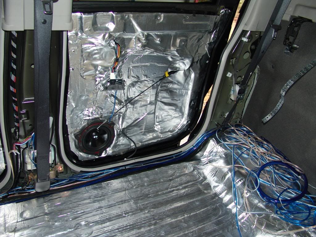

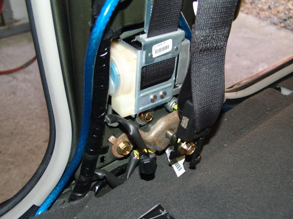

Next, the doors were stripped and they were sound deadened.

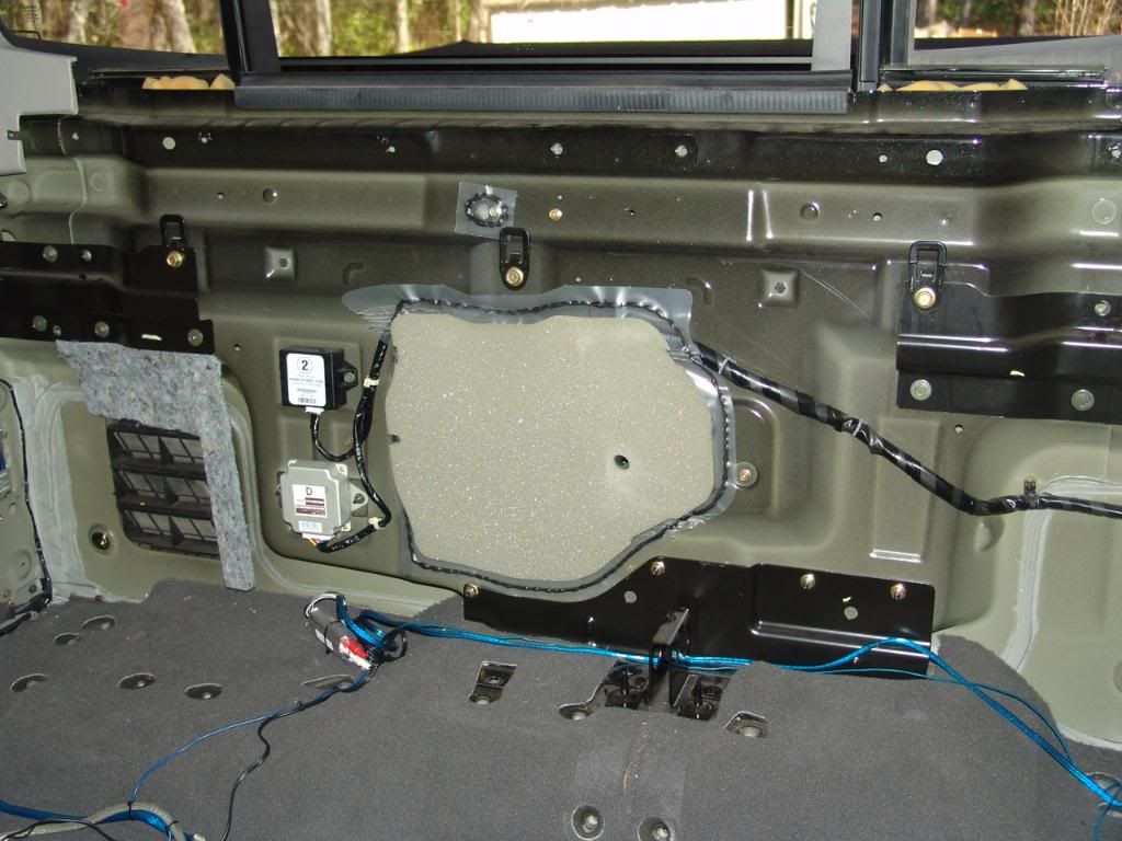

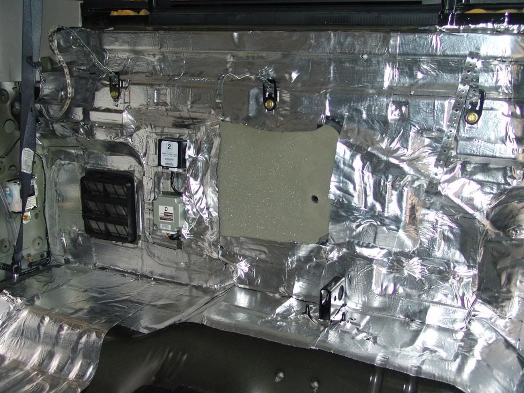

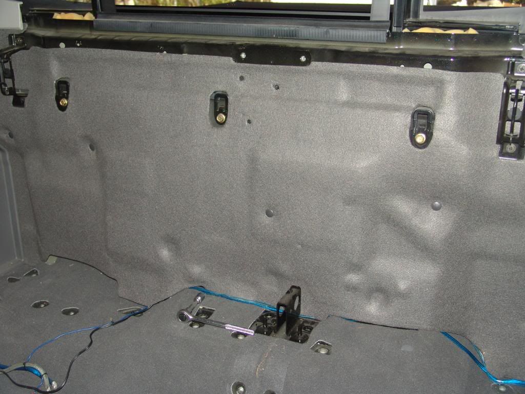

Once that was completed, the rear wall was sound deadened....

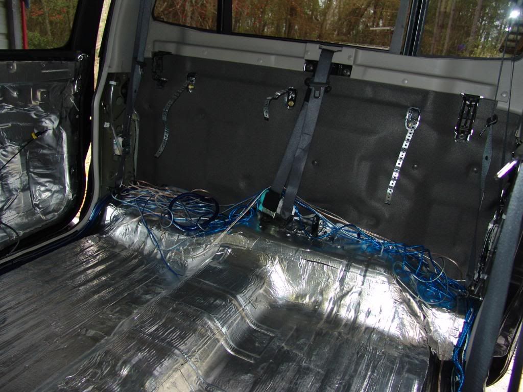

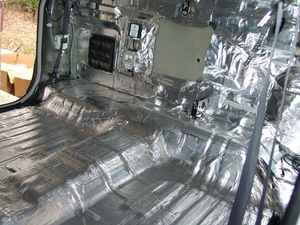

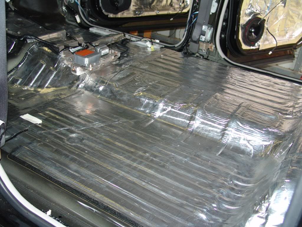

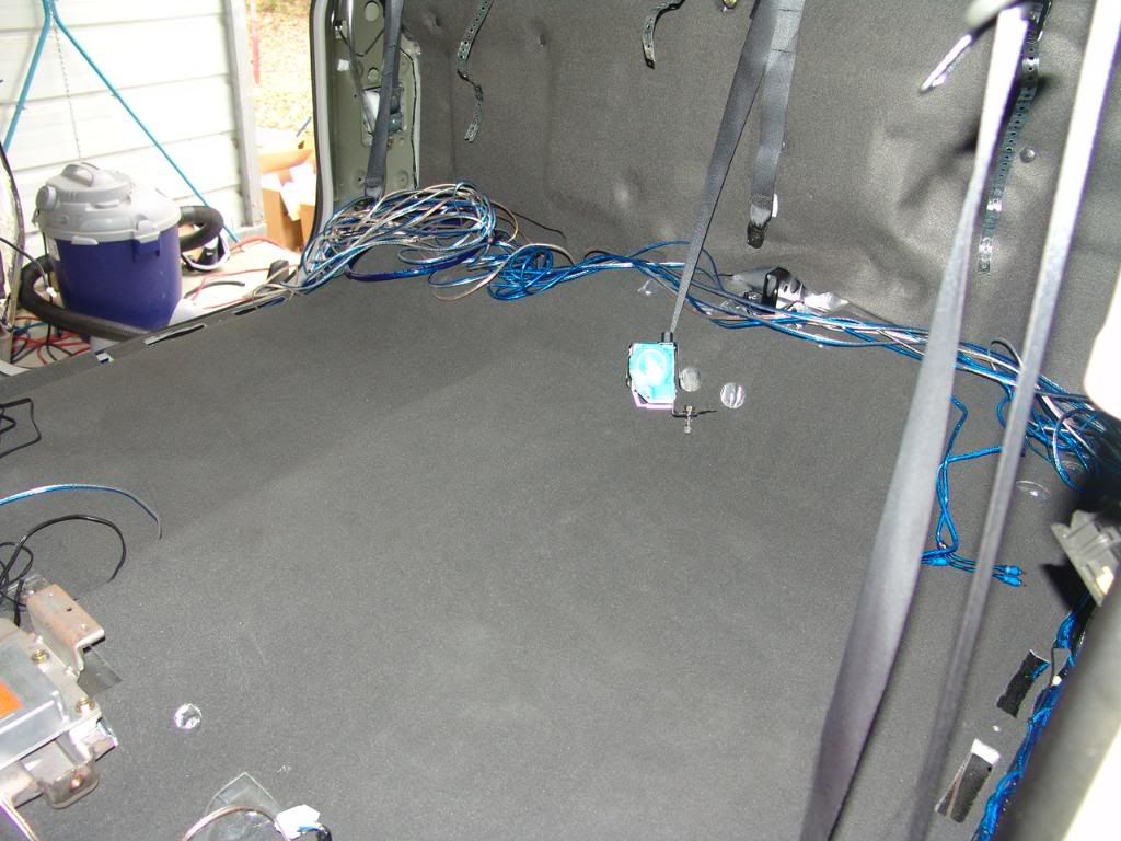

But... inspiration struck, and the thought to sound deaden the floor also, which was tossed around multiple times, finally came to fruition... So, the center console had to come out along with the carpet.
Then the floor sound deadening continued....

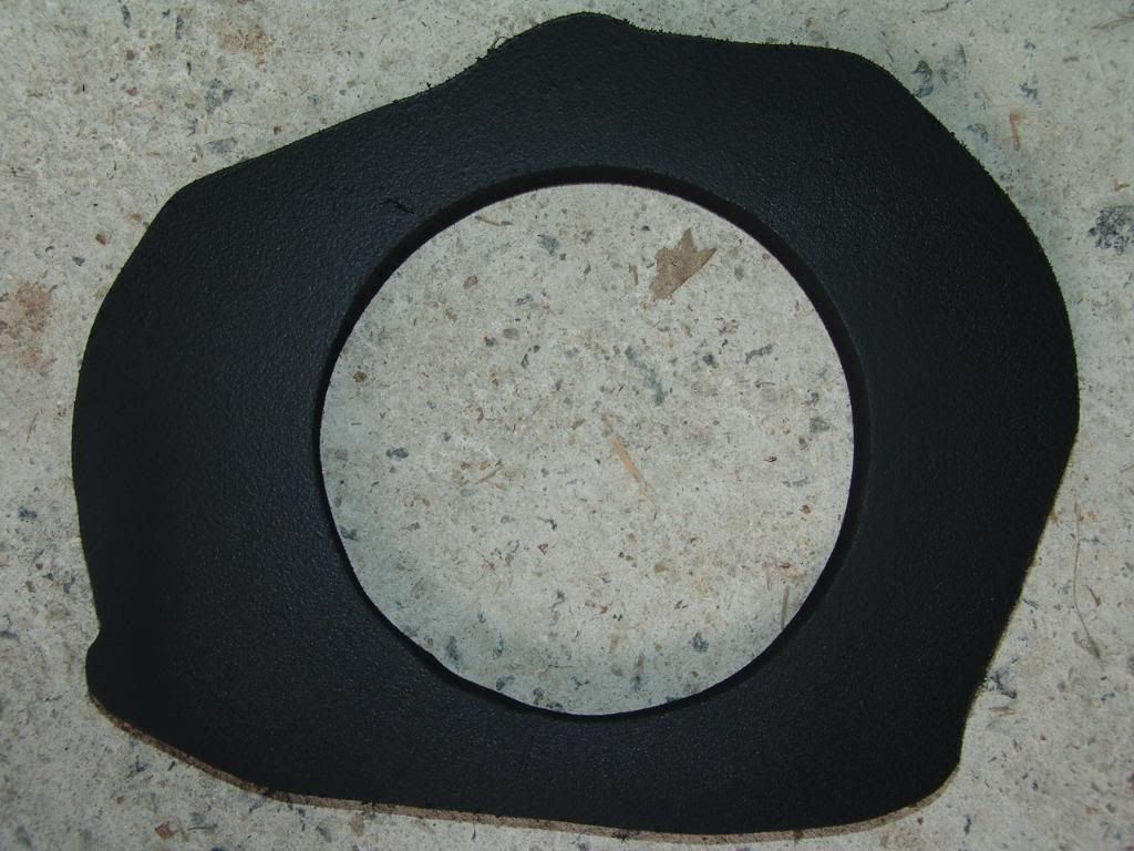

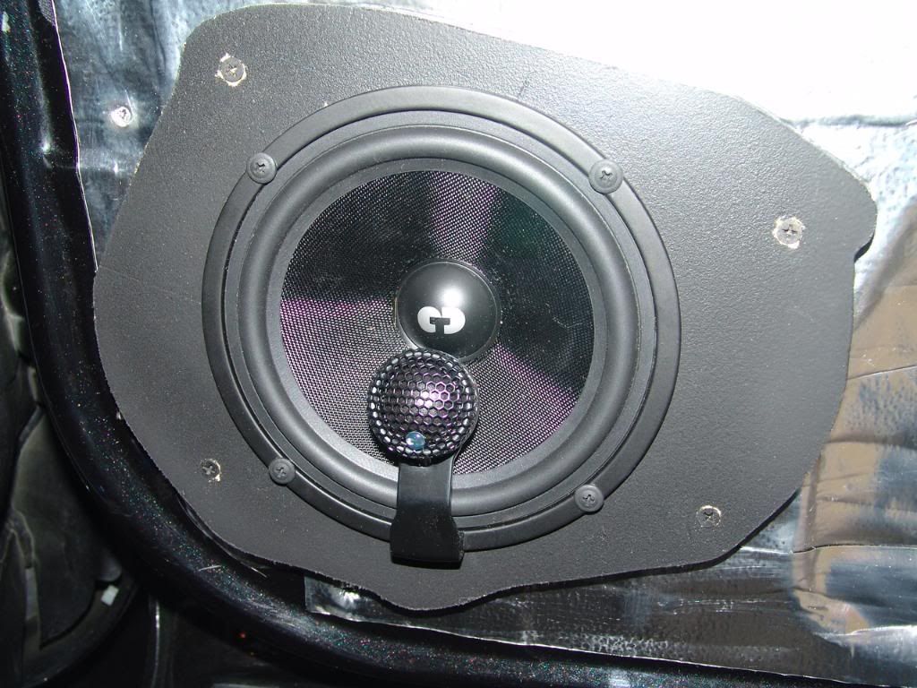

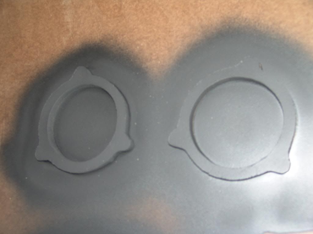

Adapters were made for the front and rear door comps. They were then covered with spray on truck bedliner to prevent the MDF from deteriorating from moisture when in the doors.

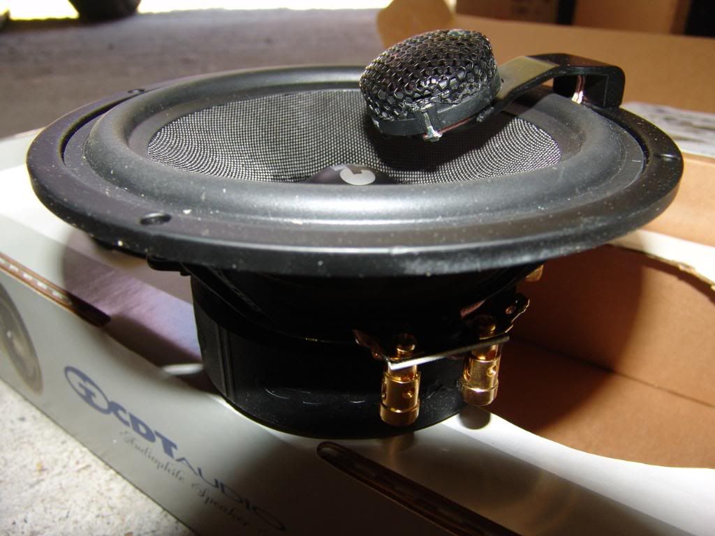

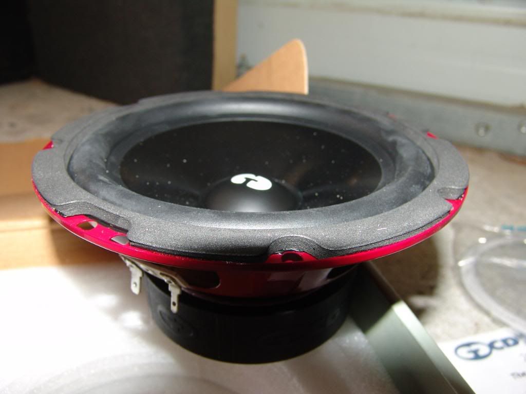

The comps installed were CDT ES-62iUS GOLD comps with the Braxial tweeter mounts for the front.

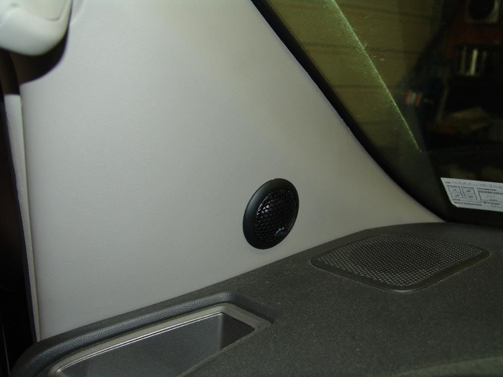

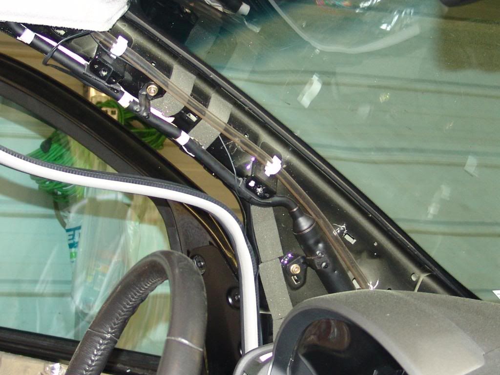

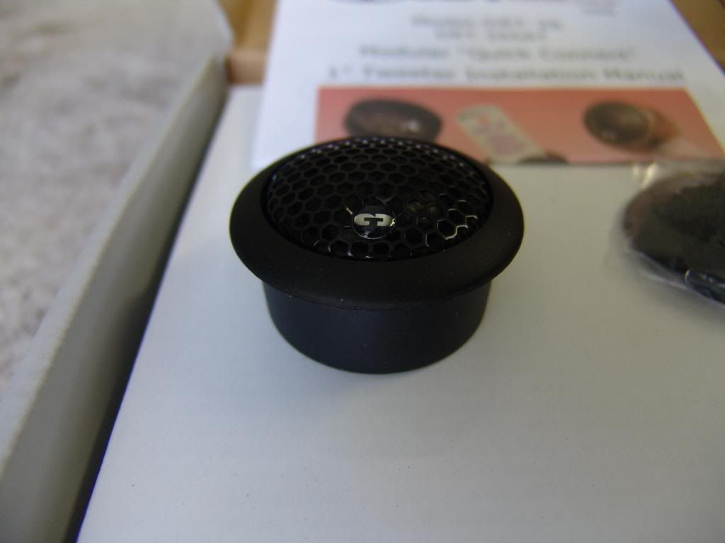

The StageFront technology was used and additional CDT DRT-26 1" tweeters were installed in the front A-pillars. This StageFront system brings the sound from down at your knees, up to the level of the top of the dashboard. You feel like you have front row seats at a concert the way the sound hits right in front of you. It's seriously, an incredible upgrade that is WELL worth the money.
The CDT CL-62 comps were installed in the rear doors since I didn't want any part of this system to be weak.

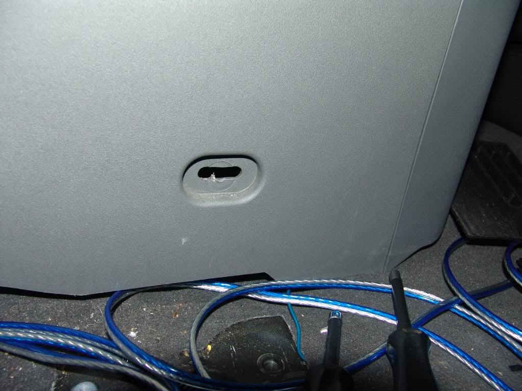

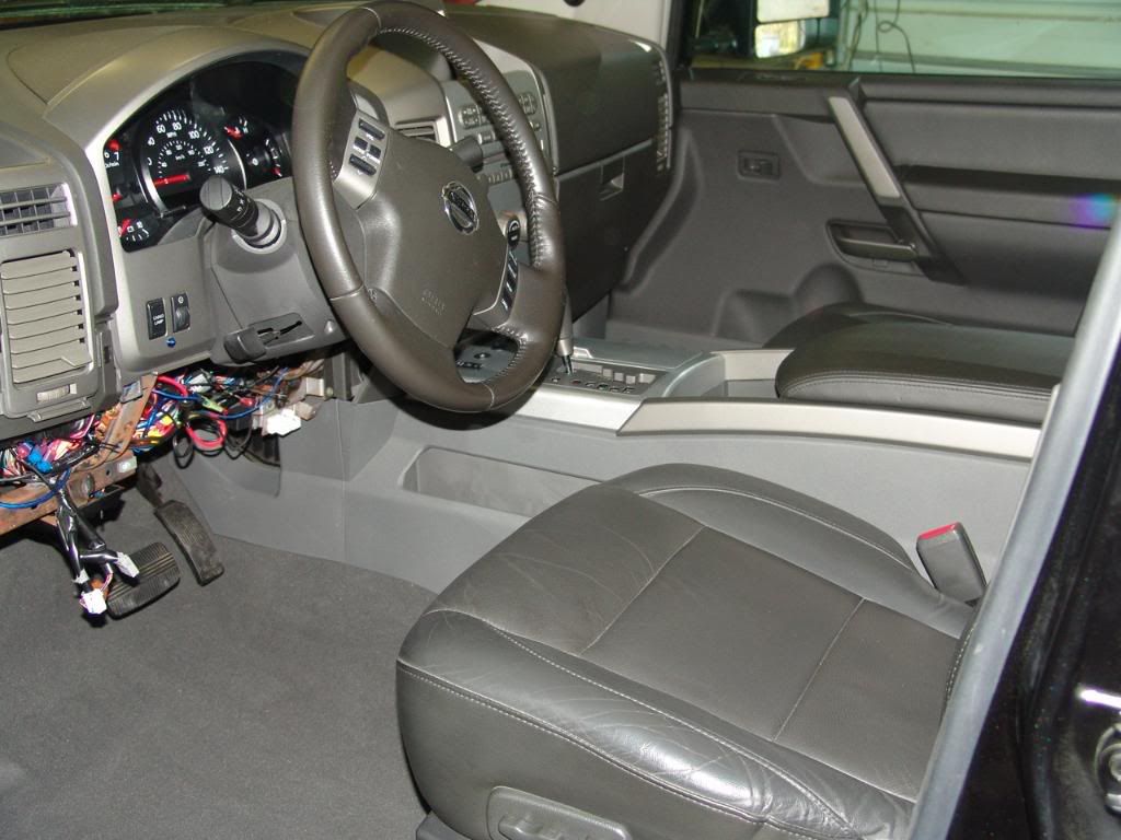

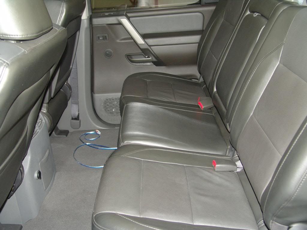

All the sound system wires were run, zip-tied, and tucked away so the carpet could be reinstalled.
That done, the interior started going back together slowly. The center console was set in place and the TVandNAV2Go was wired up and installed so I could not only have the rear backup camera on the NAV screen, but also play the movies from the factory DVD system on the NAV screen as well. These were all run through the toggle switches on the center console and in the console storage tray so I have full access to all features all the time.

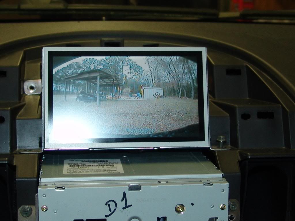

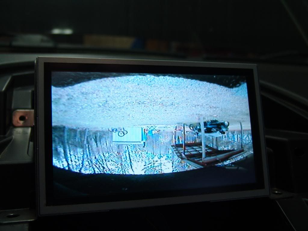

The first time we turned the backup camera on to test it... guess what....
Yup... it was upside down. :rofl: Hey... I defy anyone to be able to tell which way the camera needs to be pointed... There's no markings on it! :lol: A quick switcharoo of the camera on the mount and we were in business...

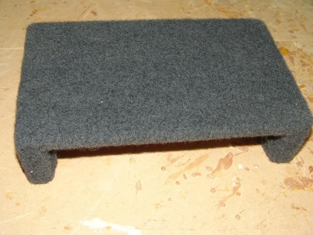

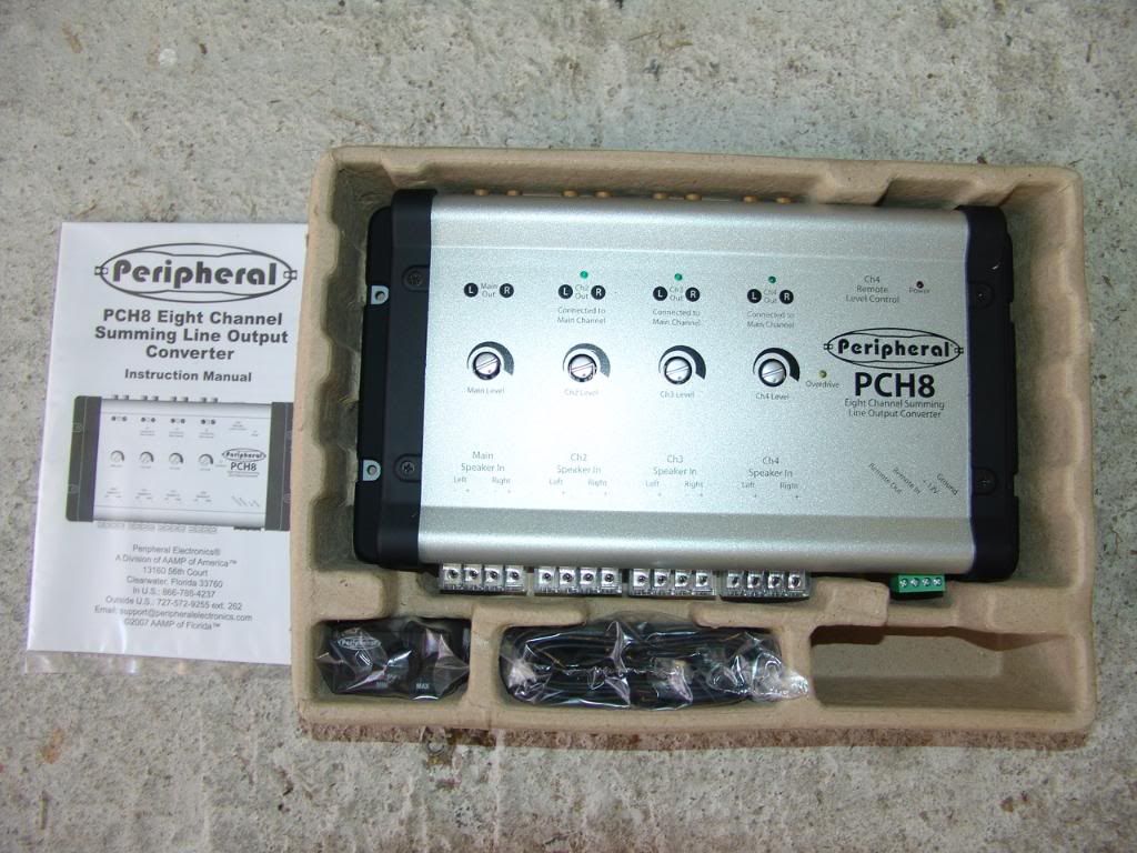

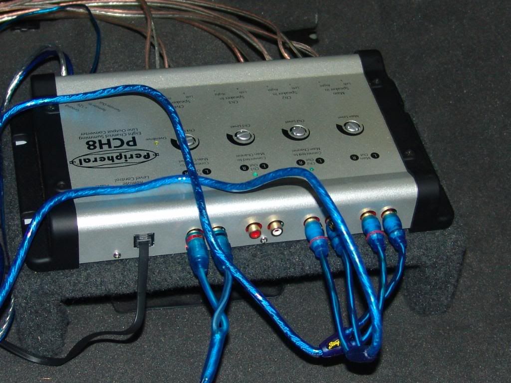

Meanwhile, a small pedestal was made for the controls... Peripheral's PCH8 8-Channel Line Out Converter was chosen to push the signal from the stock headunit (That's right! This system sounds THIS incredible with the STOCK R/F HEADUNIT!) to the amps and control all the speakers.

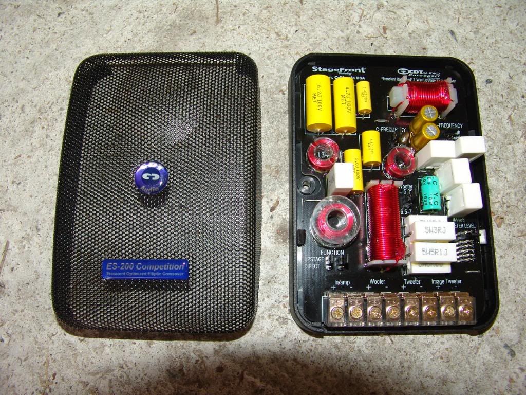

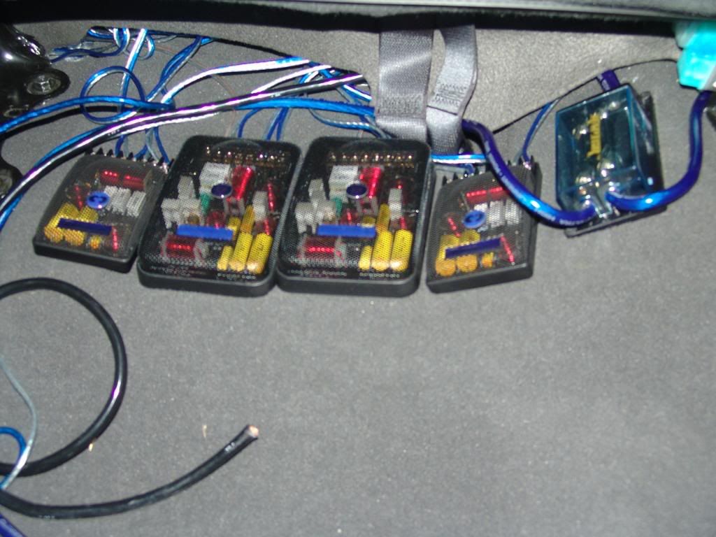

The front comps run through the CDT StageFront ES-200US Crossovers while the rear comps run through the CDT EX-480 Crossovers. These are all mounted under the passenger rear seat.

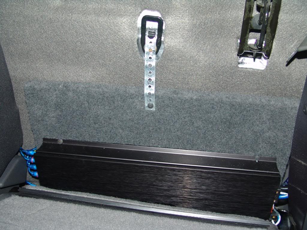

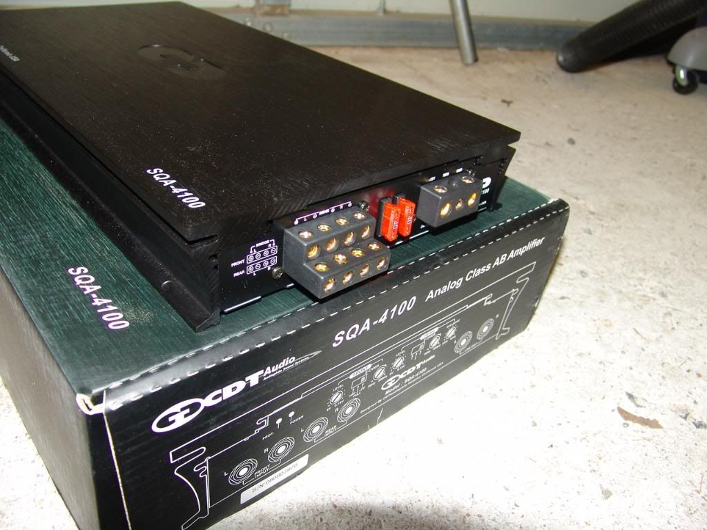

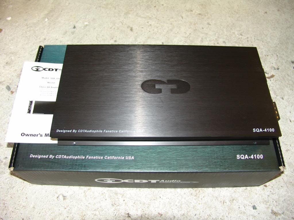

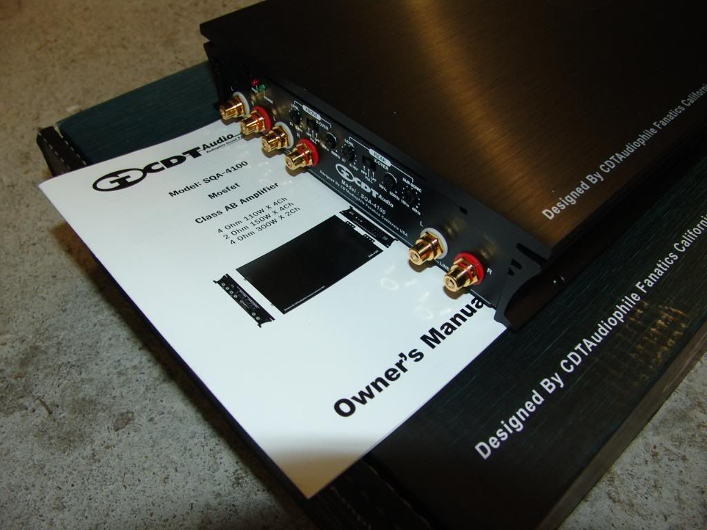

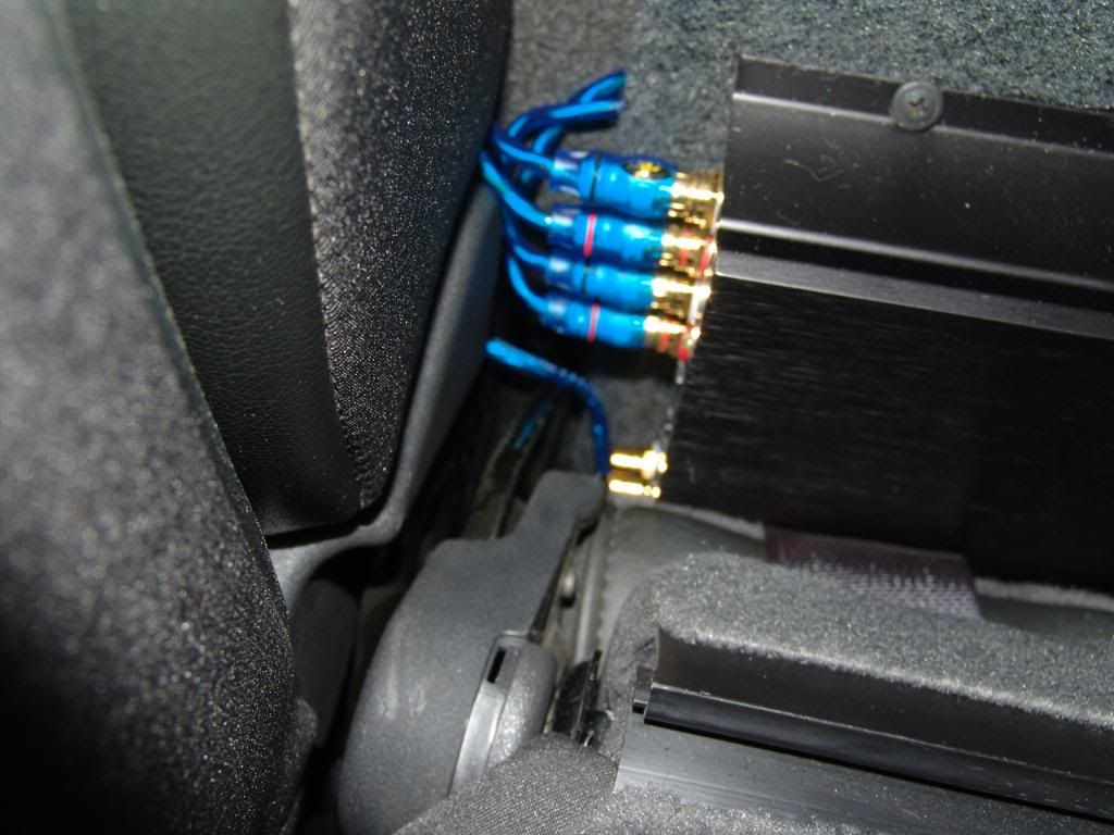

Powering the subs and comps are the CDT SQA-4100 Amps. These sleek beauties can push 110W x 4Ch, 150W x 4Ch, or 300W x 2Ch depending on your setup and what you need. They were mounted to some amp racks hidden behind the rear seats. As usual, tech did a masterful job of carpeting the support for the PCH8 and the amps.

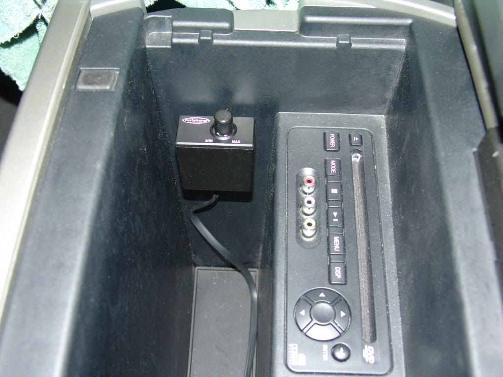

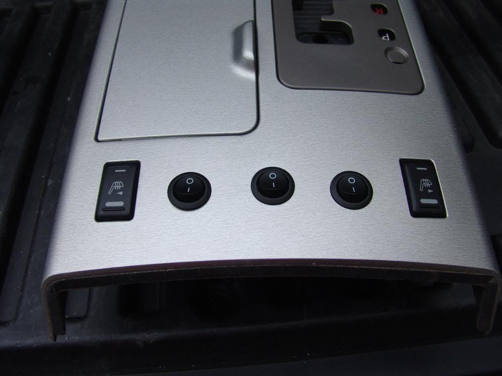

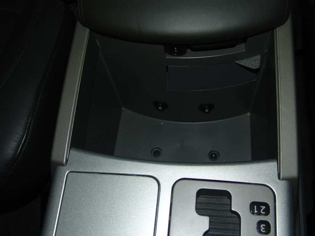

Once all buttoned up, the sub control switch was mounted inside the center console, within easy reach for instant sound adjustments.

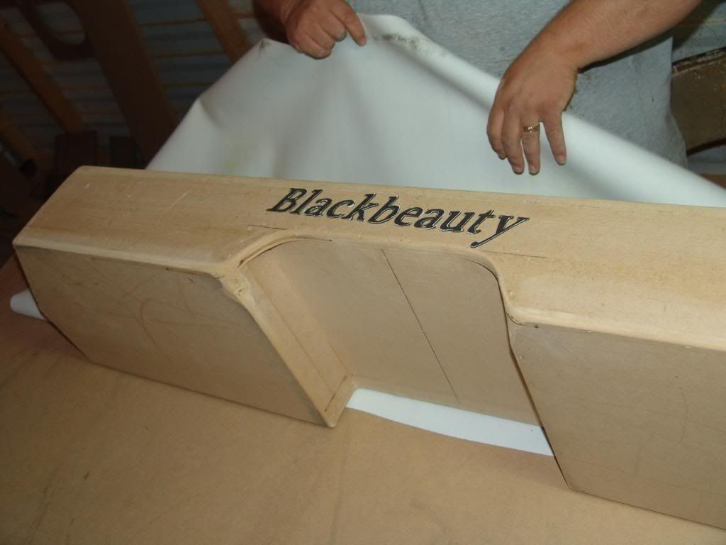

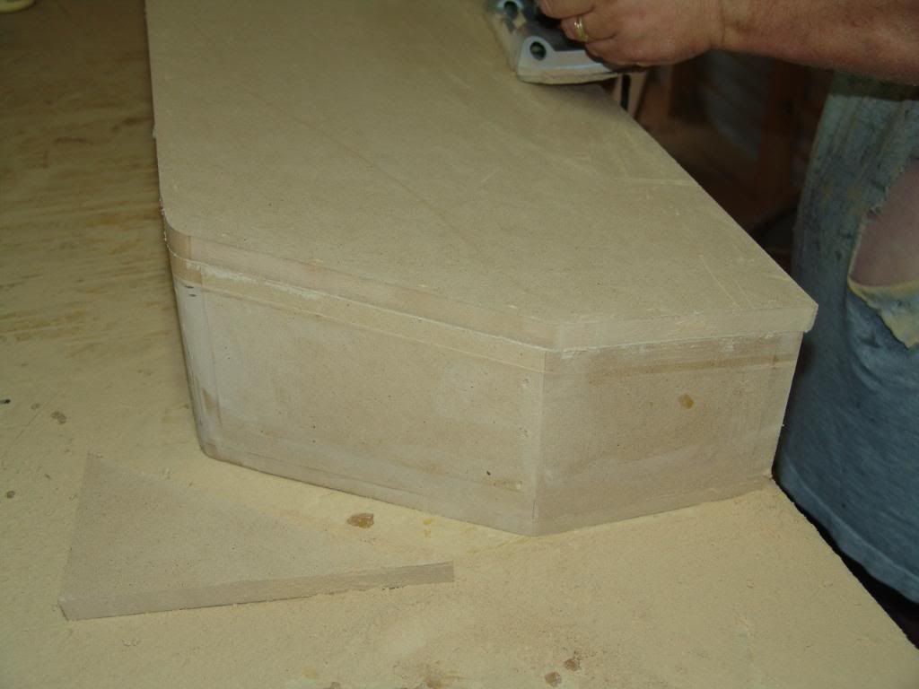

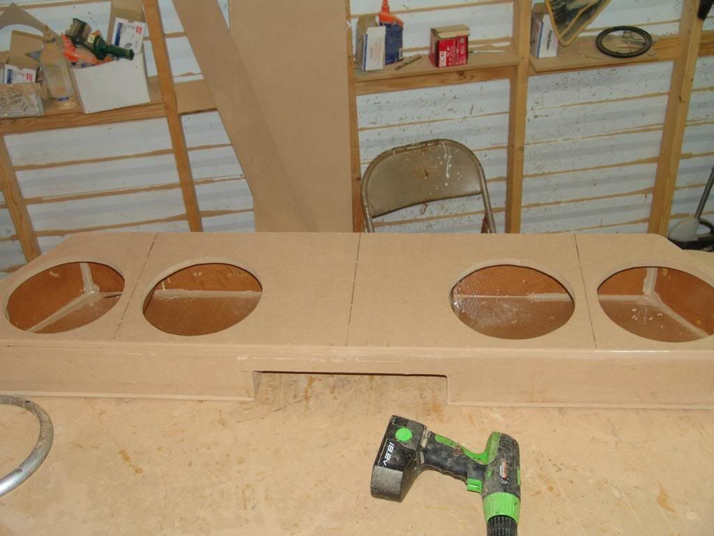

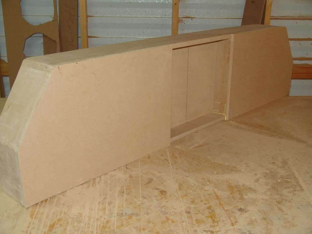

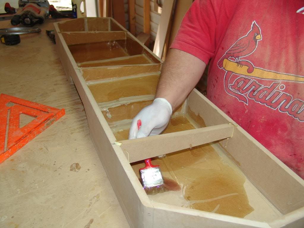

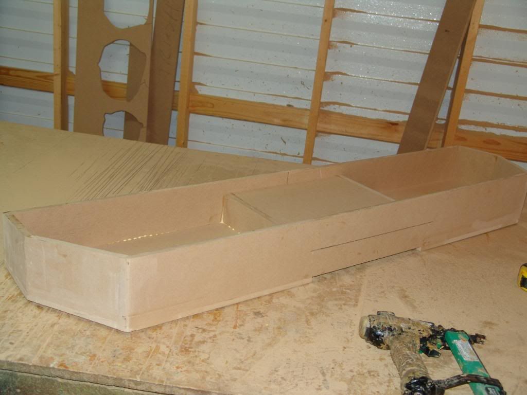

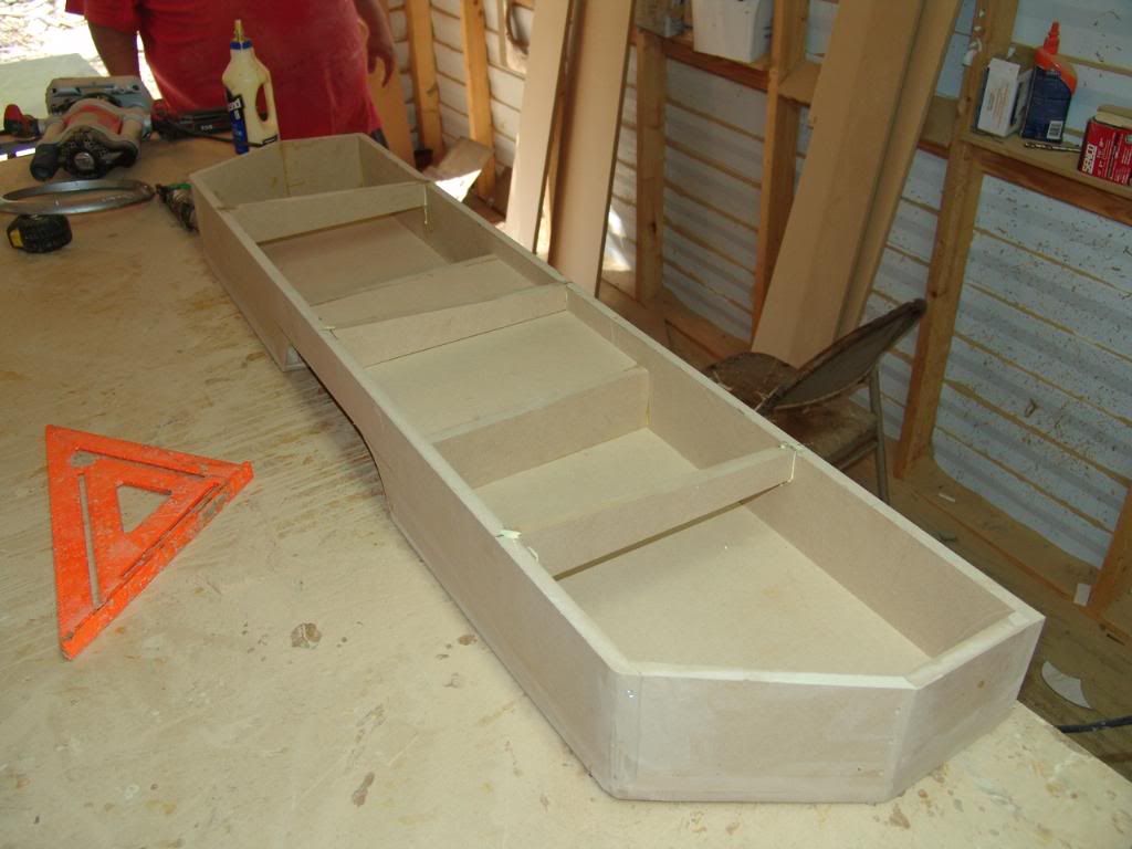

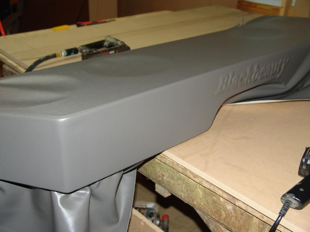

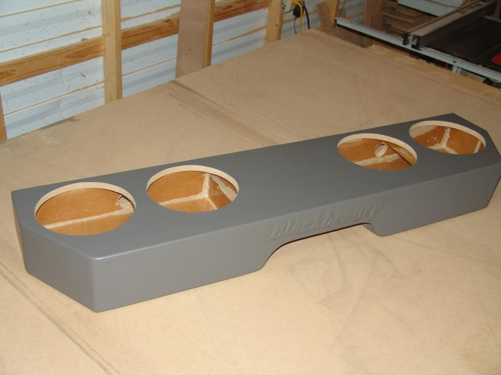

With the truck's interior all back together, it was time to head back into the wood shop and fab up the custom Blackbeauty Sub Box. The box was built, resined, sealed, sanded, and perfect before any vinyl was wrapped.

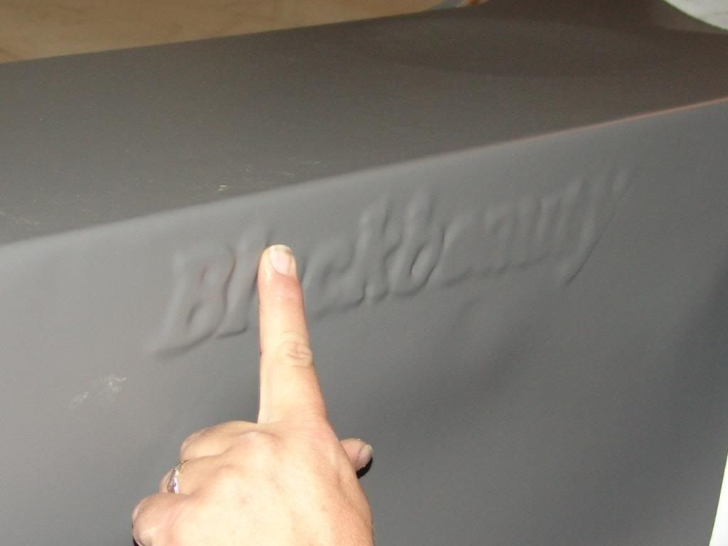

The raised letters were added and the vinyl was stretched on it to cover all visible surfaces.

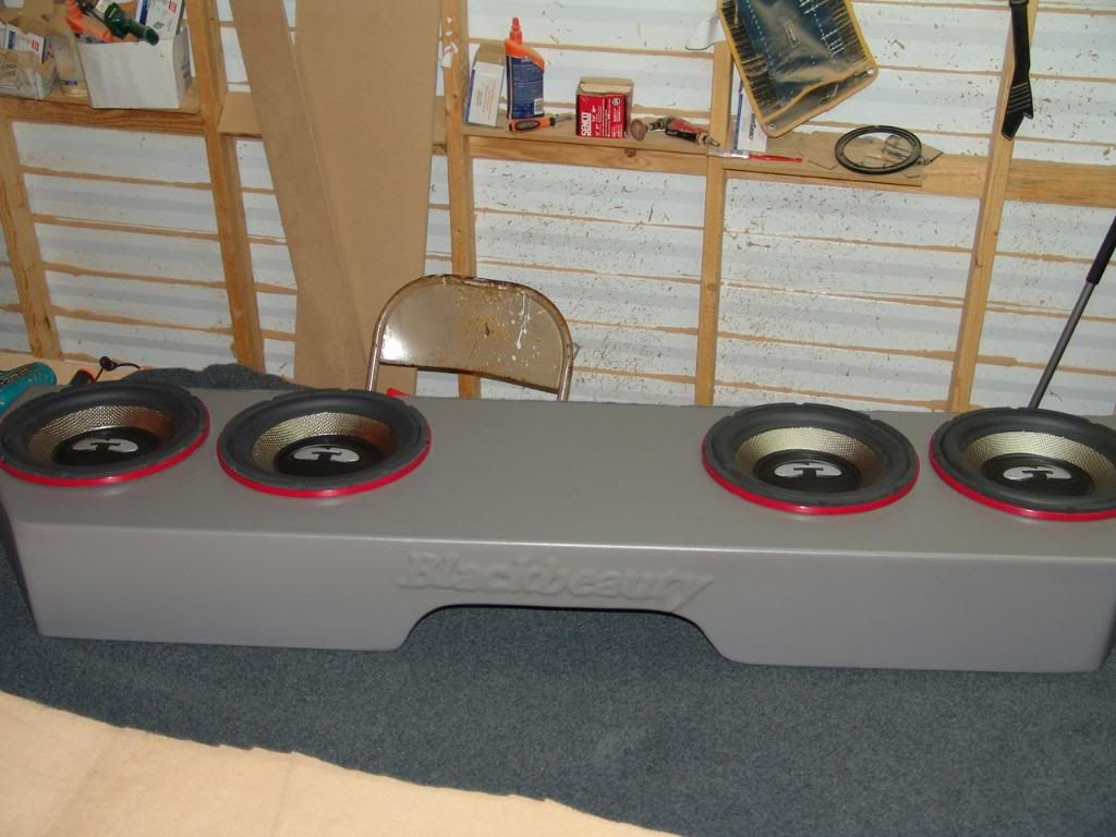

The (4) CDT EF-100 10" Subs were then fitted and the box was set under the seat in the truck.
After testing, the box was filled with polyfill to tighten up the bass even more than it already was. This thing sounds incredible. It can hit at all volume levels and the sound in the cabin is exceptional. You literally cannot tell where each aspect of the music is coming from. It all sounds like it is right in front and all around you. A better sounding system, I can't imagine. You really have to hear this to believe it!

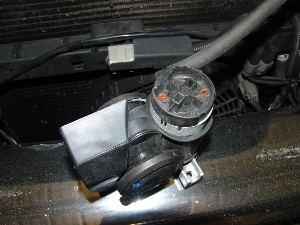

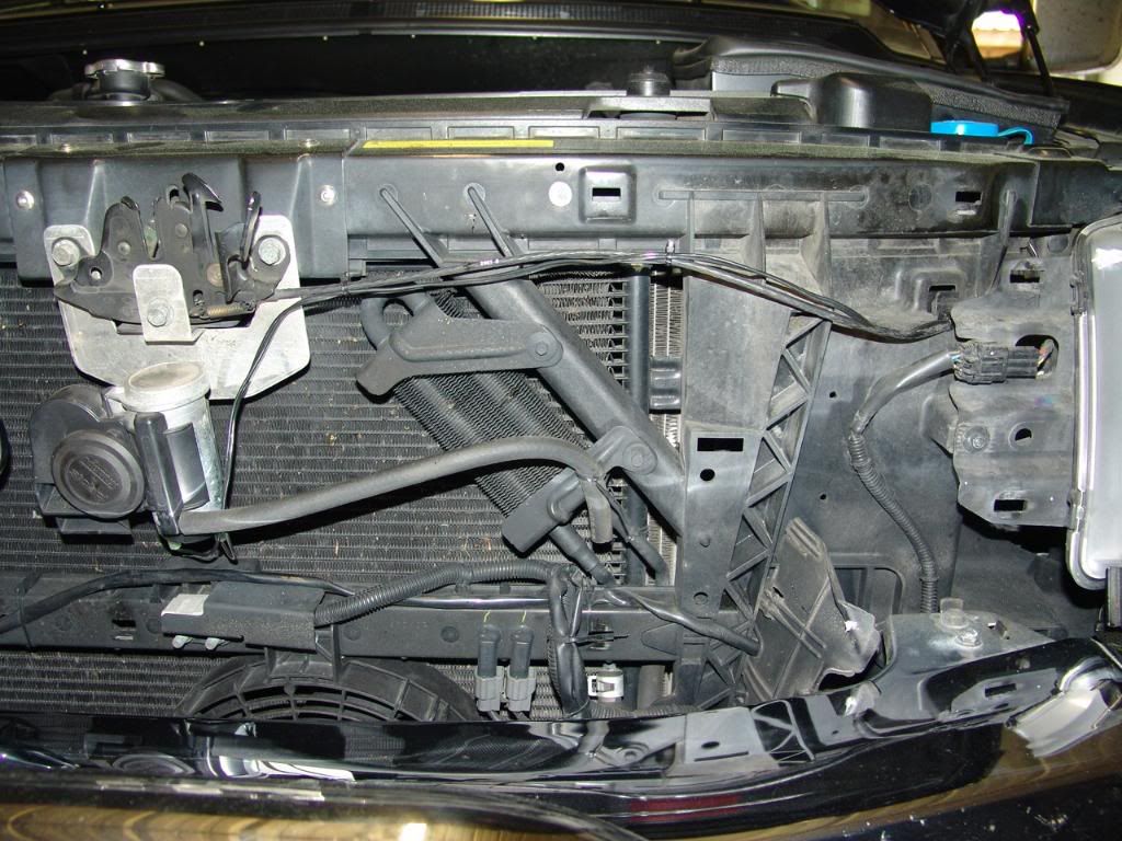

In addition, the Stebel Air Horn got put on a toggle so it can be turned off for state inspection.

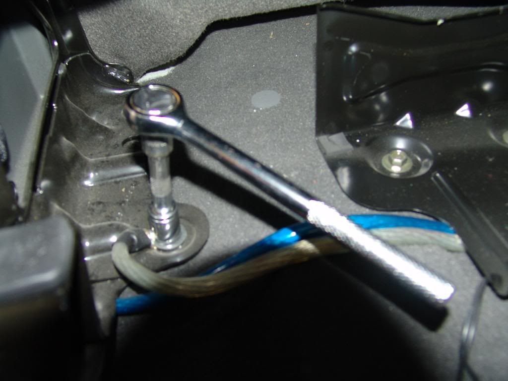

Also, to help the system and the electronics out a bit... I installed the Active Tune Grounding Kit.
