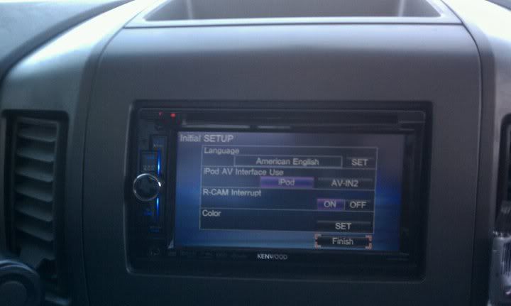

Well its about time.... I have had my Pioneer AVIC-N2 in the Truck since I bought it in '04. So I bought a Kenwood DDX516, yeah I know its last years model but for some resaon kenwood doesn't have sat radio on the double dins unless you get one with Nav. Well this all turned in to me thinking its time to change everything. I am putting a set of Memphis MC 8's in the doors along with a set of Memphis MC 5 1/4 coaxils. A set of Memphis tweeters are going in the dash. All this is going to be run off the 4 ch. of my Memphis bell, the 5th ch of the bell is going to run a set of Memphis MR 10's under the front seats. Then for the back I went with a Memphis MC1000.1 amp to run the Mepmphis C3 12. Yeah a new CD player turned into a whole new system lol. Here are some pictures of the start of the install.
